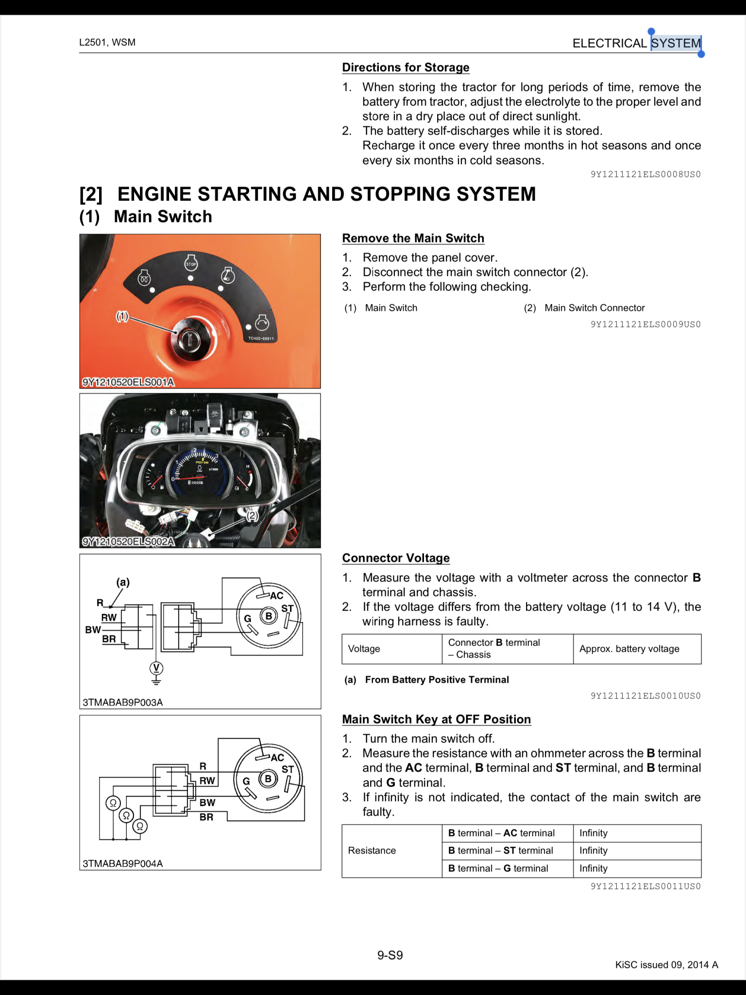

Download the workshop manual for the L2501 from kubotabooks.com. Work through the procedure which starts on page 9-S9. (I assume there is a circuit diagram in there somewhere too)

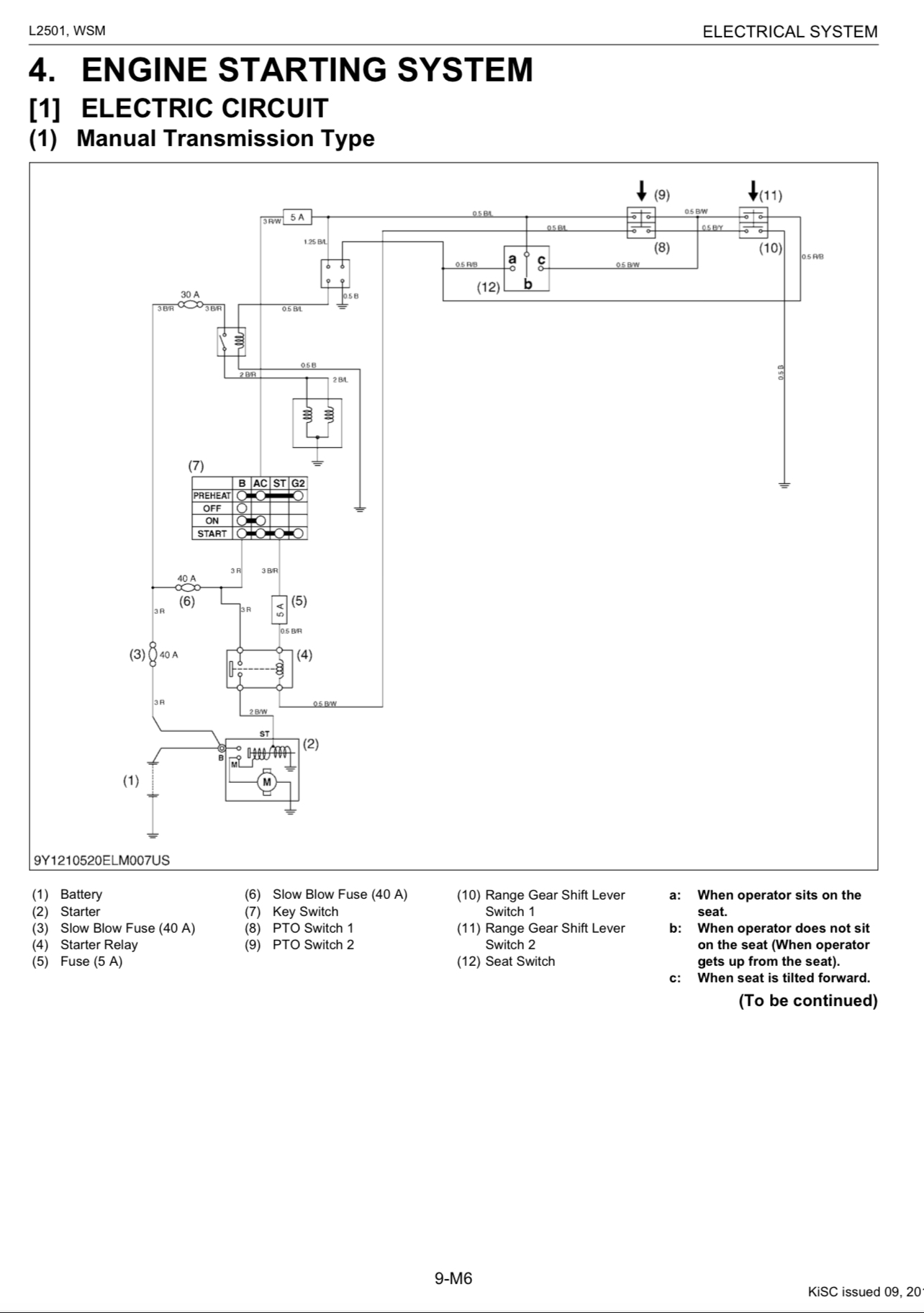

Ok, I have 12v to the ignition switch. The ignition switch meters good. My question is: there are 2 PTO safety switches. Do they work in series? Without taking the out of the case, 1 reads open and 1 reads closed. Is this correct? I can find little information from Kubota on how this system is supposed to work.
Dunno your tractor, but according to that diagram, they ARE in series, and they provide ground to the starting relay. Quick test:
Find that starter relay and jump the ground terminal. (Use your meter to make sure it's getting 12v to the coil.)
Try to start. If the switches are your problem, the tractor should start.
