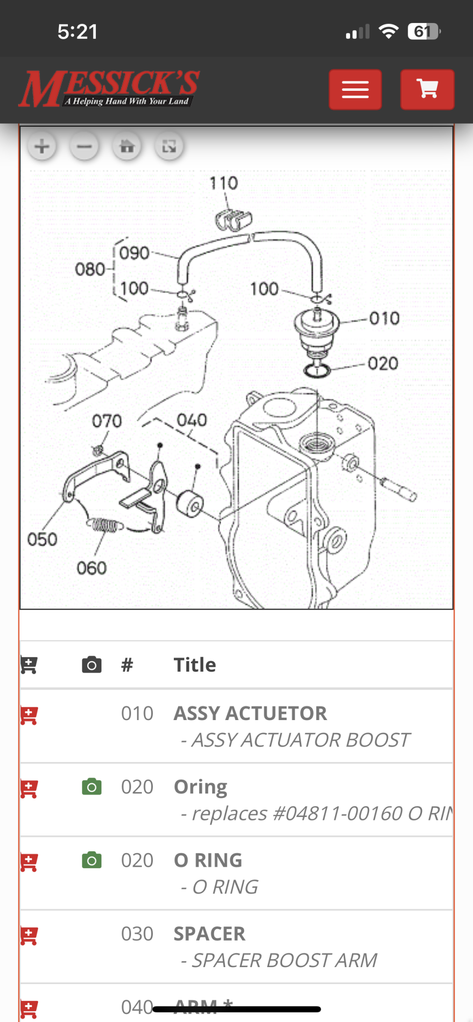

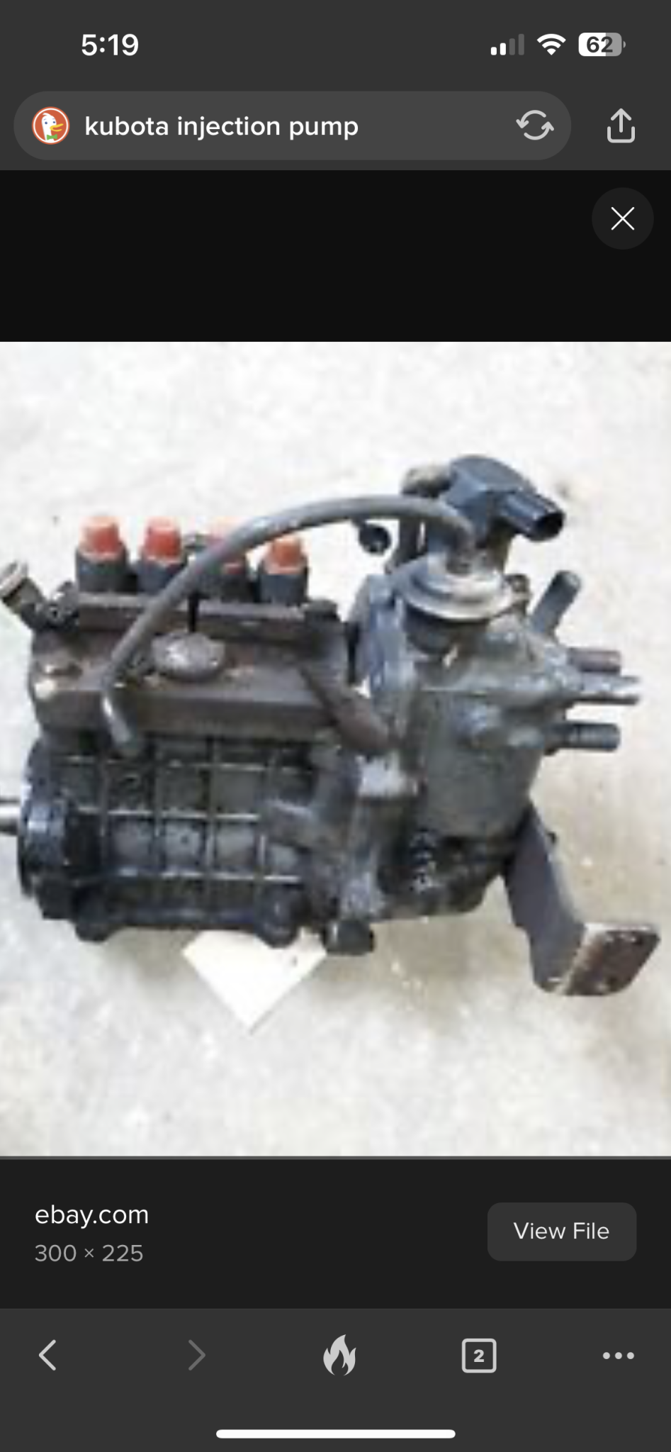

Have you ever thought of adding a pressure compensated fuel adjuster? In a sense you get the best of both worlds. The valve allows the fuel rack to be at a lower setting when not producing boost. Then when the sense line registers boost it brings up the fuel setting. Just a little suggestion to keep the fuel usage more reasonable. I like your work! Watch out for the constabulary if you know what mean.
7C41B420-0618-4F72-8202-042D01E0C185.png EB629D06-CB79-43D0-AF52-34B61B5FC60C.png

Thanks for the suggestion. We’ll have to look into it and see if it is something that can be adapted to this application.
The biggest issue with the rack adjustment is that if you call for too much fuel, you’ll have runaway EGT’s. The only way to fix that, is to reduce fuel or apply more boost pressure.
