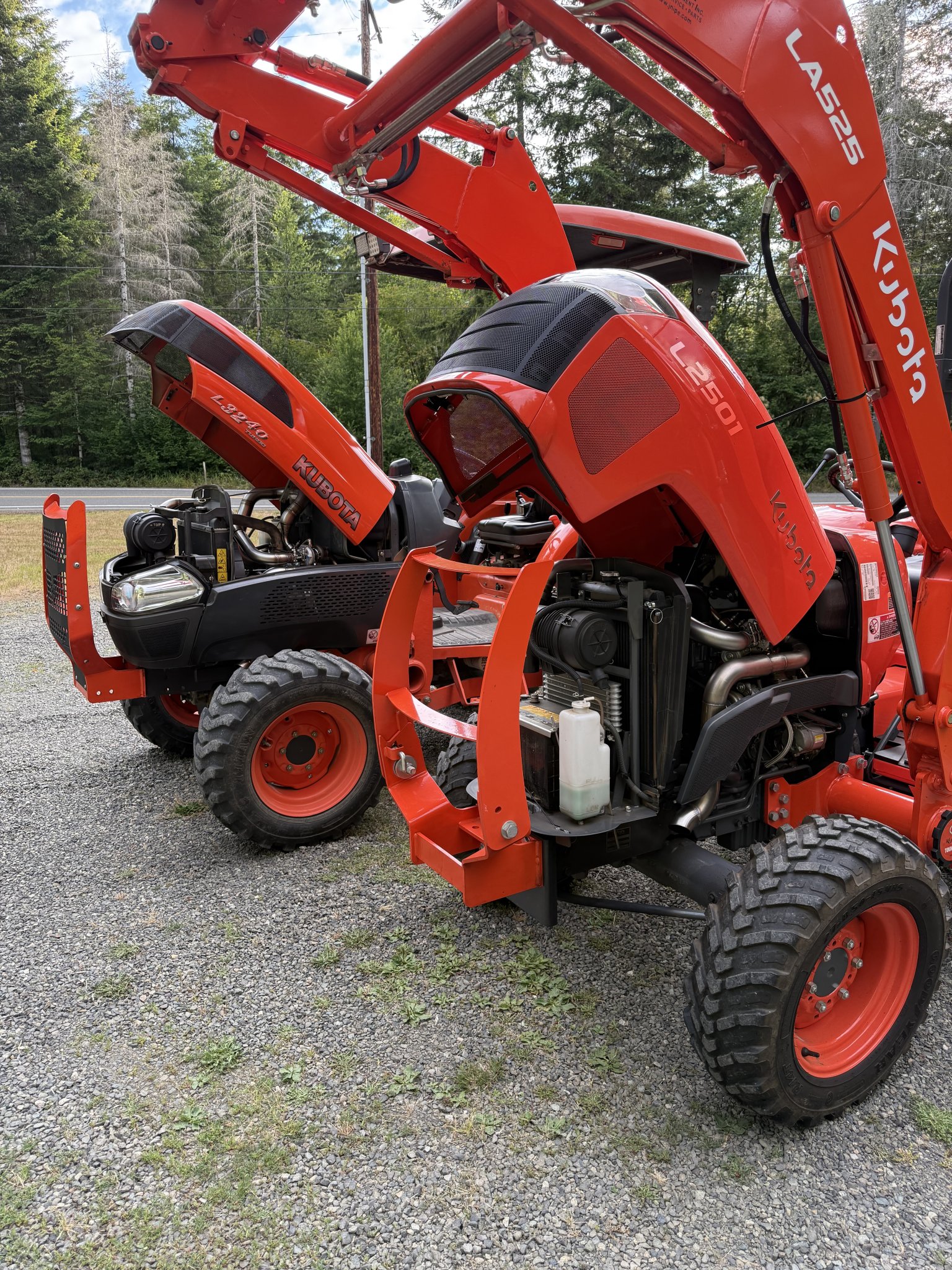

The Kubota L3240.
Mike
Rdrcr
Vendor Member
May 7, 2021
744
904
WA
Turbo brothers :D

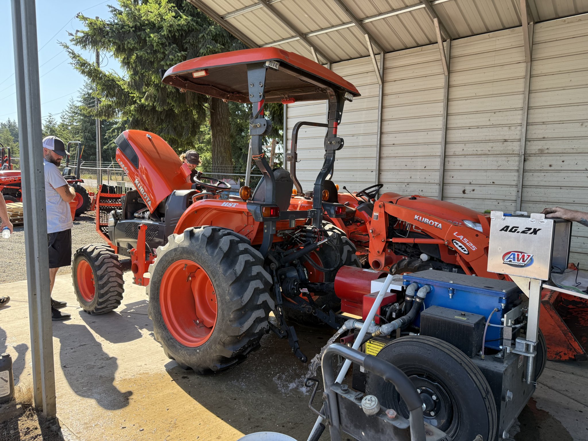

We had a successful day at the dyno with the L3240. The L3240 Turbo was able to match my L2501’s 44 HP / 35 PTO HP.
However, the owner of the tractor wanted to keep EGT’s well below 1,100 degrees and settled on a fuel setting of 1 1/2 turns which produced 33 PTO HP.
It was great to see how small incremental adjustments in the fuel settings affected performance while on the dyno.
Overall, the L3240 and Turbo Kit performed flawlessly and provided incredibly consistent performance throughout the testing and dyno session. We’re very pleased with the results and the customer is extremely happy!
