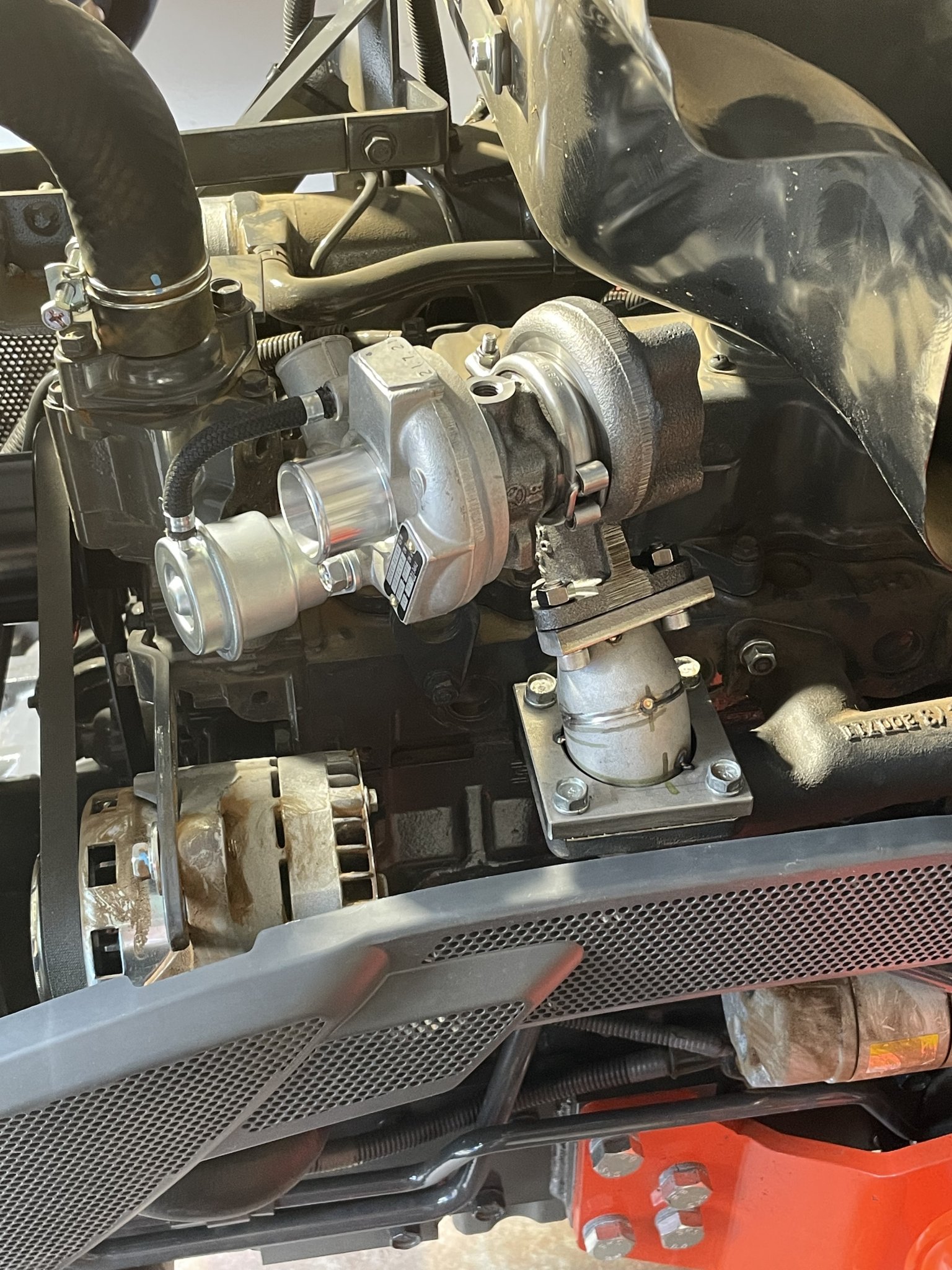

It’s been a little difficult recently to make time for the work but, I’m slowly making progress;
Can’t wait to get the rest of the tubing fabricated and get this turbo spinning!

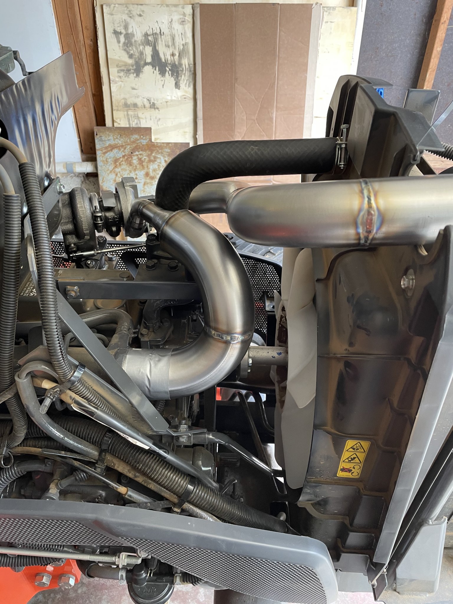

I’m looking forward to getting this turbo setup completed and gathering data soon.

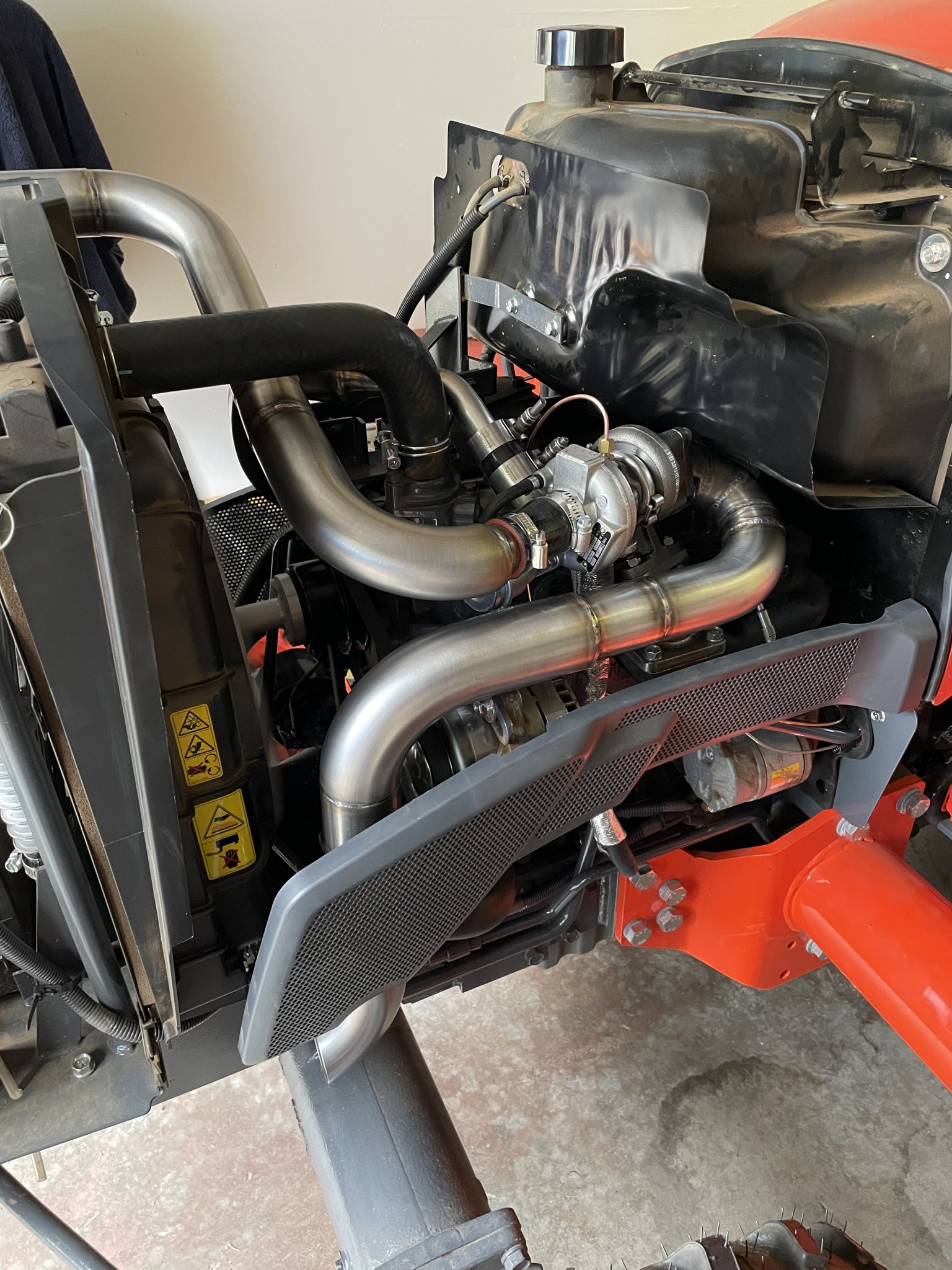

Here’s a couple progress pics;
We’ll have the charge pipe finished tomorrow and begin work on the down-pipe. I’ll check back with some additional pics tomorrow.

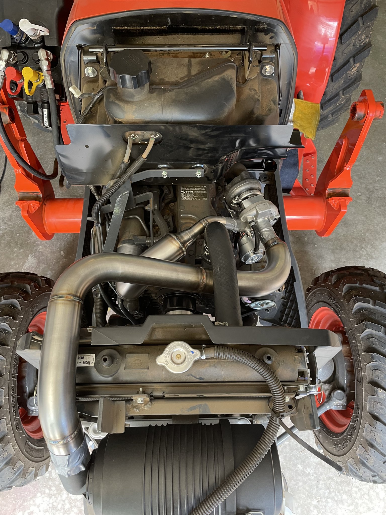

Charge pipe is finished;
I’m expecting the silicone couplers and hose clamps to arrive tomorrow so we can remove the duct tape, lol
We’ve been making the pipe transitions by hand and they’ve been taking way more time than expected. So, if if we make anymore, we’ll go with pre-made transitions to save time. Plus, they’ll look better too.
We’re working on the down pipe now.

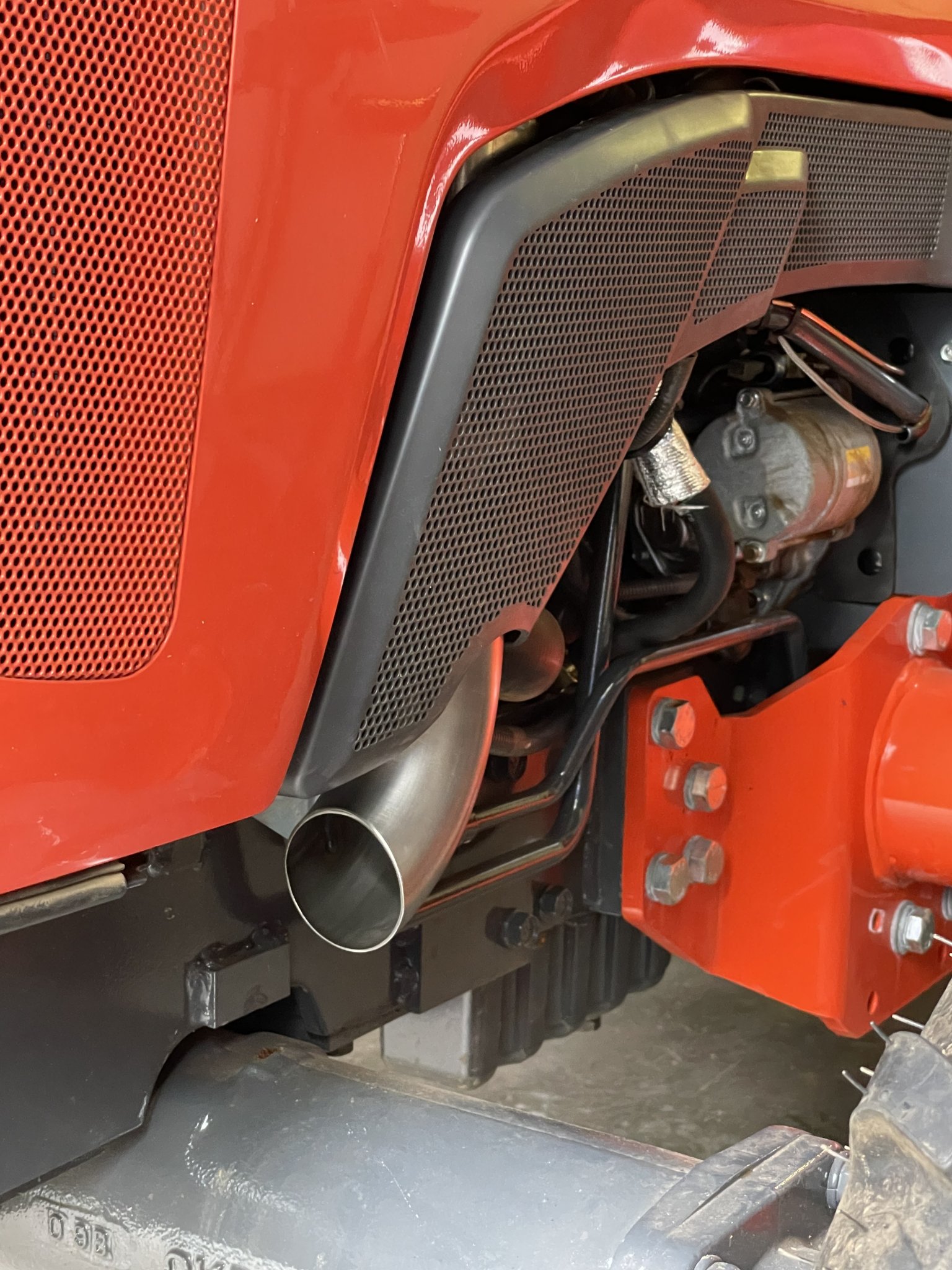

Getting closer;
The Down pipe is almost done. We just have to fabricate a small bracket and then tackle the oil feed and drain lines.
I’m expecting to have this thing fired up in the next couple days.

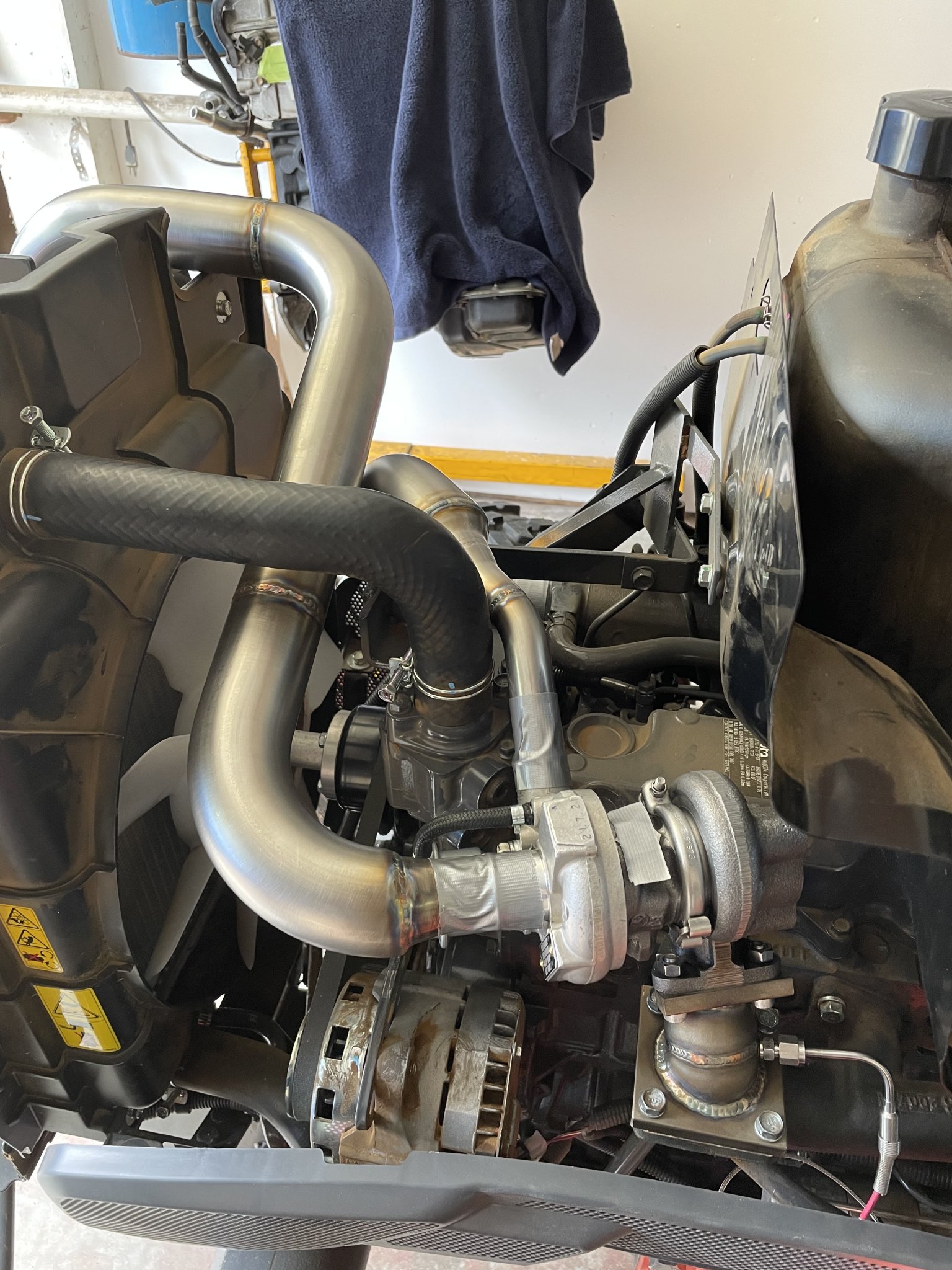

The Turbo setup is completed and running;
We made one rookie mistake on the intake charge pipe, we didn’t account for the hood prop-rod/absorber. So, we’ll have to redesign that pipe in the near future. Shouldn’t be a big issue.
I’ll have the tractor back on the property tomorrow and should have some time to run it around on Sunday. I’ll start making adjustments to fuel next week.
