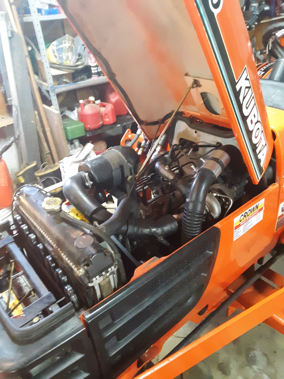

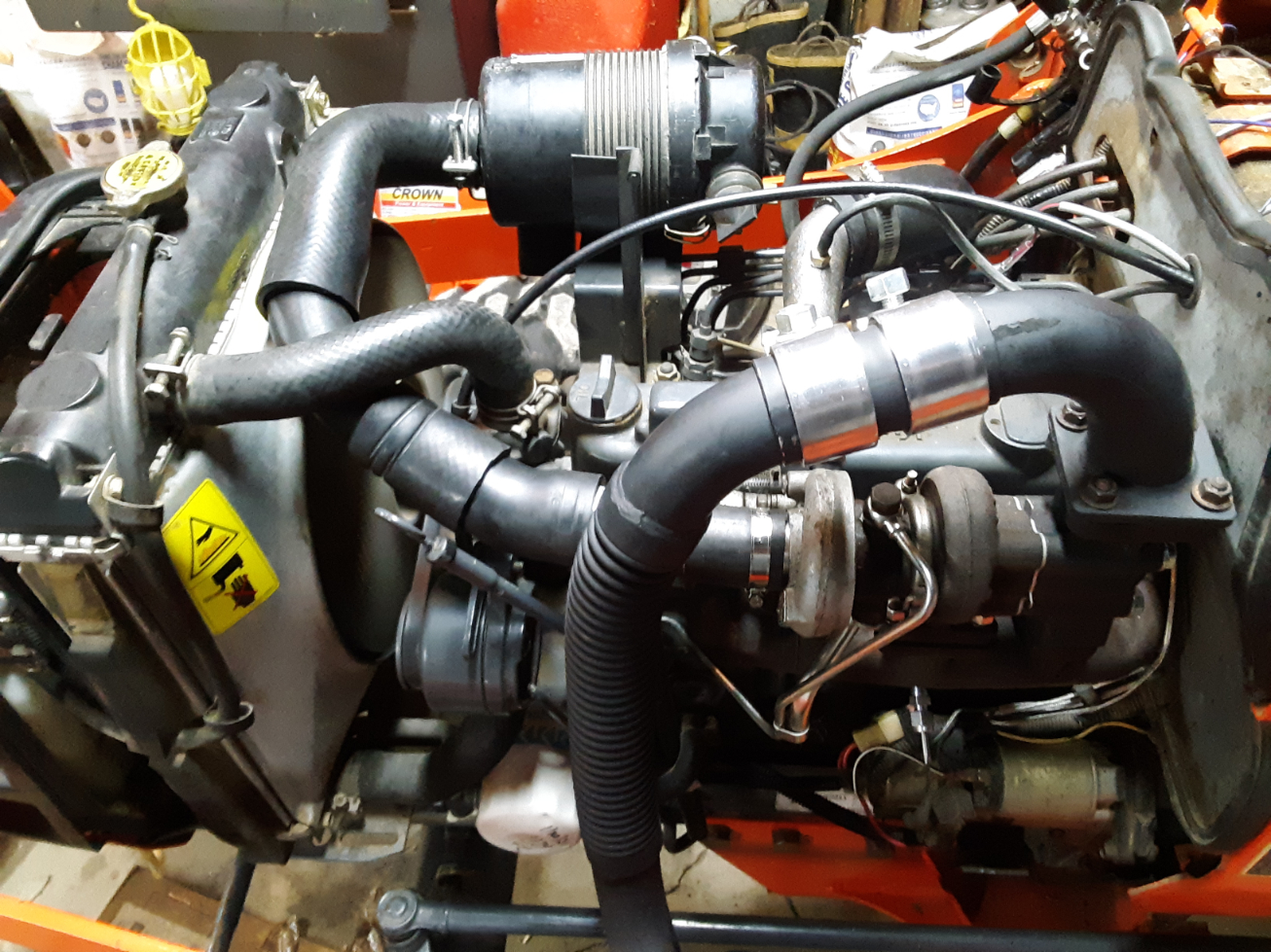

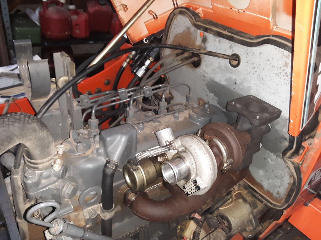

Not a 2501 but I turbo'd my b2910 over the winter of 2020. It has about 100 hours with the turbo without any issues. Hat tip to Greenacresnorth who provided some guidance along the way while I was building and tuning.
I found a junked out Jacobs golf course mower with a 1505T and snagged most of the parts off it. I used fresh kubota parts where possible for some missing pieces. Swapped over the exhaust mani, intake mani, injector lines, compressor outlet pipes. Pulled a shim to put timing at ~20. I used a slightly modified Bobcat turbine outlet and exhaust pipe and made up my own intake. No welding was required this was 100% bolt on affair.
I have it fueled conservatively to get about 7-9 psi boost. EGT gauge is definitely a must have when tuning. I keep it under 1100* at all times. It really doesn't kick in that often, only if you are really pushing into a pile or going uphill fast. It's fun with a 6 foot finish mower it will plow through 3ft grass like butter. Healthy stock cooling system has no problem with it.
I may send the turbo out this winter to see if they can improve on it for power. The turbo is a TD 025 mhi. Tiny thing.
Let's see some more boosted kubota's around here.

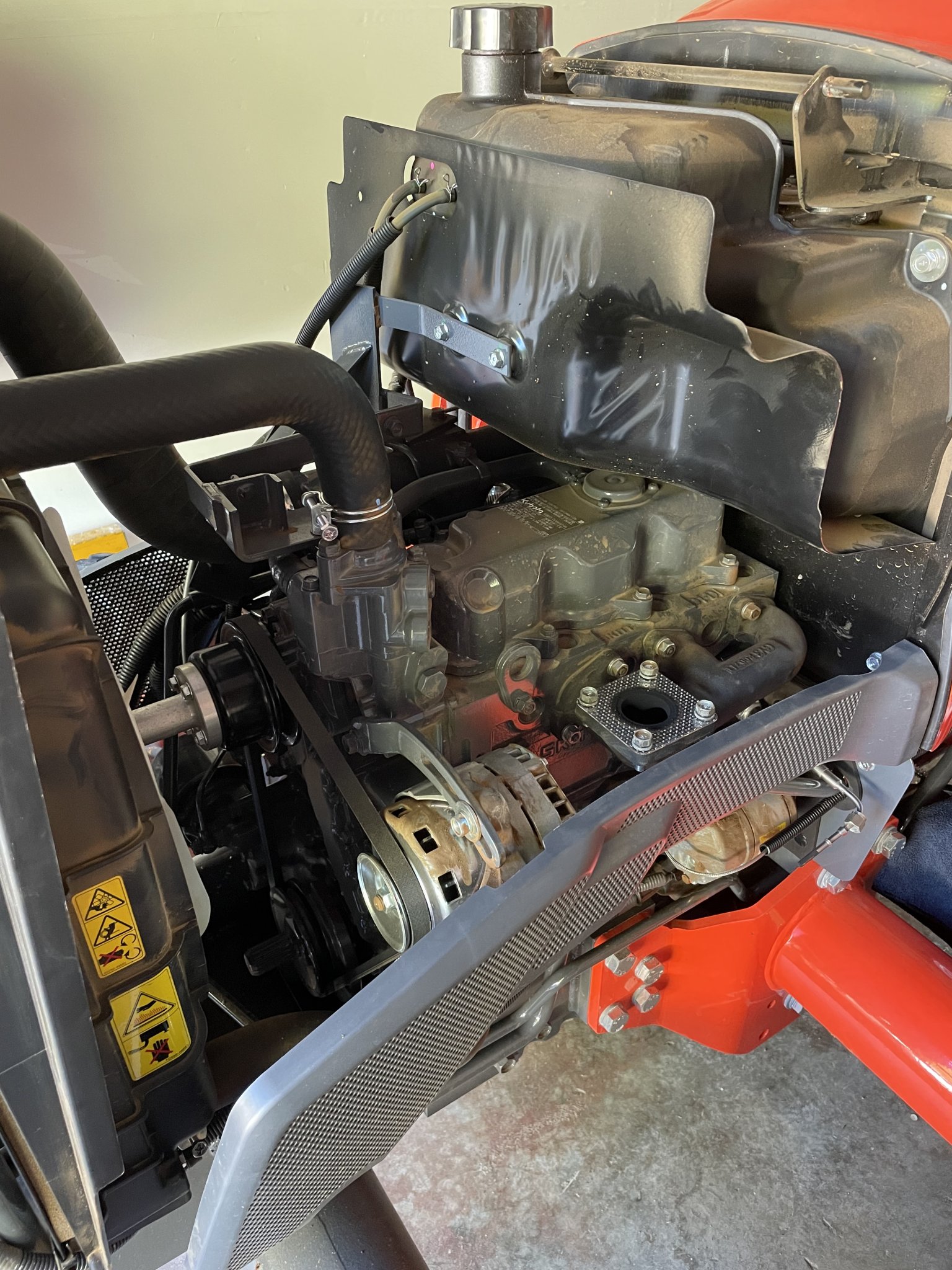

Finally…the Turbo installation has begun! Right now, I’ve only removed the loader, hood and exhaust but, the fabrication will begin tomorrow. I already have most of the materials I’ll need however, as with any project, I know there will be some fittings, clamps, hoses and additional miscellaneous parts needed before it’s done. Regardless, it feels great to get things moving.
Mike

look'n good mike! 👊 🍿
