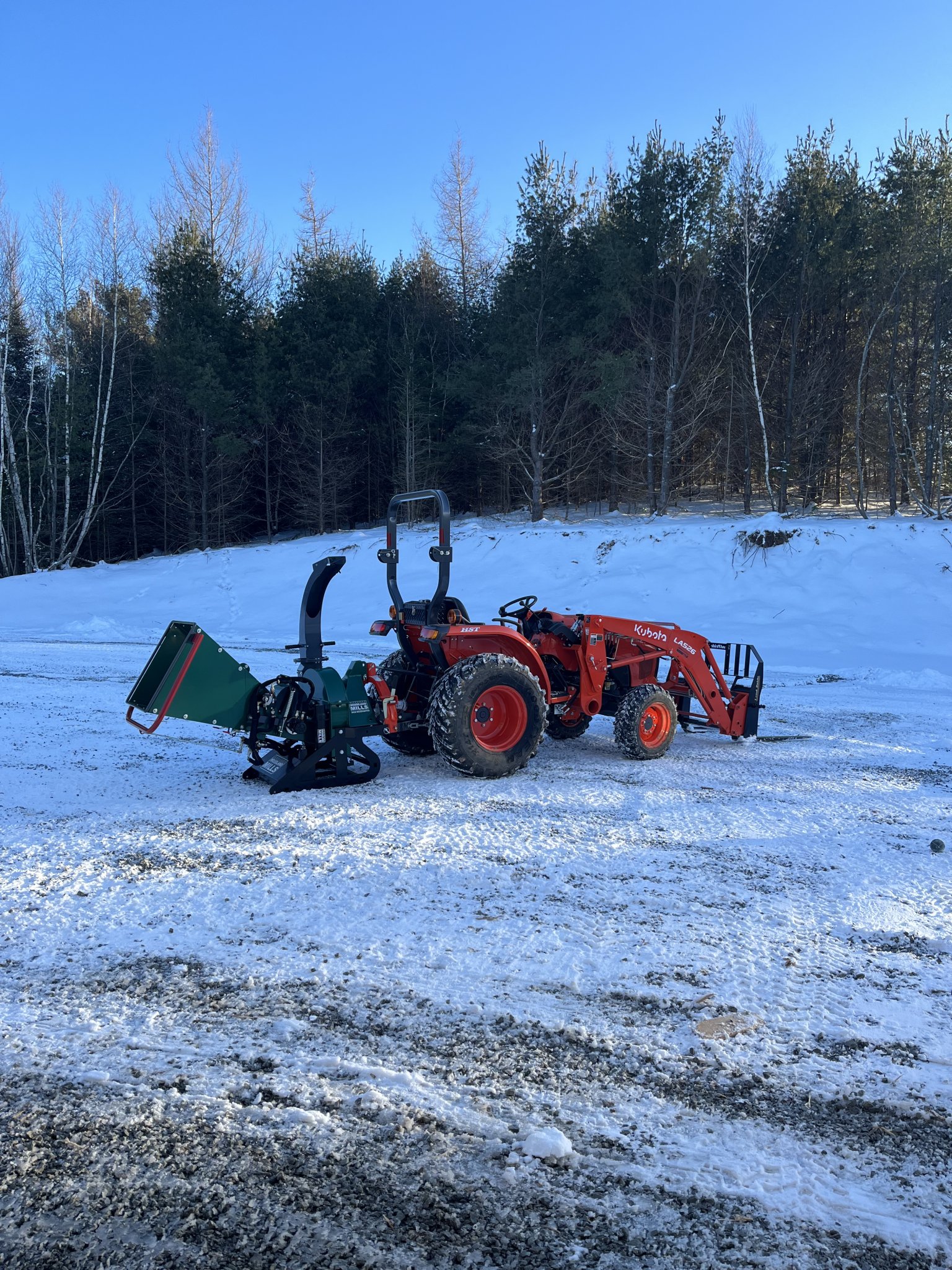

My WC68 arrived and had a chance to put a few hours on it. Glad I went with the bigger chipper. Tractor handles it great and with a little tweaking of the infeed speed and the infeed roller spring tension it is working great.
