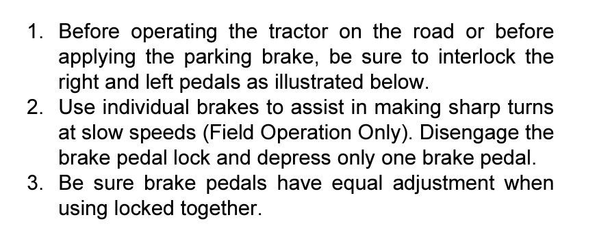

Need steering brakes when moving snow, even on flat areas. Also occasionally need steering brakes when pushing large objects that won't go into the FEL but with the FEL.
That’s interesting, but the manual states to use them for field operation only.

That’s interesting, but the manual states to use them for field operation only. View attachment 82398
What do you think field operations are? Pushing snow is a "field operation".
The manual is referring to the difference between high speed operations or roading the tractor vs. braking to steer a tractor at a low speed.
Field operation as in working in a “field”. By your definition, everything is field operation which would mean the term didn’t need to be added to their text.
The dictionary defines field as
an area of open land, especially one planted with crops or pasture, typically bounded by hedges or fences. "a wheat field"”
Yes, the manual also refers to roading the tractor which is including in text I included.
Fwiw, I’m not the operations police, but seems reasonable to point out what the manual says.
