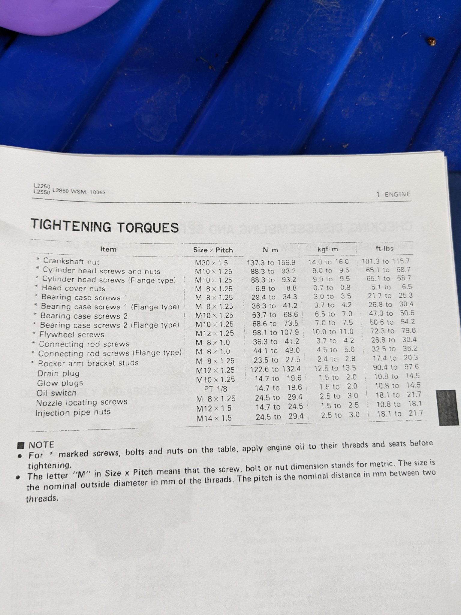

Well I finally got some time to work on the tractor. I drained the oil and changed it and the filter. I saw in the WSM that the torque spec for the drain plug is 90 foot pounds is that correct? Or are they talking abou a different plug?

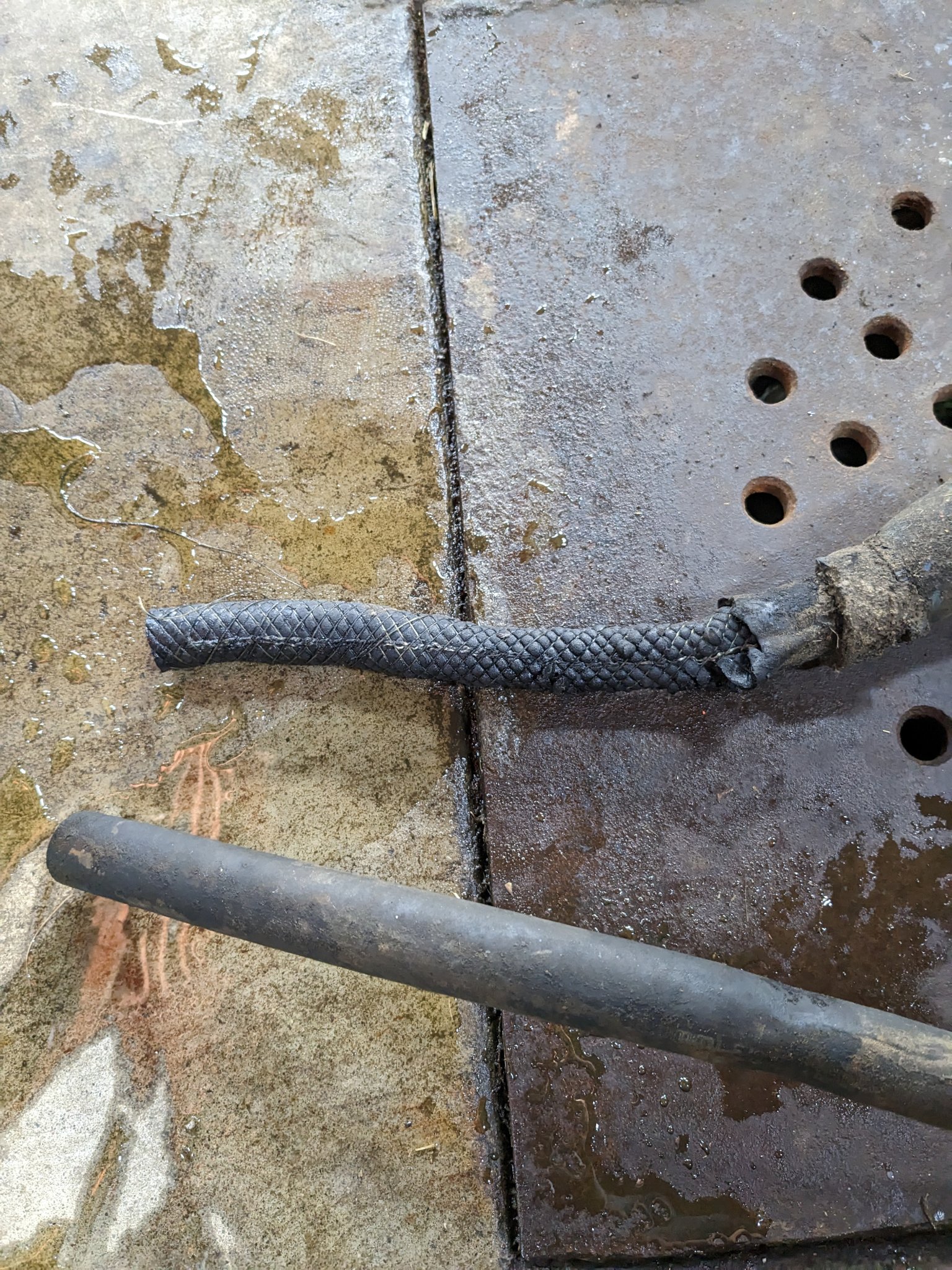

I drained all the coolant and cut out the cab heater hoses and put a bypass hose I got from the dealer in place . I can just use regular 50/50 green anti freeze correct?

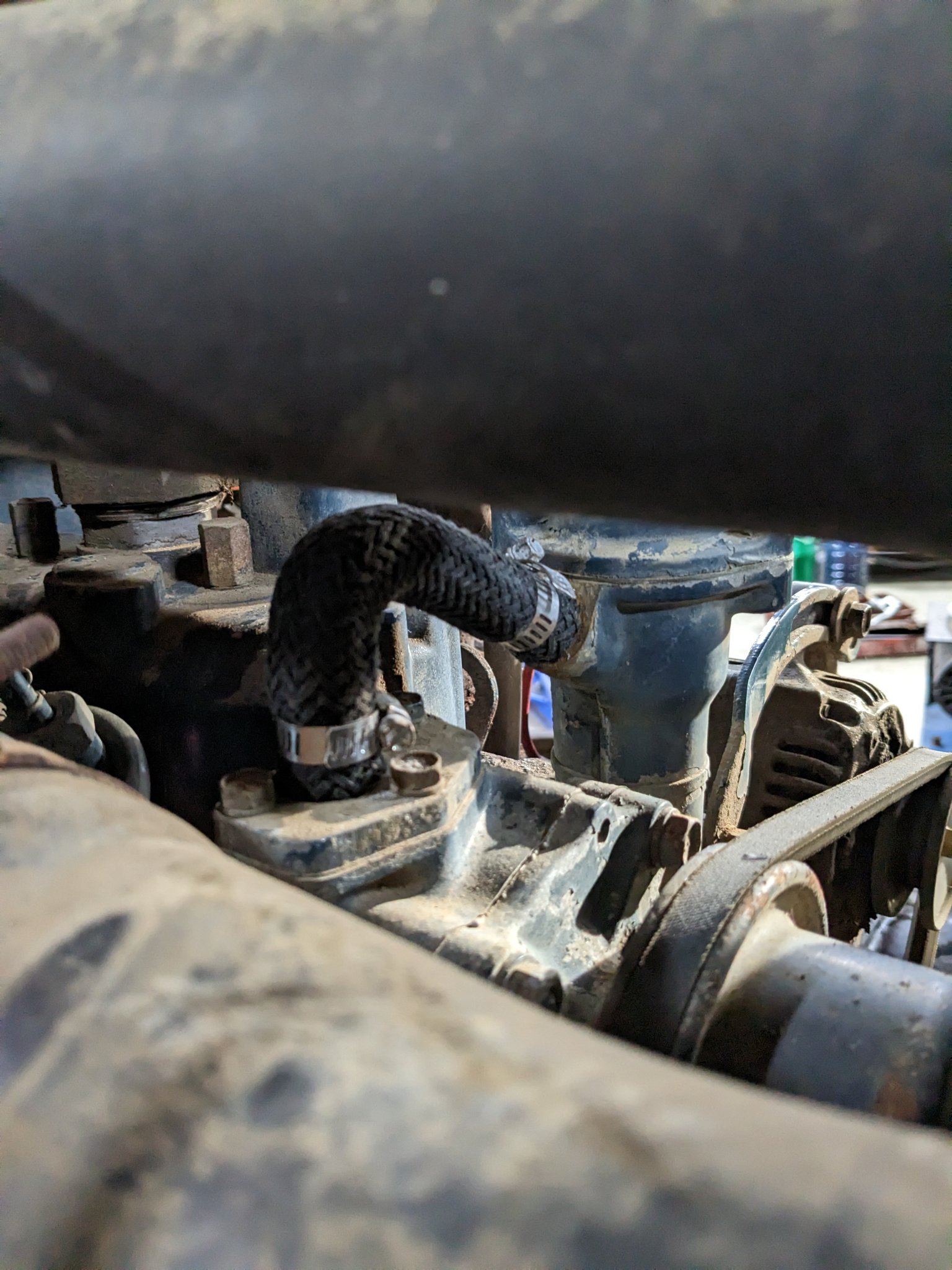

I posted some pictures. The hoses were the ones from the cab heater and look to be the culprit of the coolant leak. I wasn't able to find a adapter for my stant pressure tester so wasnt able to test the radiator

More likely inlbs. 90 inlbs = 7-8 ftlbs
9,541
5,998
This is the page right out of the WSM. Not sure if it's a typo or not
Geez -, I just do “snug.” No way I’d do 90 ft. lbs.
Likely a steel oil pan, but that seems really tight to me.
