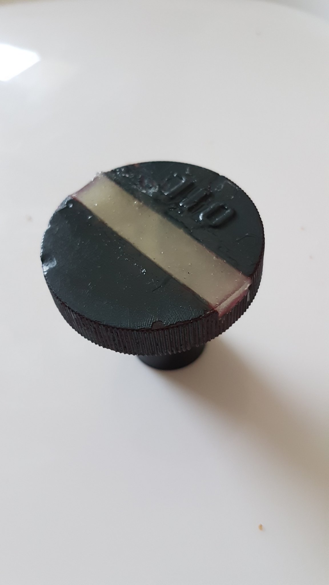

After draining and flushing the transmission case, bleeding the hydraulics and adjusting limit stops and pressures, it's better than it was when I got it. Turns out that, apart from a knackered pump, the oil had water in it. The main culprit was the vented filler cap in the top of the transmission housing (The big one between the drivers feet).
The cap is supposed to have a rib along the centre to unscrew it with, but it's broken off on the one I have. What remained was a rectangular trough that turned out to be very efficient at catching rainwater and dumping it into the transmission case. I filed the ends of the trough flat, glued some paper over the base of the trough to seal it (leaving the air channel clear) and filled the trough with epoxy.
