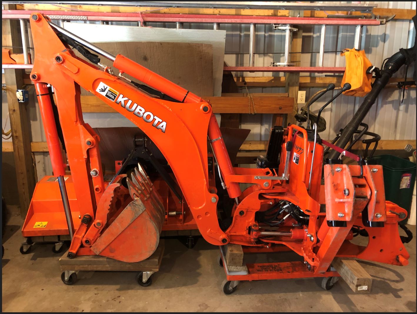

Like some others, I wouldn't have a tractor without a hoe. I dig with both a bh77 and a mini. Sure the mini (even the small KX033) will dig circles around a tractor mounted hoe any day of the week, but there are some jobs where the tractor mounted hoe is easier and doesn't leave near the mess of a mini.
Perhaps the OP can be a bit more descriptive in what the intent/need is? If you're planning on digging out 100 stumps with your tractor mounted hoe, good luck. But for some trenching, landscape and similar tasks, it'll do it for sure. Storage isn't a problem for me at all..

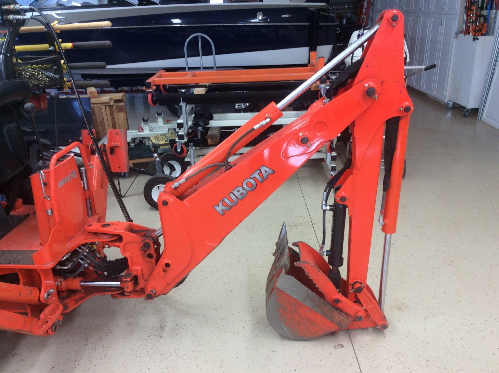

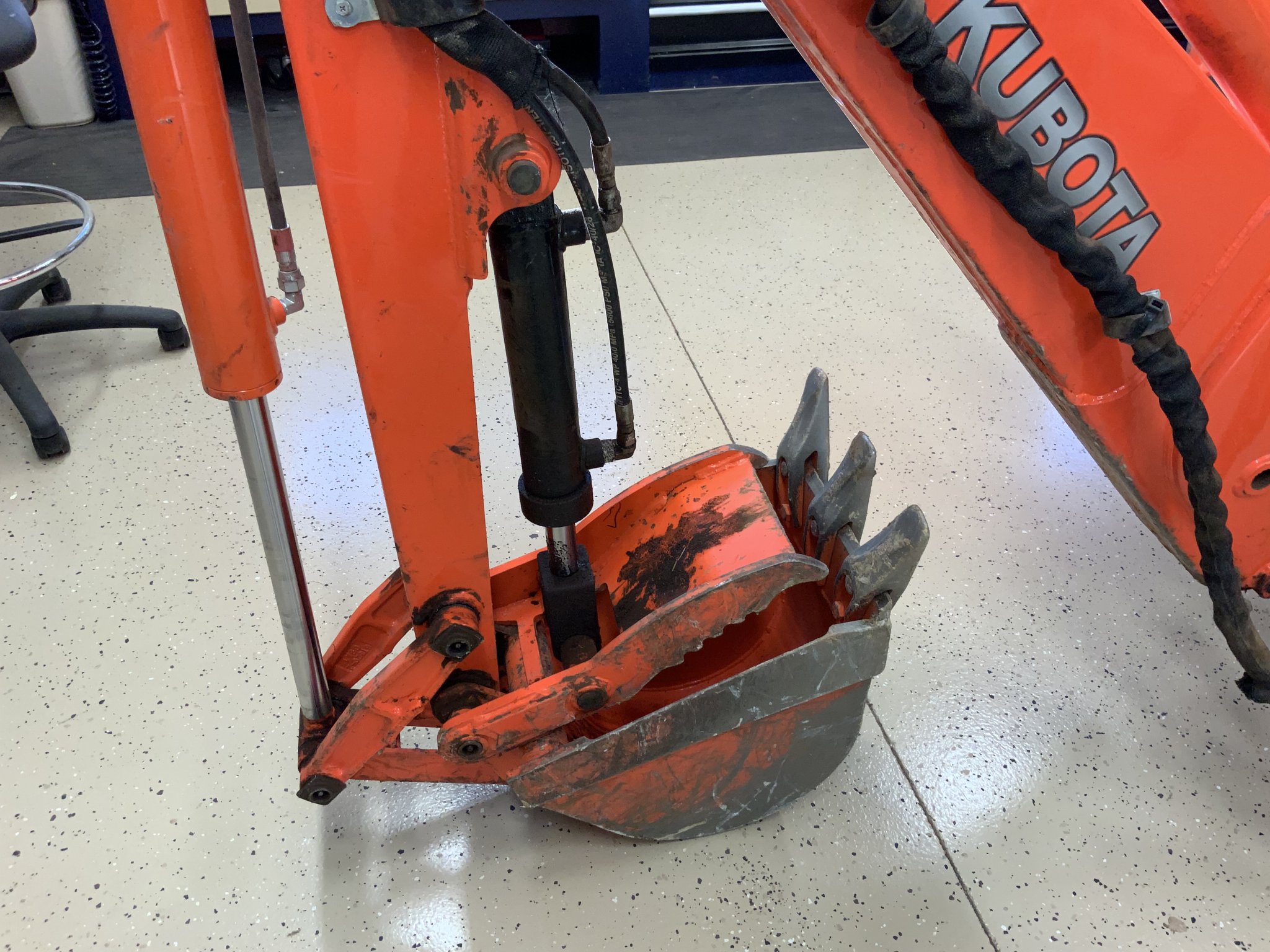

Yep…mine gets used ALOT! We are in volcanic Boulder country too….so the hydraulic thumb is the single best thing about it.

Yep…mine gets used ALOT! We are in volcanic Boulder country too….so the hydraulic thumb is the single best thing about it. View attachment 71588 View attachment 71589
Did you do your own hydraulics for the thumb ? I did mine on the BH77 late this summer. I haven't had time to use it too much but will when I cut my firewood this year. Between that and the grapple It should allow me to keep doing firewood a few more years with some arthritic shoulders I am hoping.
Shoulders thank me for the backhoe and I walk by the pick, shovel, and wheel barrow.

Yep…got tired really fast of hopping on and off the BH to adjust the manual thumb that I had ordered when I bought it. Took all of about a week of that crap…then used this site and lots of pics from other guys rigs to figure out what was needed. As I said…that thumb, for my situation, is the most used best part of my tractor.

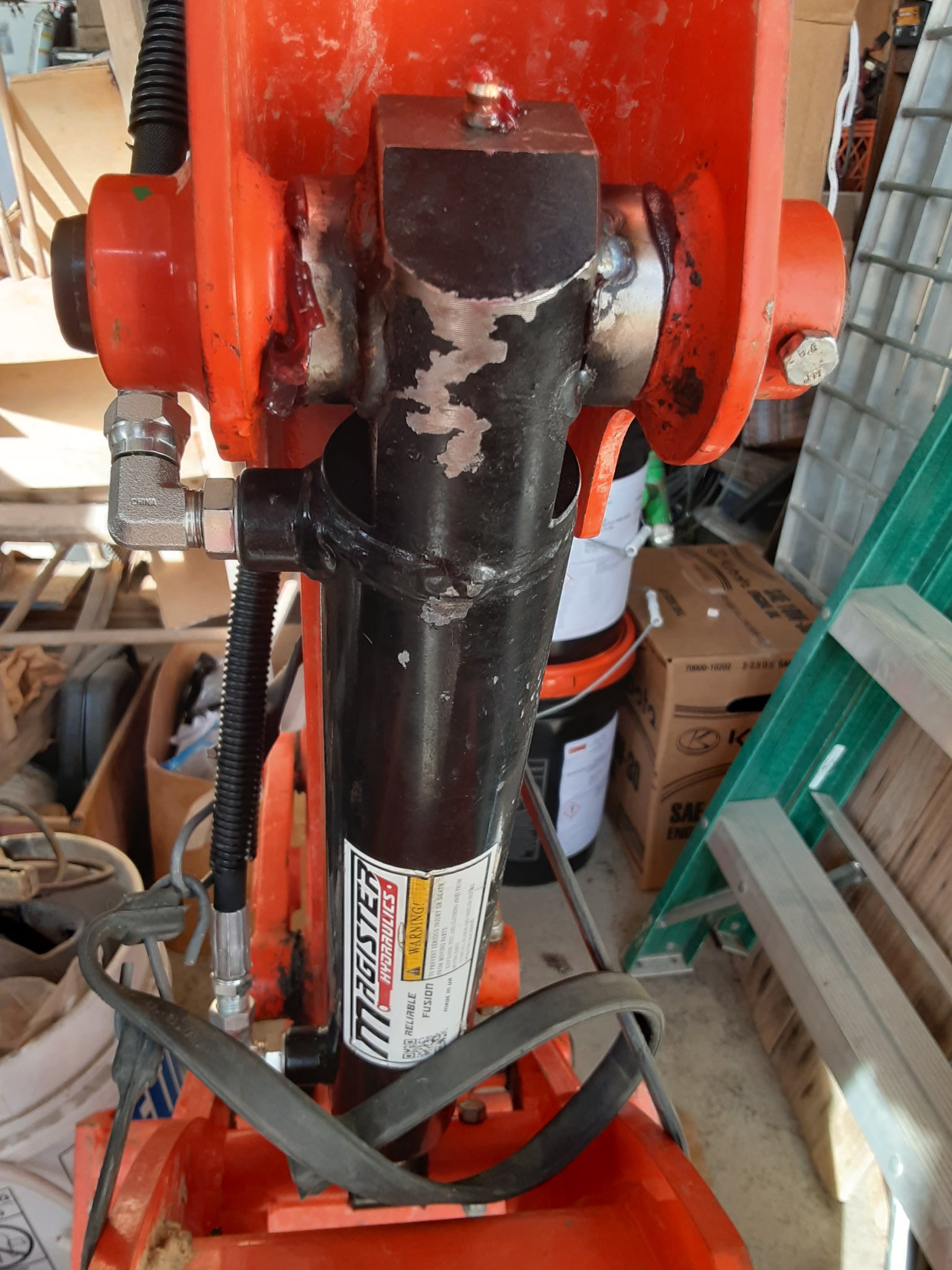

I found a ebay cylinder, Magister WTG 2X10 that worked good for dimension. The base end I plugged and then with it hooked to the thumb and tucked up tight I marked it for the hole which moved it about 7/16. Welded a 1" shaft collar to each side and milled a little off each side to center in bracket. BH77 is off the tractor right now so I can't get a good picture. It also has the connections clocked on the side. I paralleled my 3rd function with couplings front and back. I got a switch from surplus center PSN-020-M20 11-2201-20 ( I think). I paralleled that to the 3rd function switch so I could use this to control from the back. It has a magnet and I stick it to the rops, Handy there. Finally I installed a relief Prince RV H4 9-6135-50-H to the base side of the pressure at the 3rd function and teed the tank return at the FEL so the thumb can't be over powered and damaged by the BH77 bucket. 2, 1/4" x 180" hoses are how I hooked it up running them thru the backhoe with the others. I used ISO 5675 1/4" couples to connect.
Might be hijacking the thread, I apologize for that but wanted to share with other BH77 owners.
