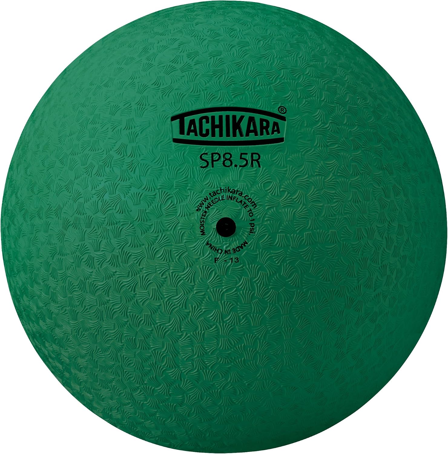

If those soda bottles don' t do the job you could try a partially inflated soccer or volley ball! Great idea, and cost effective. ;)
I picked up some tennis balls... They aren't large enough. As I was looking for a slightly larger, inflatable ball I walked past the bottles and figured "why not?" I am going to grab something like this for a more permanent solution. I believe this is a "gaga" ball.

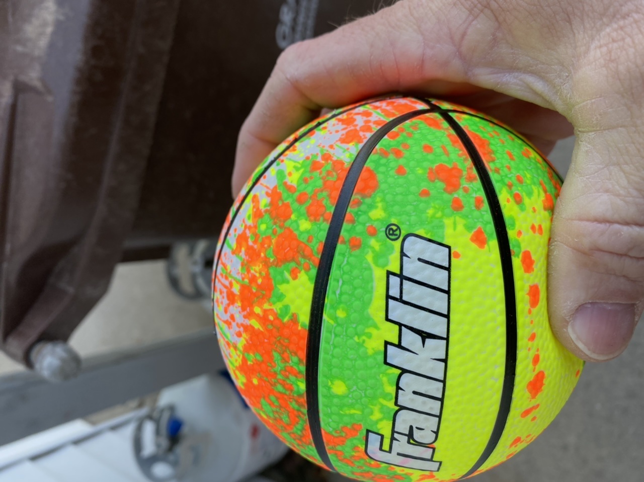

Sure... that’s about as far back as I could get them at their existing pressure. Which I did not adjust from the store.
They definitely made a difference. Seat only drops about an inch when I sit but there is still plenty of give in it to act as suspension. I couldn’t bottom it out at all.

Well, approx 3 hours on the tractor since cramming those balls in there and so far so good. The additional height is nice and my hips dont cramp up anymore. I can turn the seat with enough knee room to make the feature pleasant.

Thats a good idea. I may try that if the balls fail.
Ive probably got 15 hours on them so far and they are holding up fine.

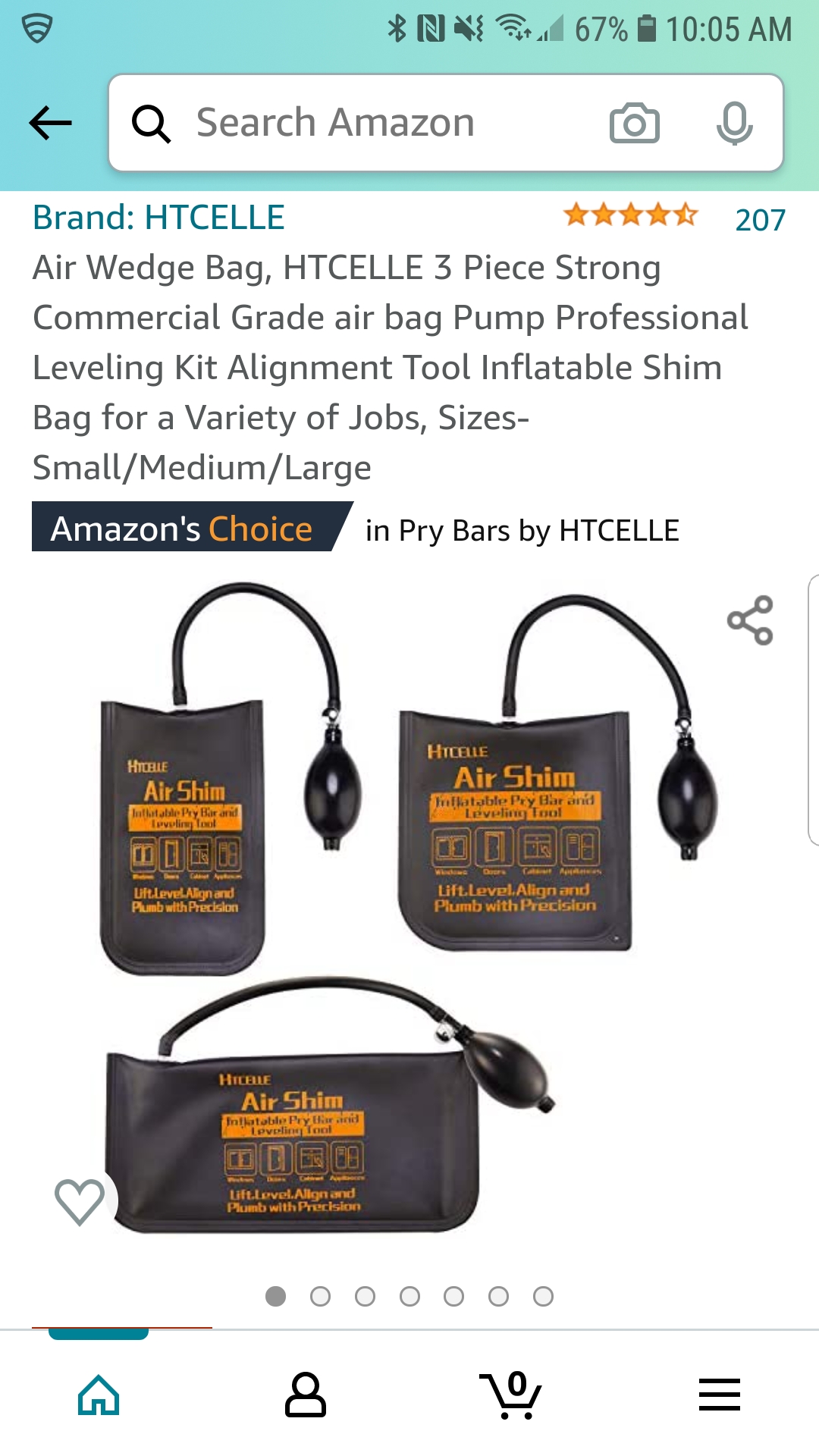

I'm going to try these and will let you know if they work or not....
Willbeone
L3560HSTC LE, LA555 loader, Scraper/grader, Woodchipper, Backhoe.
May 19, 2021
15
Oklahoma
I got these today and installed the largest one at the back of the seat behind the gas shock. I ran the filling bulb out the back to allow for adjusting if needed. First time since purchasing the tractor the seat didn't bottom out and maintained desirable ride height. Longevity of bag yet to be determined.

Where did you get those basket balls? Do you know what size they are? Also the black fasteners that hood the skirt up on the seat. what’s the best way to take those out?
I got them from Dicks Sporting Goods. Any sporting goods store would likely sell them. They are probably 4" in diameter.... Give or take.
IIRC, they just pop out. I cant remember if they are plastic rivets or just push pins.

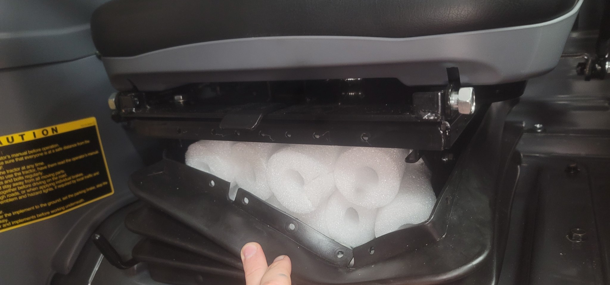

Refugee 03XX
Kubota L3560 HSTC
Jan 2, 2023
South Carolina
I just purchased a Kubota L3560 HSTC with delux cab and found myself on this board with the same seat issue, in taking the time to share here we go. Attached I provided my version of temporary solution in the form of what may have ended up as 3 pool noodles from dollar general made of foam stacked and tight as possible packed between the suspension vertical arms. After mounting as a 330lb guy I noe only sink 2 inchs approximatley and remain in a stable operating position of comfort, bottoming out not possible. I understand the foam will inevitabley compact or degrade thus temporary, in contrast compared to the tennis balls i find it very accessible, cheap, and i can pack two more in when the room becomes available. In the next two weeks I am ordering some trampoline springs testing to replace the stock springs and share finding but it will not be a solution to the shock absorber...when I find a replacement of appropriate dimension I will share in a follow up. Their areblimited components that will chew the foam and on the concept of a normal seat it came to mind for testing. When you do ride over rough terrain it gives an inch or two making a more firm but higher maintainable seat position for anyone 6'1" and above
