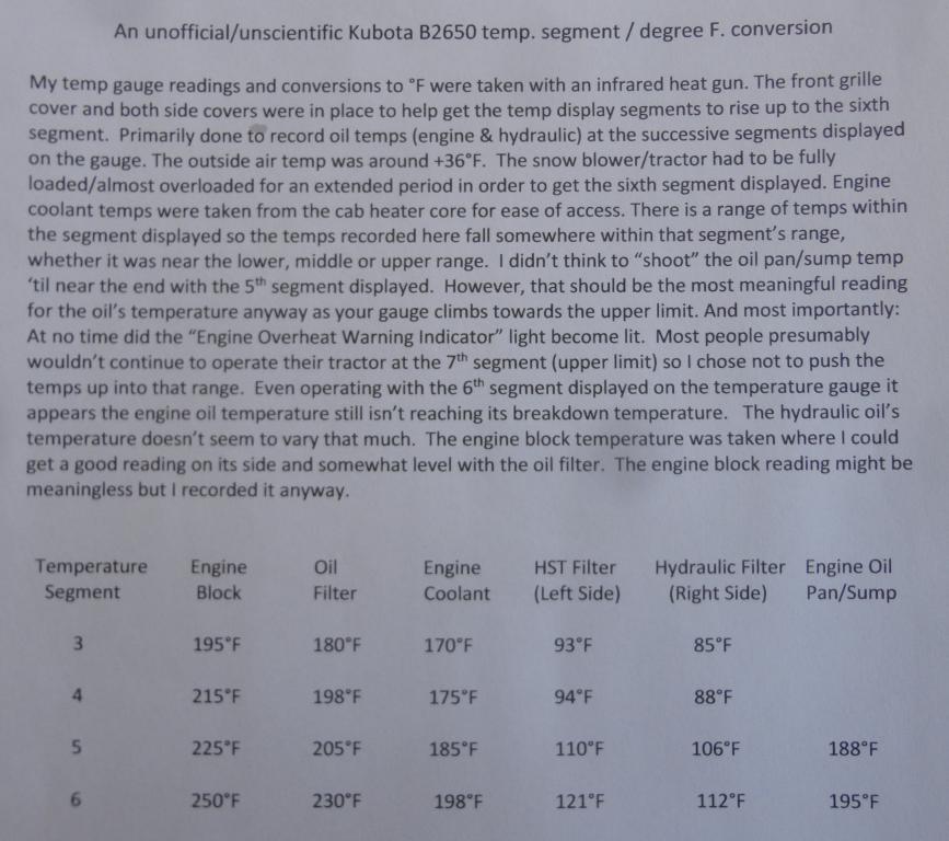

In the interest of science and for all inquisitive minds :D: Last weekend I decided to run an experiment to look into some oil/engine temperature questions posted here shortly before by Deepwoods, Orange1forme, etc. The experiment also falls in line with Eagle’s findings. I just happened to take a few more readings at higher gauge temperatures as displayed on the B2650. It’s in no way a scientific test but at least it does provide some insight into the different temperatures found at those locations. Using an infrared heat gun and recording the highest/average reading for each location. Using a PTO snow blower for loading the tractor required a sustained heavy load to get the gauge to raise up to the 6th segment. As soon as the blower was stopped so I could quickly shoot some temps the cooling took place just as quickly. Since the temps were recorded on the way “up” the segment display, the first readings might be a tad low because heat was still being accumulated and stopping the load to record gave the heat a chance to dissipate. At the upper end, the readings should be pretty accurate as it took a while to get there and everything was pretty well warmed up by then. Here’s the setup and the recorded resulting temperatures:
From the oil pan/sump temperature...it looks like one shouldn't be afraid at all to run the B2650 loaded where the dashboard display registers anywhere from the 3 to 6 segments. Hopefully others with more knowledge will comment too.
Note: Sorry, it was impossible to format the findings in a post and have the columns align so I wound up taking a picture of the Word document. If anyone can make better use of the Word document for displaying it that would be great. Otherwise, I hope you can read it.
