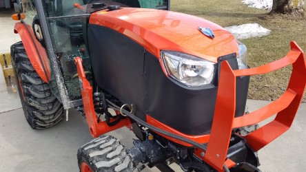

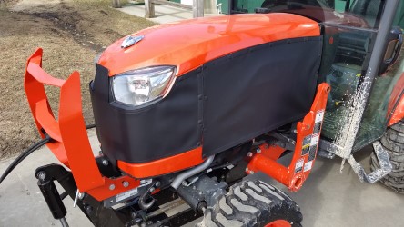

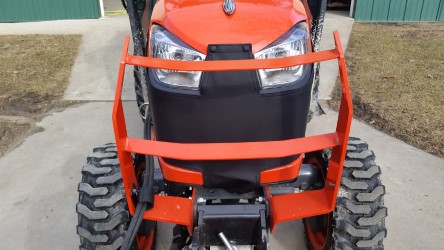

Thanks for the compliment, Orange1forme. I think you should have a PM in your inbox from me. If not, could you send me an email? Thanks. You have dibs on the other set. (two left) Regards, David

Glad that works for you on your Kubota L3901, Fido Farms. Apparently your larger tractor generates a lot more heat. On my B2650 I couldn't get the heat gauge to register anything at those same temps even with the radiator blocked off as stated earlier in this thread. Thus, the reason for the rest of the removeable grill and side skirts. I feel better operating the B2650 within the temperature range its supposed to be in. And they keep the hydraulic oil warm and the fuel in the tank from gelling to boot. Thanks for looking.

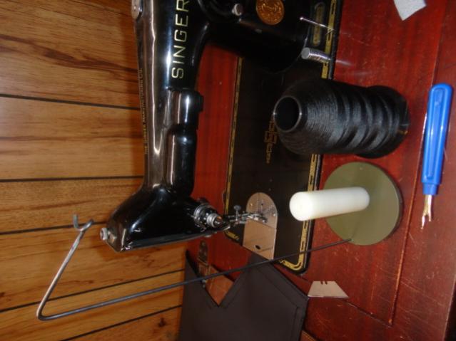

Thanks, Jerry! Yes, the Singer 201's are a simple but great little workhorse of a machine. Perfect for doing tasks like this. That little attachment I made to go on top of the normal spool post sure worked well to help guide and take the thread off the industrial sized thread spool. Thanks for looking!!

That’s pretty clever! I didn’t notice it at first. I’m going to have to try that, I’ve never used the bigger spools before. You never know what you’re going to learn on this forum!

Jerry, here's some more pics of that for you. Maybe someone else might like the idea and use it for themselves, too. The stand was made with a metal bottom (for weight) and a plastic (Delrin) rod screwed to it for the industrial spool to slip over and stay in place. The springsteel rod has a twist in the upper end to keep the thread coming off the spool vertically. It worked pretty well by itself but will still turn into a rat's nest once in a while until I added the other piece. This "other piece" was just a piece of round rod drilled in the center to slip over the normal spool holder on the machine. It has a small hole through itself near the top for the thread to pass through. It's a loose fit so it can swivel as it needs to do. Using a needle to first pass the thread through a scrap piece of vinyl and then through that added guide puts just a little tension on the line and has stopped the thread from jumping of the big spool and turning into a tangled mess. All used together, they seem to work pretty well. Here's some pics:
Now if there was only a way to load more thread into the bobbins or feed that bottom thread externally. :D
I should add that putting the bends in the "piano wire" rod is real easy. Just heat the area to be bent with a propane torch till it's red hot. (doesn't take long) Then using a pair of regular pliers or needle nose pliers bend or twist the wire to shape.
A little bit of sanding will smooth any scale off and you're good to go.

I hope I won't need these covers until next winter but I ordered and received them now. Dave was great to deal with and his grill covers are well made.
I had an issue a couple of weeks ago with snow and ice build up behind my grill and I could not open the hood because it was frozen shut. These covers will eliminate that problem as well as keeping engine temps. up when it is below zero.
Thanks again Dave for a great product and even better customer service.

Thank you, jdriver! Glad those covers fit as nicely on the factory cabbed tractor. They should definitely take care of your snow/ice build up and freezing hood problems. And if you ever have issues with the covers please contact me. I'm following your lead on winter being over and today my home made cab and the snow blower was removed and parked until next winter. Fingers crossed!!:D

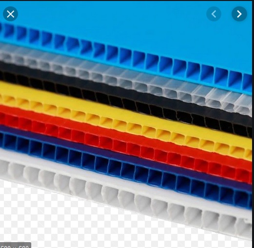

Suggest you consider one step up from cardboard and get the plastic stuff at Walmart or other stationary stores.
It stand up much better to the rain and wet snow.
Even available in different colors

Good idea, I'll check that out. You are right, cardboard has a short service life in the snow.
