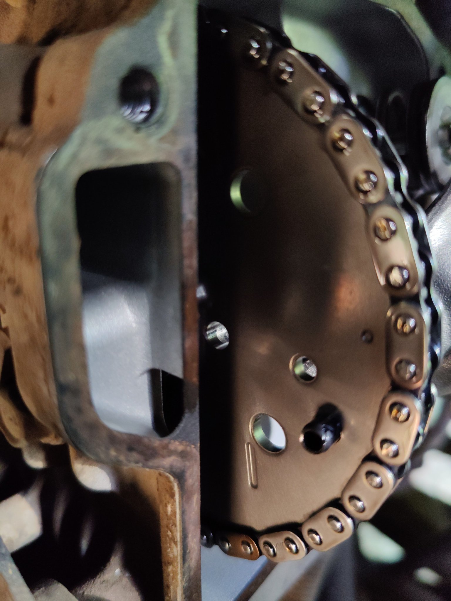

Also, while I was adjusting the valves I took a look at the timing chain. The service manual states that the gold-looking timing chain plate (bottom plate in picture) is supposed to match up with a dimple on the sprocket (right side in picture). This is clearly not the case, but with the spark plug out I was able to confirm that the top dead center on the piston matches both marks on the camshaft sprocket and line up with the head. This must have been assembled not using the timing chain plate as reference for the timing, but it does seem that the timing is good. Am I correct in assuming this?
I let it sit overnight (with Seafoam in the cylinder through spark plug hole as Rollo suggested) so I could adjust the valves again this morning. Got the valves adjusted (only exhaust valve was a tiny bit loose), everything put back together and took it for a spin. To my disappointment, it was back to its old ways of backfiring and not being able to pick up any speed, long after it stopped smoking out the exhaust and the Seafoam burned off. I kept at it, riding it around for awhile, and after a bit it actually improved to what I was seeing the day before. This is a tricky one, but I'm leaning towards the piston rings being shot due to the engine oil rising. Would love to get some opinions!
