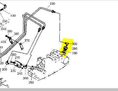

No power steering. No loader. Good running little simple tractor. Wondering about tapping into some block under seat where pressure line goes in. I can fabricate something but I just need to know where to tap in. I think built in pressure relief should take care of dead heading the pump regardless where I Tap in…also need a place to put return back into transmission case I’m guessing…

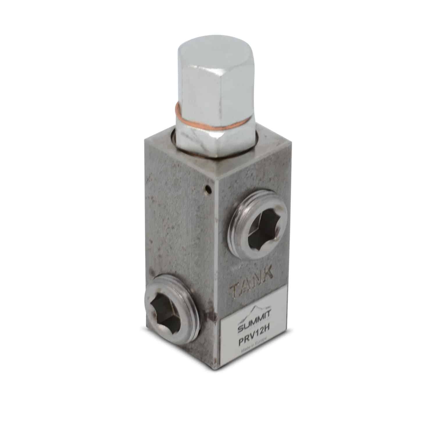

Your tractor only makes 4.5 GPM so 3/8" hose is more than adequate.
An inline relief is cheap protection ($45) and has three ports: IN, OUT, and TANK. Easy to plumb into the pump supply line. The tank line can be 1/4" low pressure hose secured with hose barbs and clamps.
Awesome…Now I have a plan. I thought the relief had to have a dump line. I will measure the line to order the parts and look somewhere on the little tractor body for a dump line into the belly of the tranny. You are Sooo Helpful. Just like flying a plane…once you know how, it’s easy….😎

The cap/plug on the hydraulic filler is commonly used tank return. Positioning the relief close to it would minimize the length of the return hose.
Dan, I’ll look for the filler cap for the drain hookup. Probably screw the return line into it and leave cap off. Just have to remove return line to add fluid sometime. Thank you
