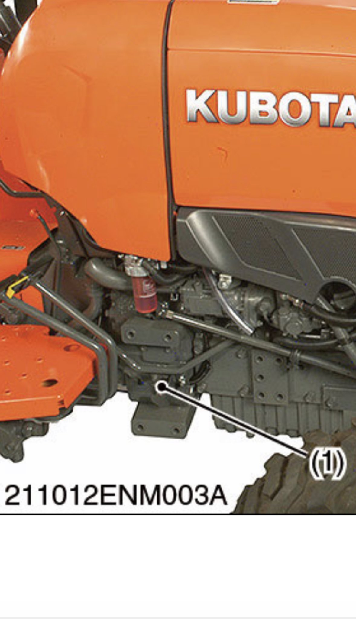

I have a 4701 and the sensor isn`t behind the bracket on right side. Can`t find it so far.
What error code is it displaying and what is your tractor serial number? You may need a software update.
