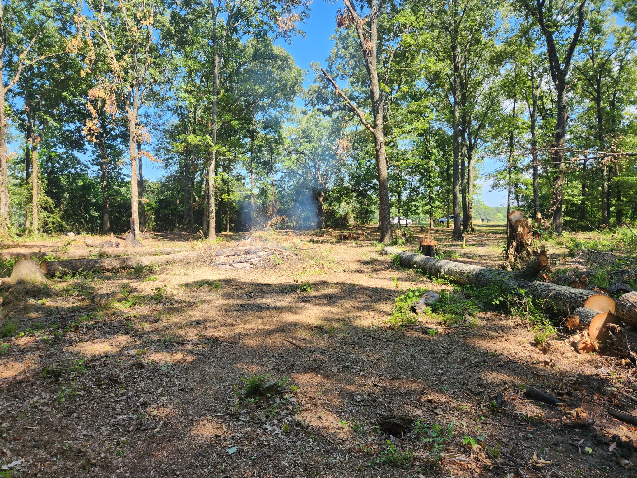

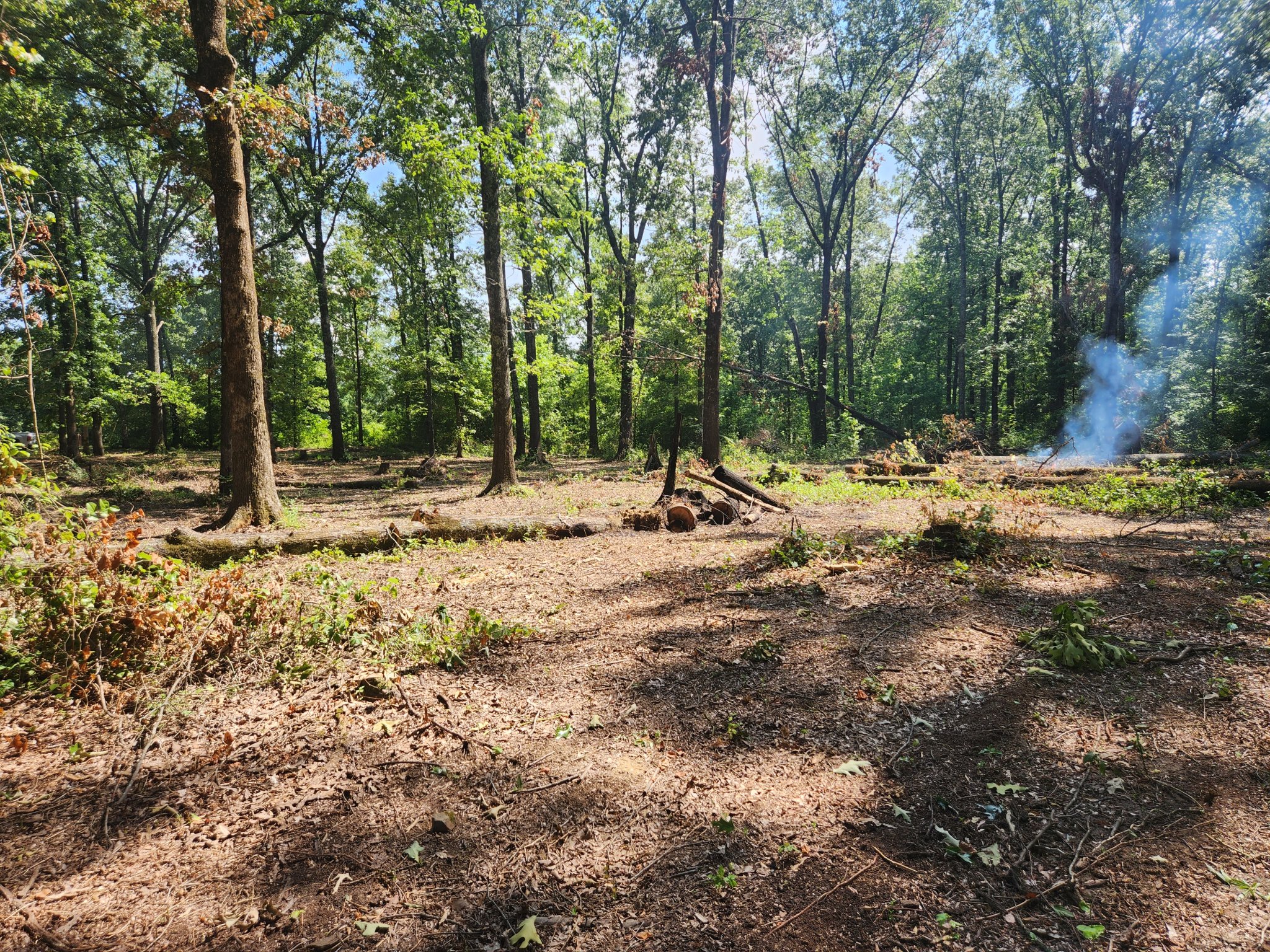

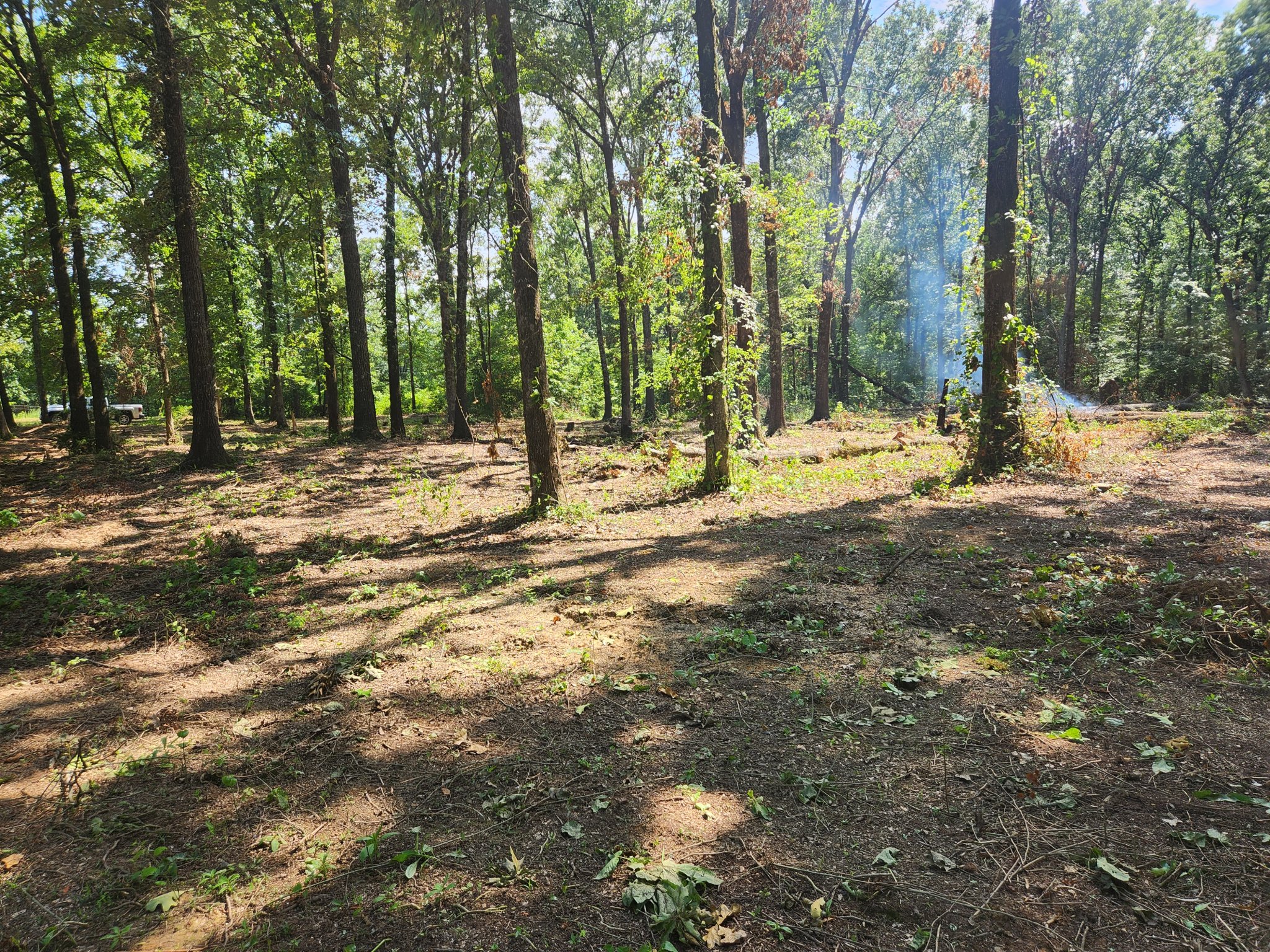

Got it to where you can see through the build site. Burned three brush piles today.

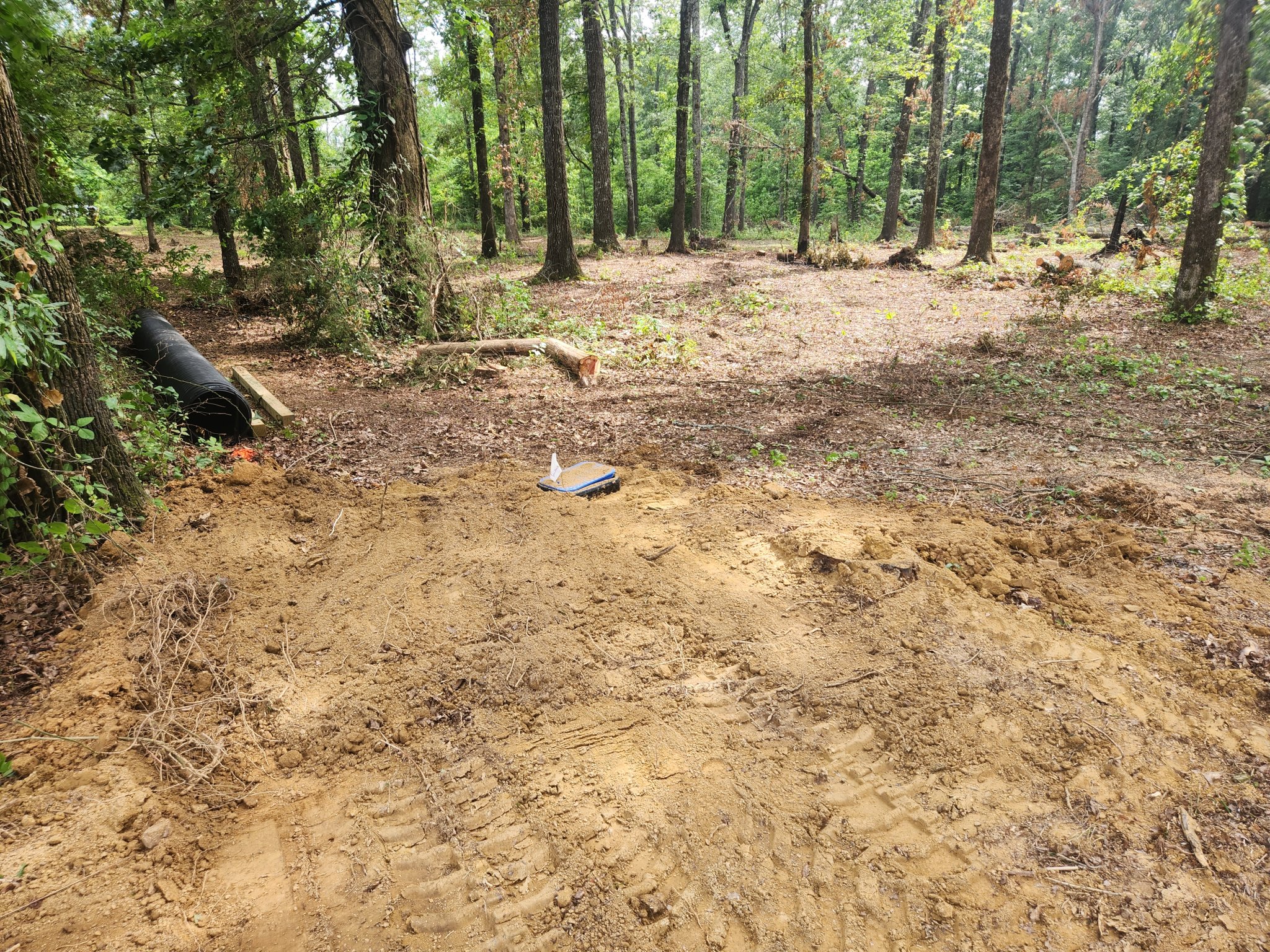

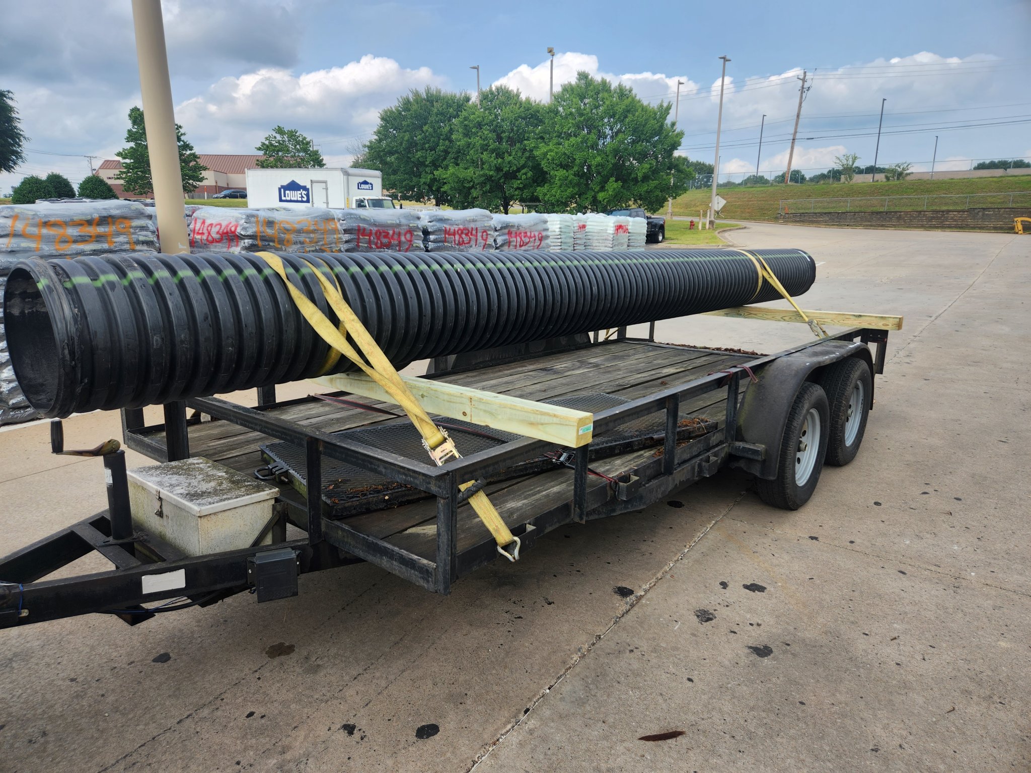

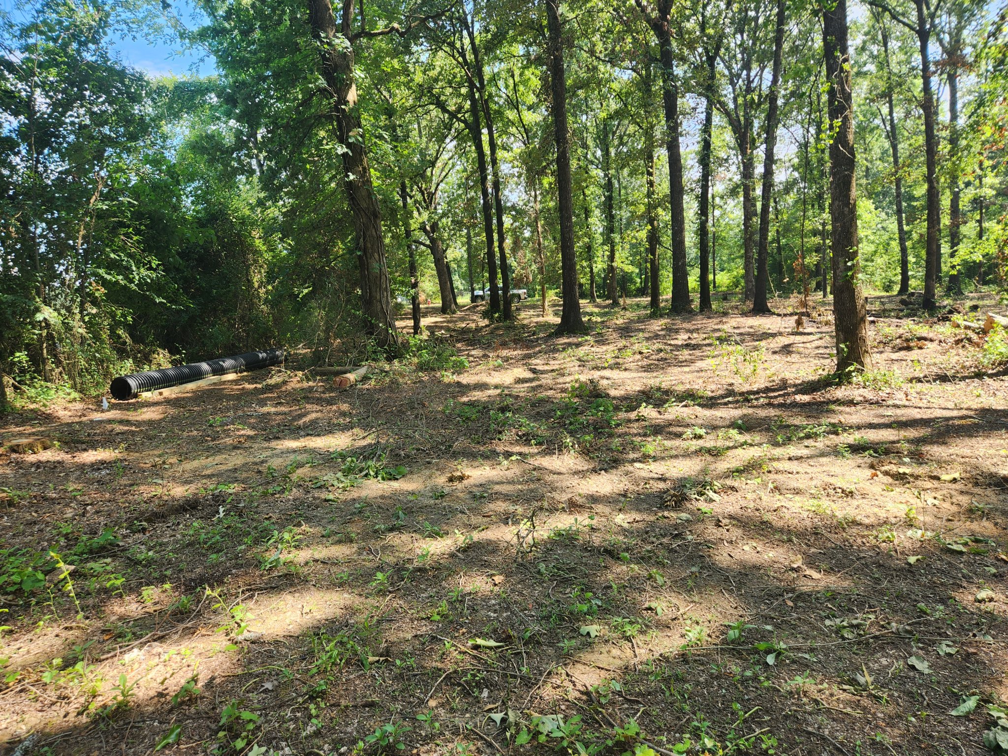

Picked up the culvert and got it out onto the property. Gotta call the county to put me on the install list Monday.

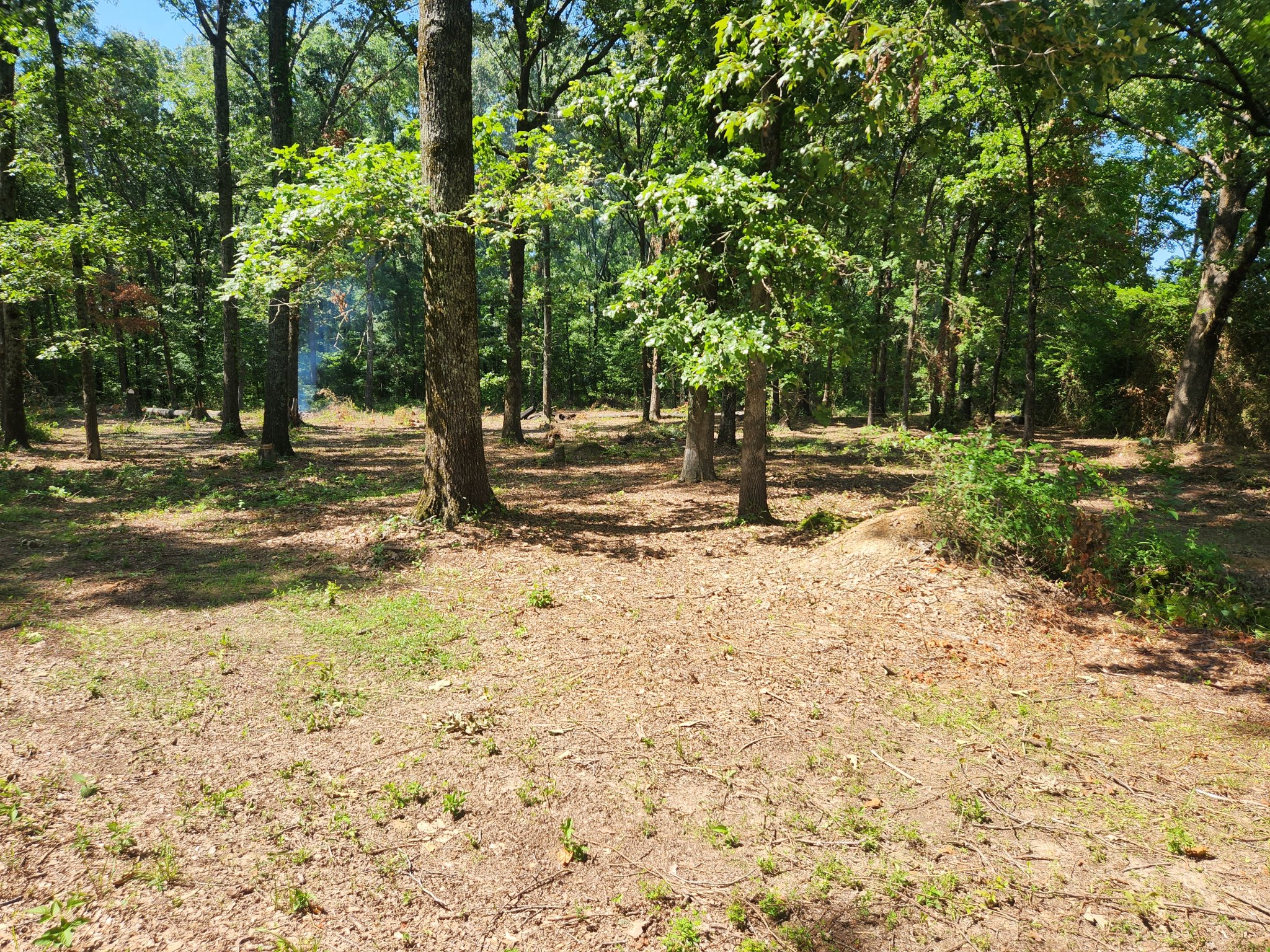

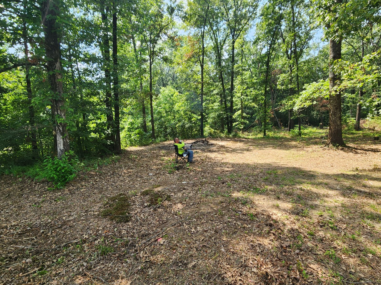

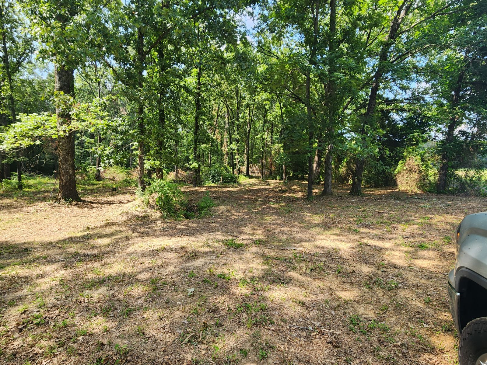

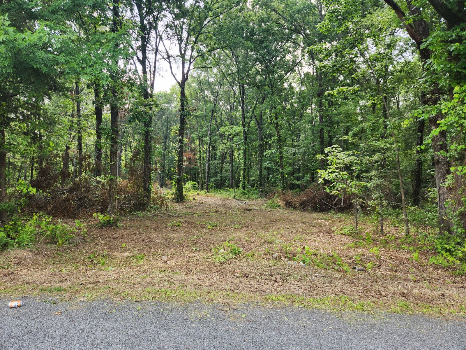

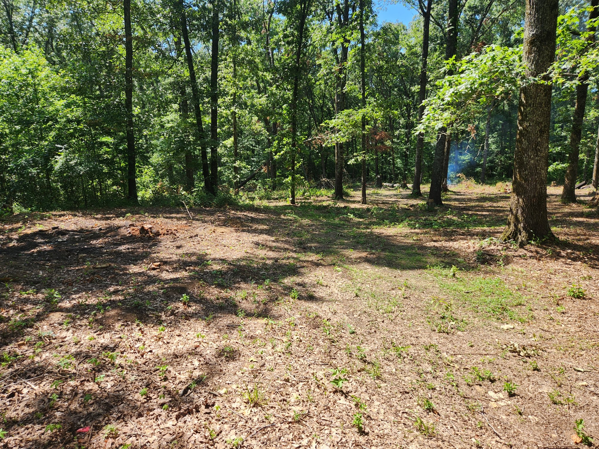

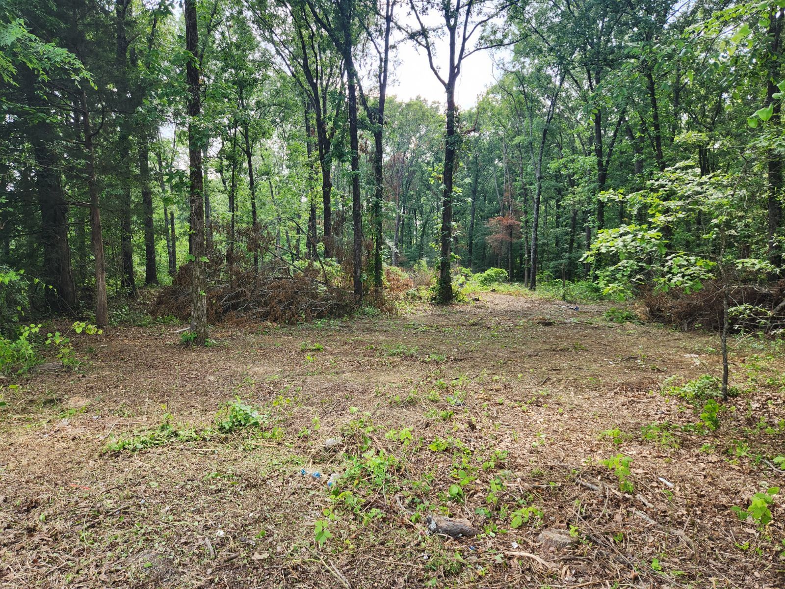

Slowly getting there. Almost time for another piece of equipment to take care of the logs. 👍👍👍👍👍 20230611_153921.jpg

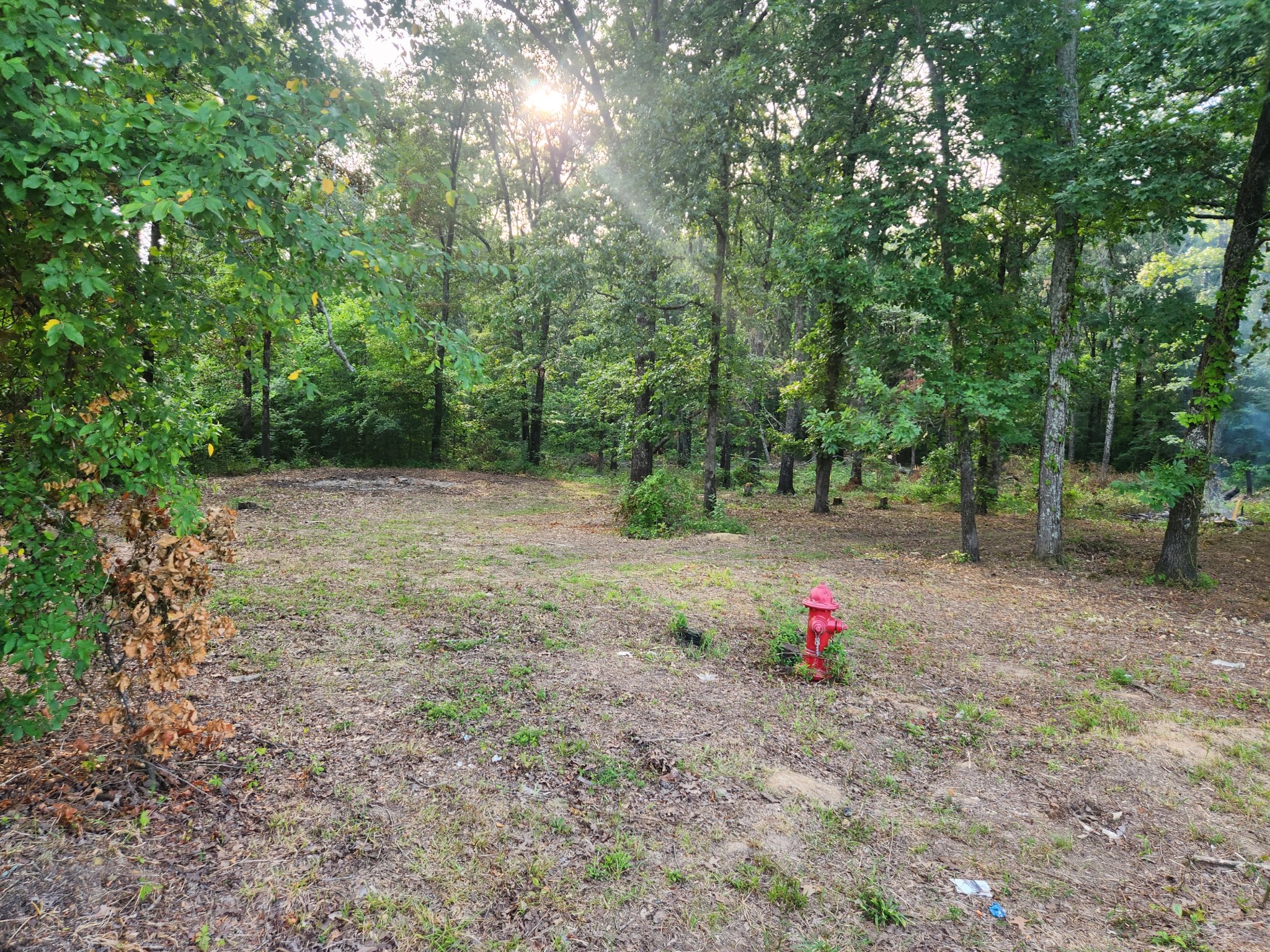

Stopped by to flag the driveway for the county to install the culvert. Was very surprised to see that the water meter has been installed. 👍👍👍👍

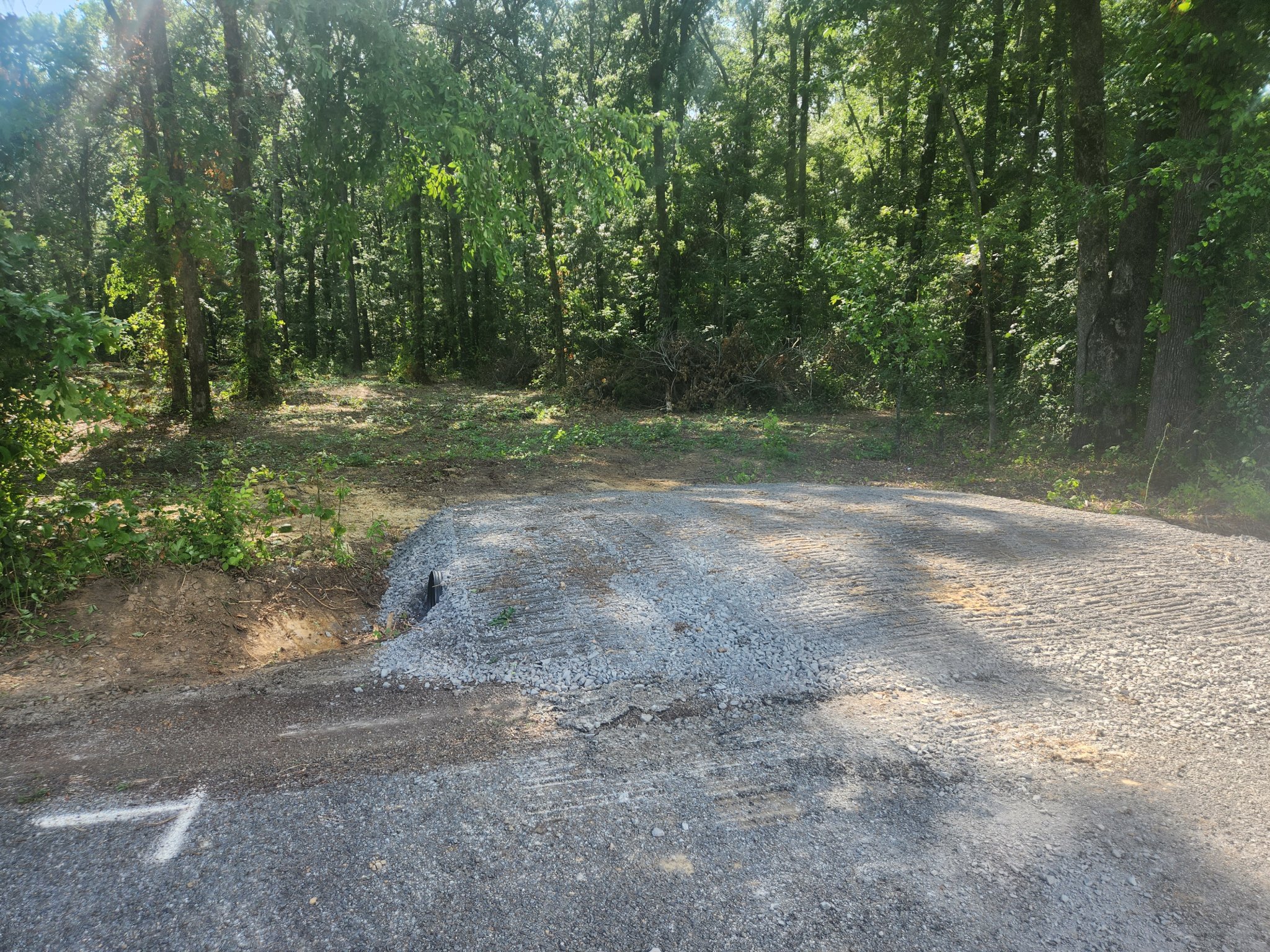

Swung by the property today. The county came out and got the culvert installed 👍👍👍👍
