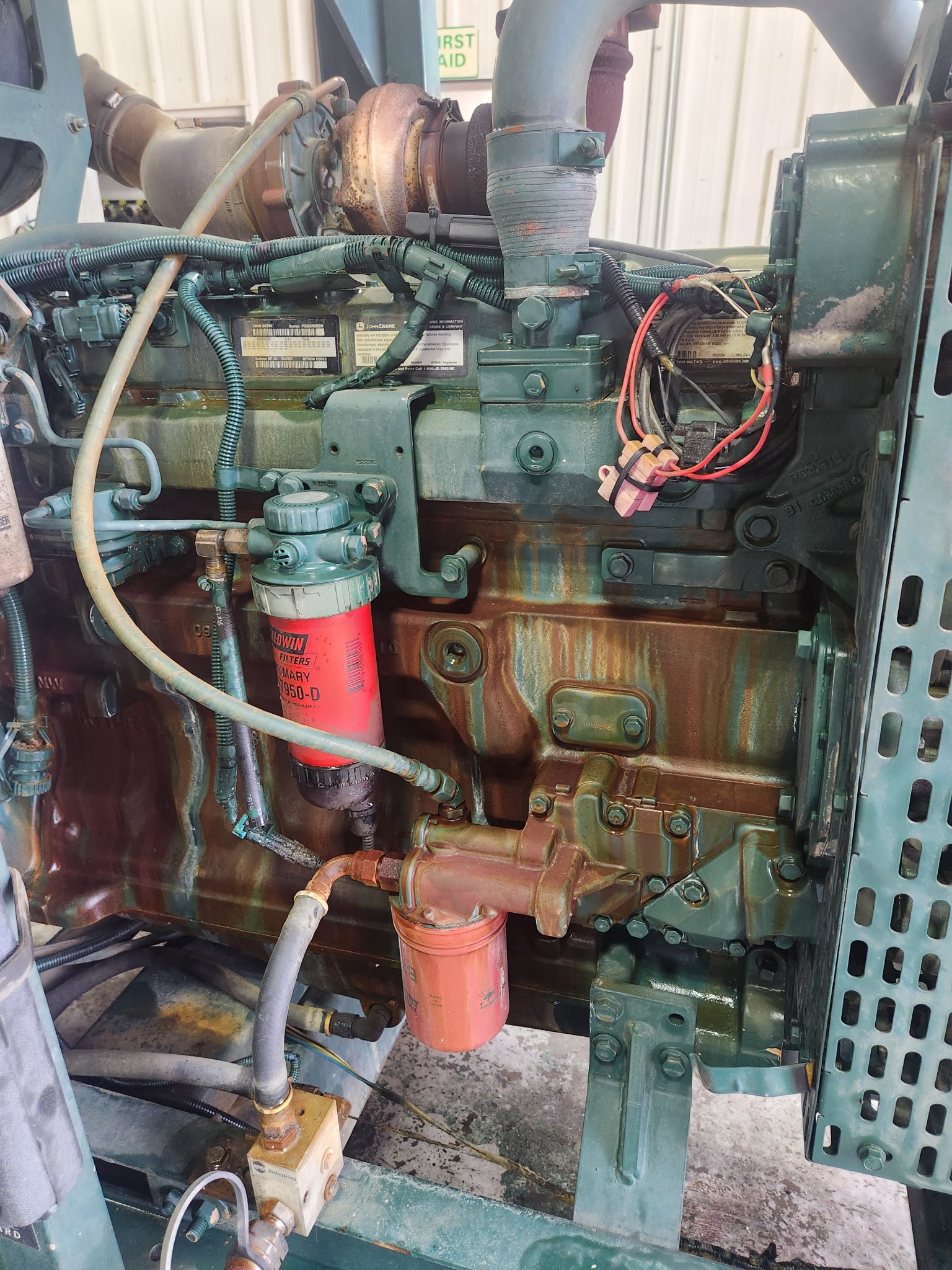

Here's the side view of a JD 4045 engine. I don't have a tier 3 6068 engine currently in the yard for comparison on where the boost line comes in.
But both blocks are similar in design.
Here's my guess. There is a hairline crack between the intercooler and a water jacket in the block.
It's opening up when the engine warms up and is allowing boost air into the coolant system. Since the boost side is pressurized, it's not allowing coolant to be consumed by the engine. Or the consumption is minimal.
The 3" hard line coming straight down is where the charged air enters the intake from the intercooler.

Theres a couple pics, the giant square thing is the intercooler heat exchanger and if you think it looks messed up I have a temp pump on the secondary cooling system as I originally thought it was the pump behind the fan pulling air. I haven't switched it back yet because the lower flow rate keeps the splashing down in the resivoir and it dosen't lose as much coolant
