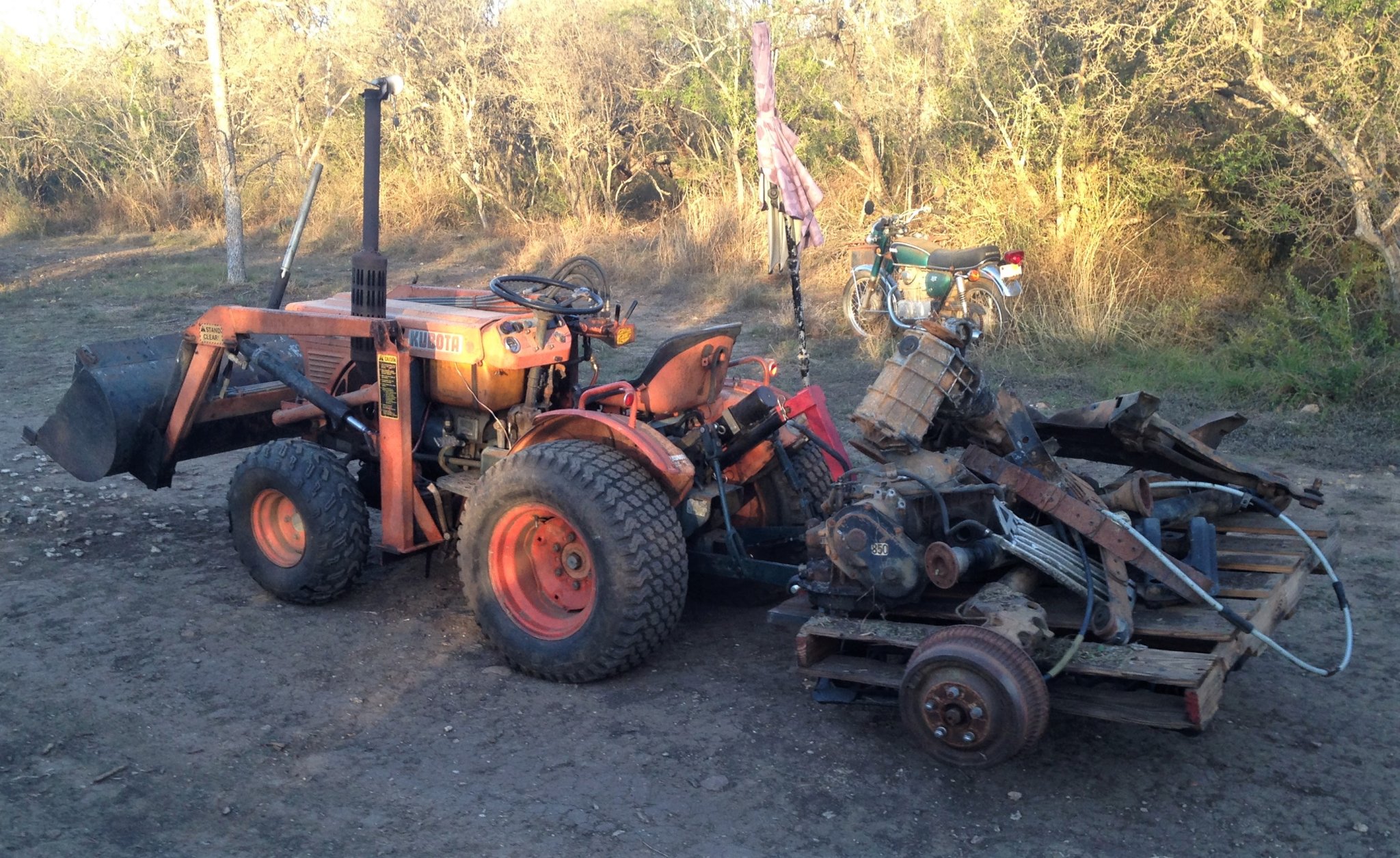

But yes, i agree it's generally a bad idea to go very far beyond the lifting limits of a loader or 3pt because the limits actually are set where they are (through selection of a certain relief pressure) to protect the tractor and operator, not because it can't do more once.. or a few times, or under certain conditions.. They have to set it to a 'lowest common denominator' level that will not allow a hamfisted operator to kill themselves or break the tractor in half just by running one valve handle back and forth. Sometimes it's just that if you pick up any harder on the 3pt you won't be able to steer even with weight added to the front, and sometimes it's because if you go much further something will bend/break. Or, you pick the front wheels up and nothing bends or breaks... but then you let it slam back down and break your bellhousing in half. :oops:😂
I had to 'help' lift this up with the floor jack sticking out of the bucket there, and once it was up i drove it about an 1/8 mile.. but when i had to go uphill it was all steering brakes because the front tires wouldn't stay down. If there was no FEL i would have needed a tailwheel!!
