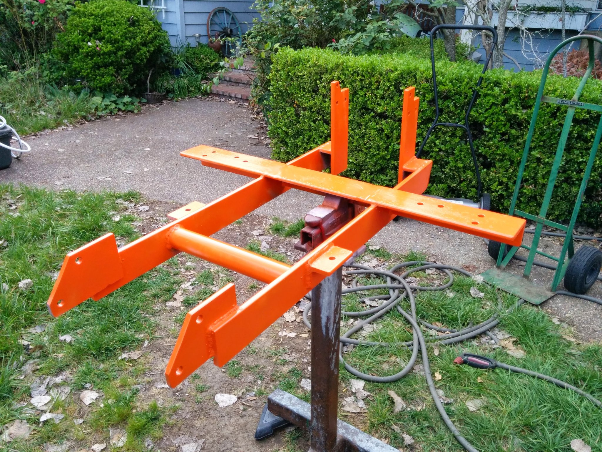

I built a subframe to fit a B219 loaderonto our B5100. It's a matter of figuring out where everything neededs to be:
View attachment 155702 View attachment 155703
Outstanding!! Thank you for the pictures. This is very much what I had imagined the subframe I am going to build. Tying into the bolts that hold the ROP on and moving forward from there along with a couple of cross supports were exactly where I figured I’d end up. I really appreciate the sharing of information. Doesn’t it make a body feel good to accomplish something like this? It does for me! 👍😎

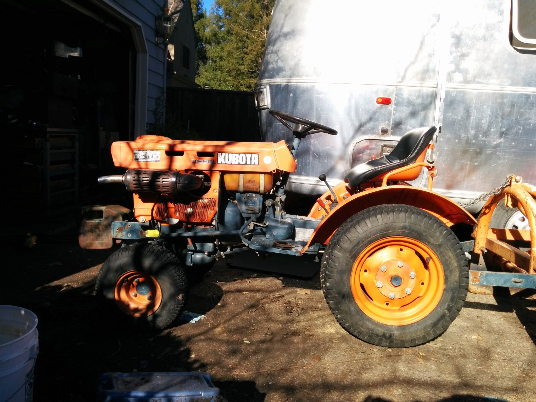

You can think of the loader as trying to tip the tractor forward so that it's balancing on the front wheels. W/o a subframe, the only connection between the front wheels and engine and the rear wheels is the transmission, so the top bolts would be in tension and the bottom ones in compression. Here's a photo of our B5100 sans subframe; there's no way that tiny transmission would be strong enough.

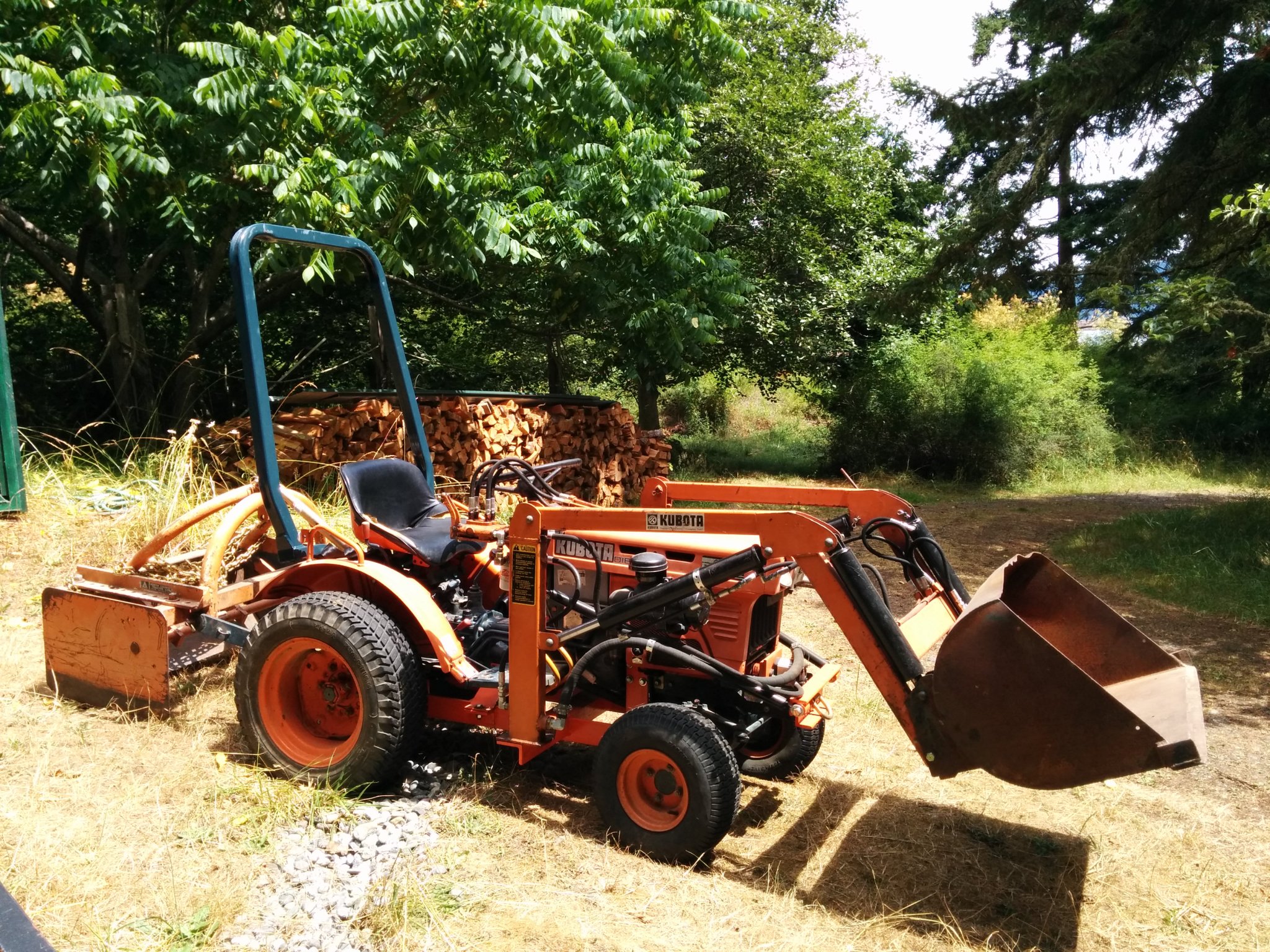

Here's a picture of the tractor w/ the loader and subframe; you may be able to see how the loader forces are tied into the truss formed by the combination of the transmission and the subframe.
