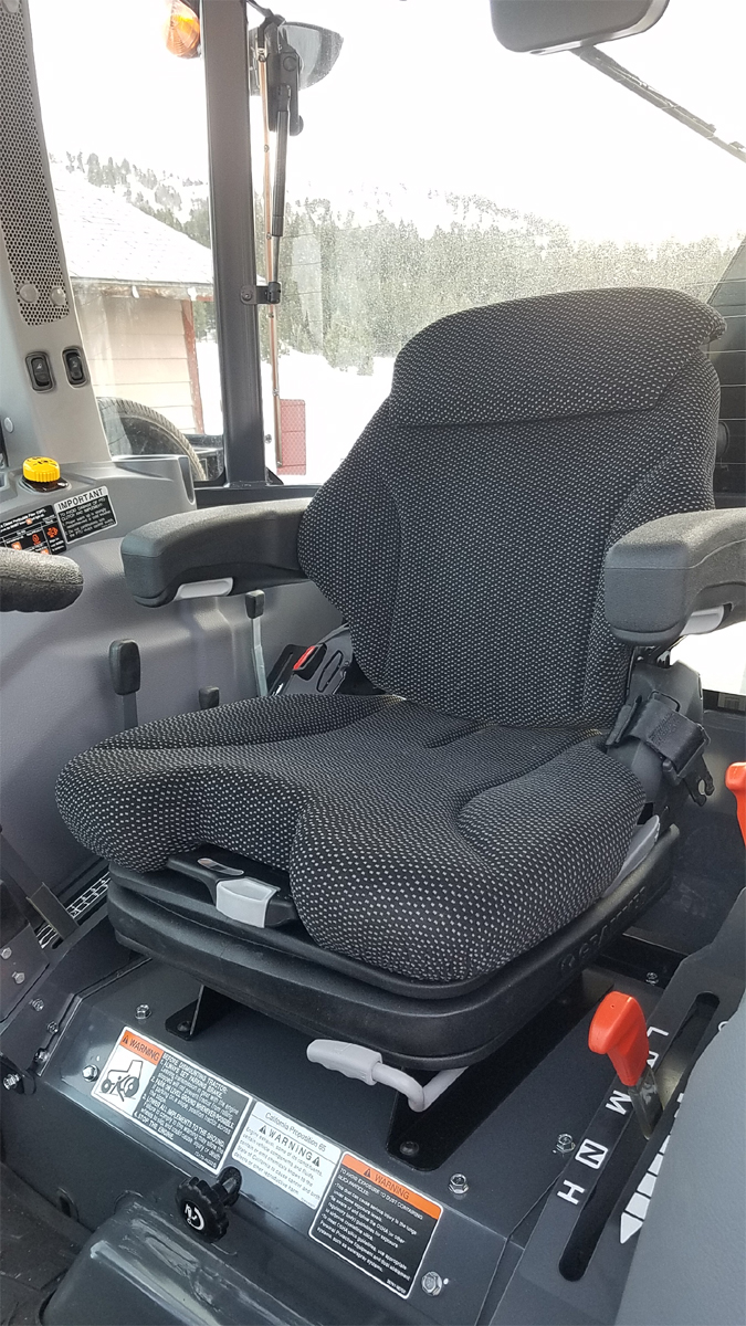

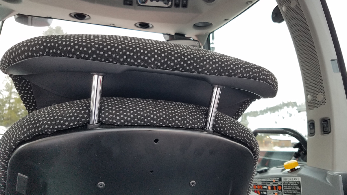

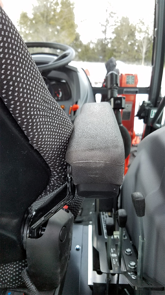

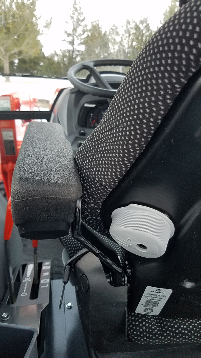

I posted these photos in another thread but you get more than just an air suspension with the air ride seat. The armrests are adjustable for angle, the head rest is adjustable for height, and there's an adjustable lumbar support, not to mention a cloth covering rather than plastic.
Is this seat worth $1,107 ... heck yeah!
