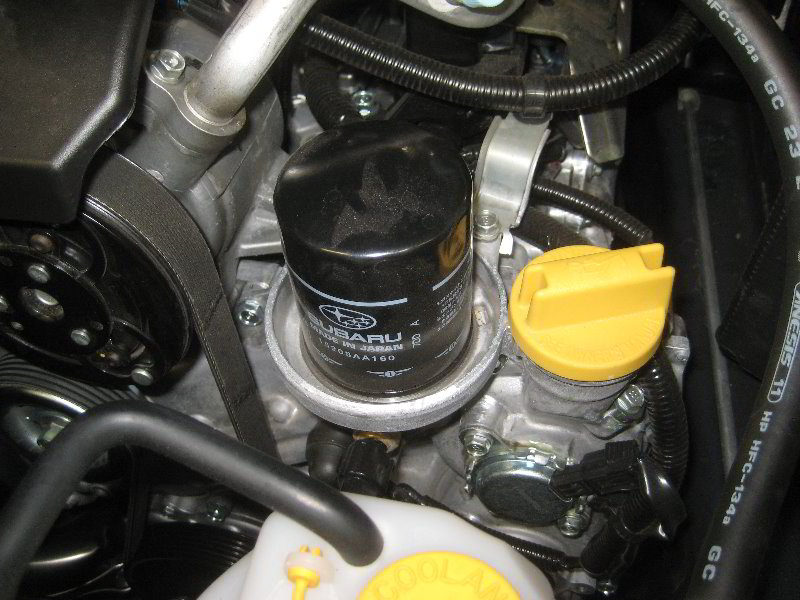

Is there a drain in that "bowl" that allows the oil to flow into a container without making a complete mess?
If it's anything like the Jeep 3.6, there is no check valve, so it drains ~95% of the oil back into the engine after just sitting for a bit.
No, but the cup contains the little bit of oil that drains out when removing the filter.
I usually just wrap a piece of paper towel around the base of the filter and crack it open while letting the oil drain from the pan and by the time it's ready for a new one to be installed the paper towel has absorbed all the oil that has came out.
