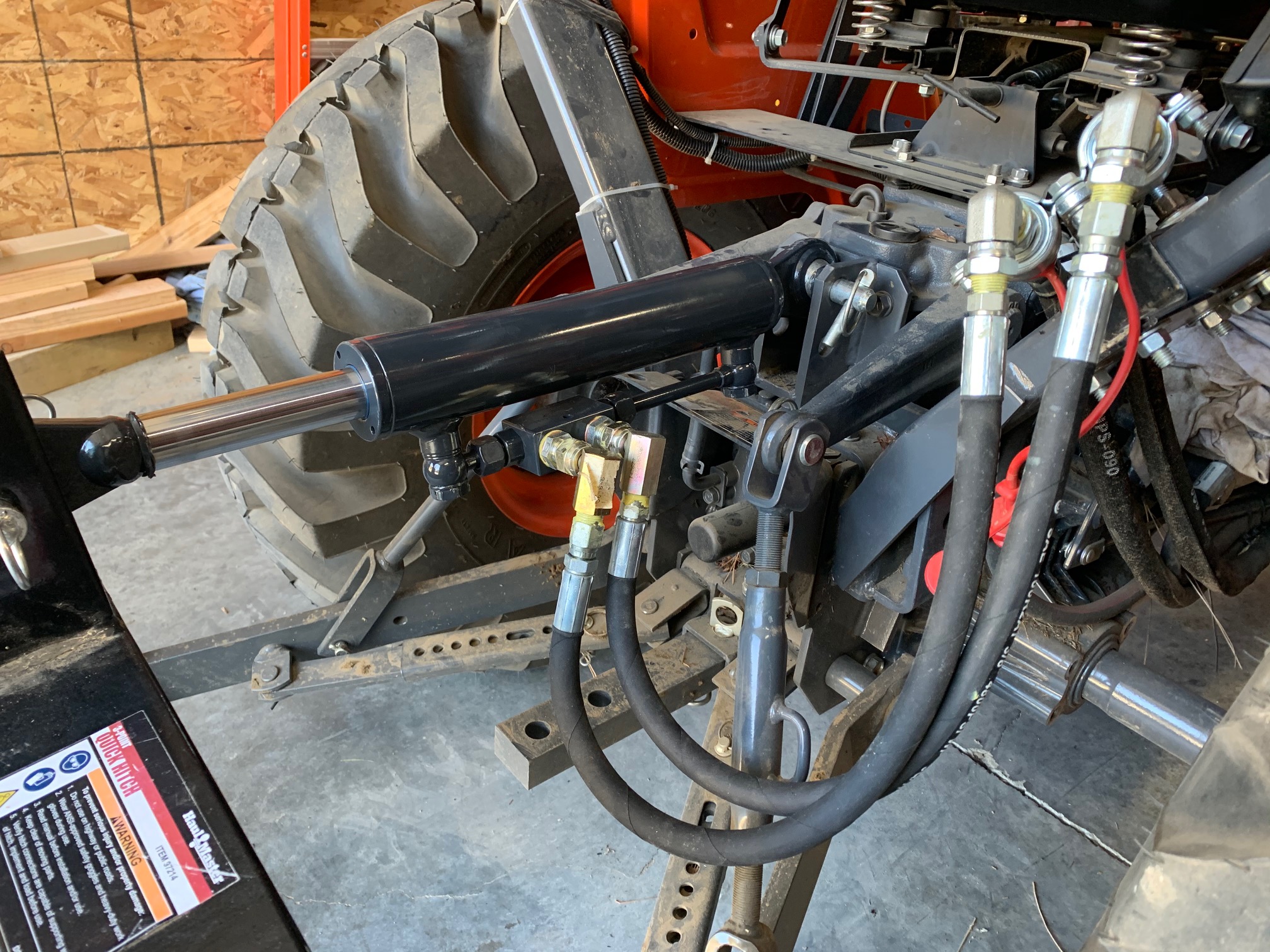

Installed a new hydraulic top link today.

Nice setup! What brand did you go with and is it on your B2650?

It is a AMA USA from Tractor Supply. Had to reverse the double pilot operated check valve and rotate it a 1/4 of a turn to make it so that it wouldn't hit the tractor when the 3 point was lifted all the way up. It is on the B2650.

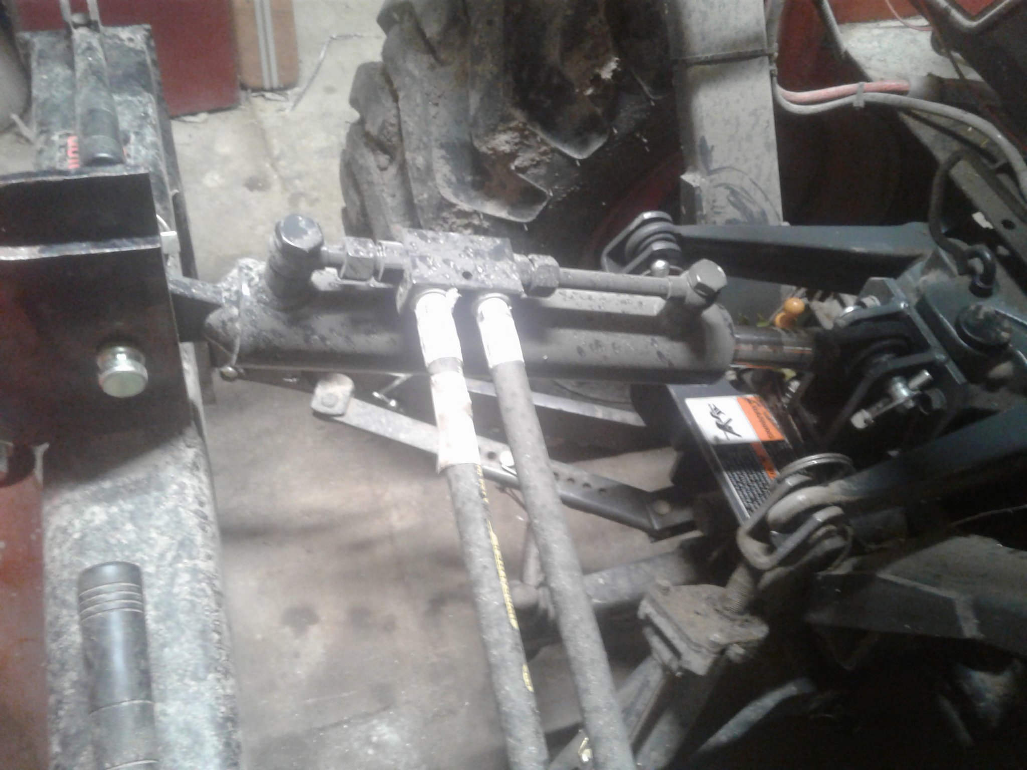

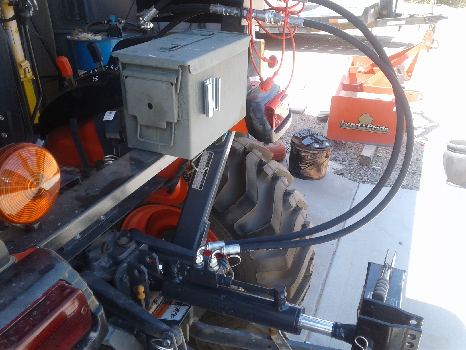

View attachment 49125 I kept mine on top and it works great. you will bw happy you installed it. View attachment 49125
I noticed that you have the top hydraulic link in the bottom hole on the tractor. Have you had any problems with it hitting the PTO guard when you put the cylinder all the way out? i noticed that the manual says you should use the top hole in most cases.
You could install cylinder the opposite way

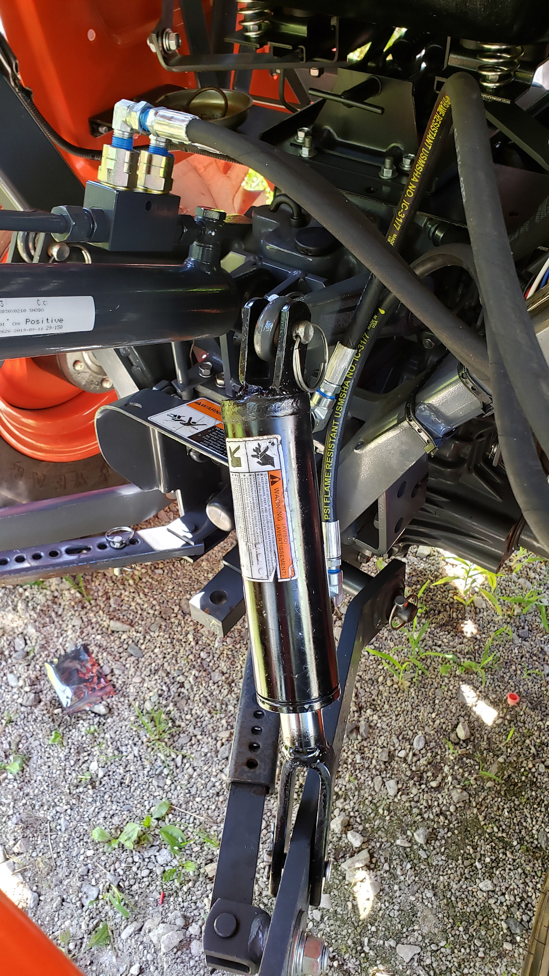

Dumb question, to turn the cylinder 90 degrees, it must rotate at the end attached to the tractor. I didn't think mine would rotate and was permenently welded, but I may not have tried hard enough to twist it.
One side is welded solid and will not turn. The piston end will.
