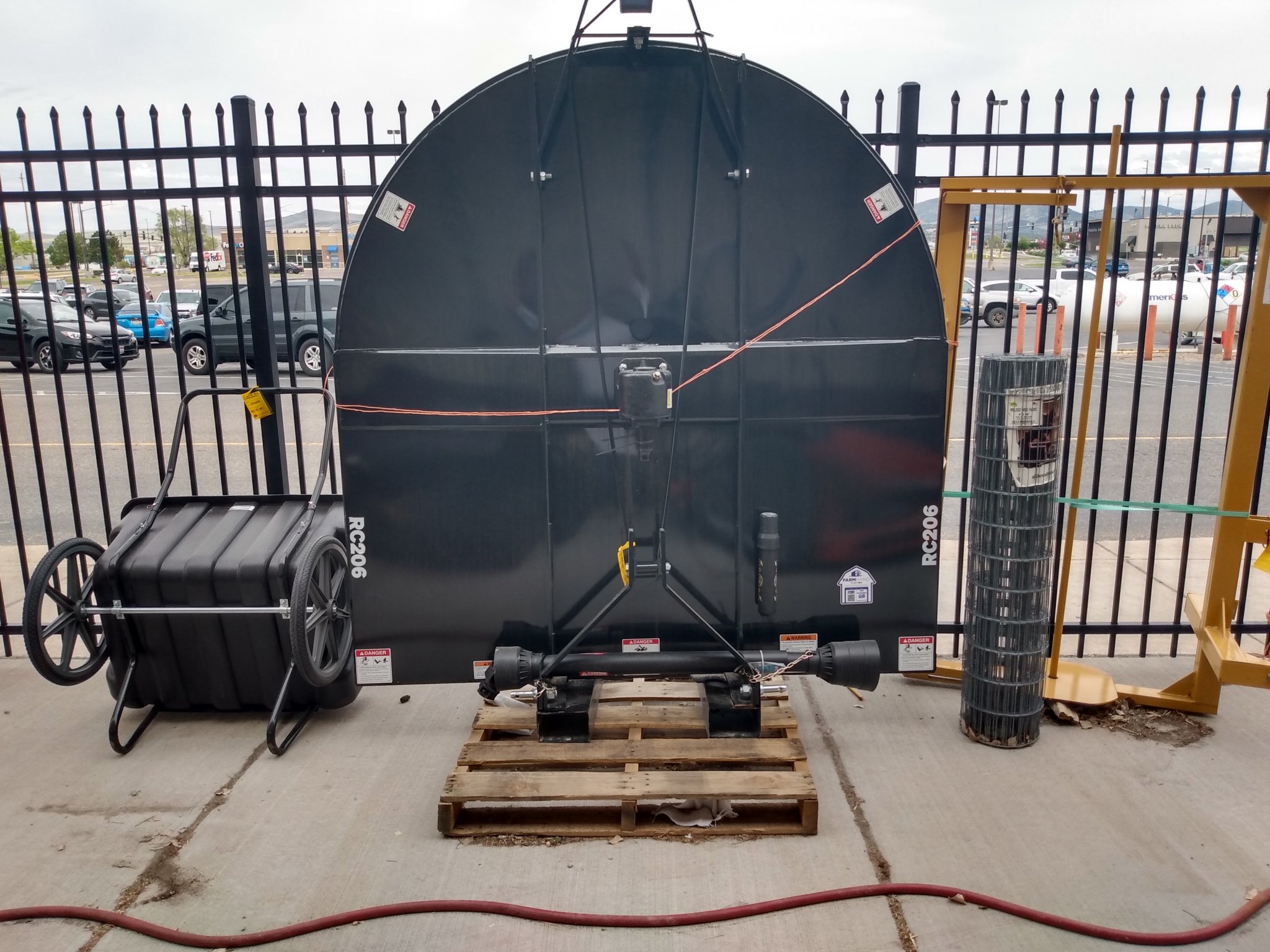

A slick way to store a brush hog, note the large sq. tube with a flange welded to it to engage the 3 point pins. The back side has different type of flange (also dirt simple) that engages the rear. I've never liked how much room my little 4' mower took up, and since I'm considering buying a 5 or 6'er it was preemptively starting to bug me. This 6' mower is ready for me to go get tomorrow, and I wouldn't even have to fab up a similar stand up mount, meant to be! A similar mount for the 4'er (still needed for my bike trails on my 40 acres, don't want a highway, but a trail) along with a second mower and they both together would take up less room than storing them laid down. IMG_20210514_154505737_HDR.jpg

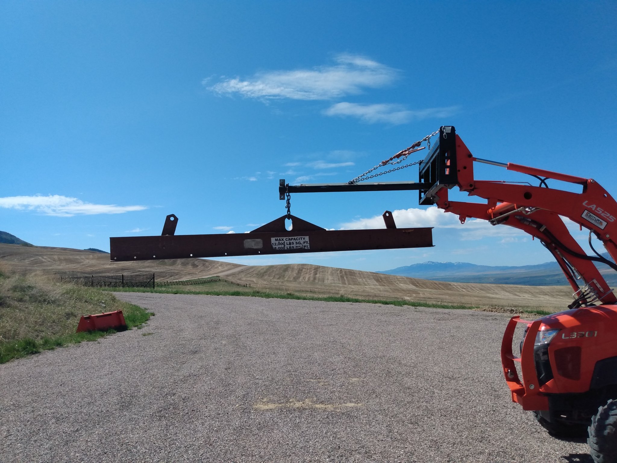

A simple plug in cherry picker I made up using what I had on hand, some thin wall tubing (not pipe) part of a defunct wind turbine I was given, with some scrap angle iron welded on it to stiffen it, also scrounged somewhere in the past. It plugs into my 2" receiver in my forks QA, and the chain rigging sit's in notches ground in the side frame, and goes on in about a minute or less. Purposely built lightweight, I thought I would have trashed it by now by asking it to do more and more, but it's hanging in there. The tip will hit 13+ feet high, with the "bucket' curled, and I've picked up to about 500 pounds with it. This spreader bar only weighs about 250. IMG_20210513_110028551.jpg

Might be difficult to stand it up and lay it down. And that makes for a pretty big kite. A little wind and there she goes. Unless you tie it up to something.
Maybe a table that would let you slide the big one under and lay the little one on top.

That is a very cool winter storage solution but was thinking the same thing about how one would stand up and lay down the cutter. Maybe a strap is the way to go if the loader has enough clearance. My RCR1884 supposedly weighs 850lb without the driveline and with a front rubber guard. I have metal chain guards front and rear so all in around 900lb. That's a lot of weight to mess with but I'm still interested in the concept.

You are correct sir! I ended up buying a 6' rotary yesterday, it was in stock at a local farm supply outlet (20 miles away, but I had new implement fever). I'm putting the 4' mower up for sale, a perfect time of year to do that, I'm thinking 350 to $450.00, NOT trying to sell it here just thinking out loud. Anyway, by the time I got it assembled, it was patently obvious the "stand it up" thing would be more trouble than it'd be worth, especially as my outbuilding's door is only 8' high, I'd have to pull the rear wheel assemble plus the driveline, too much busy work. But it remains a slick way for the manufacturer to ship them, the end user for storage purposes, not so much.
All my attachments are stored inside, but I have decided to keep it simple and during the mowing months just keep it around the shop, on or off the tractor. I'm in a rural area and have plenty of room. Come fall I'll run it down to the lower part of my 40 acres, and probably throw some rubber roofing membrane scraps over the driveline/gearbox and call it good. The net result being my mower is now 24" wider, and I've GAINED room in the outbuilding as the old mower will be history.

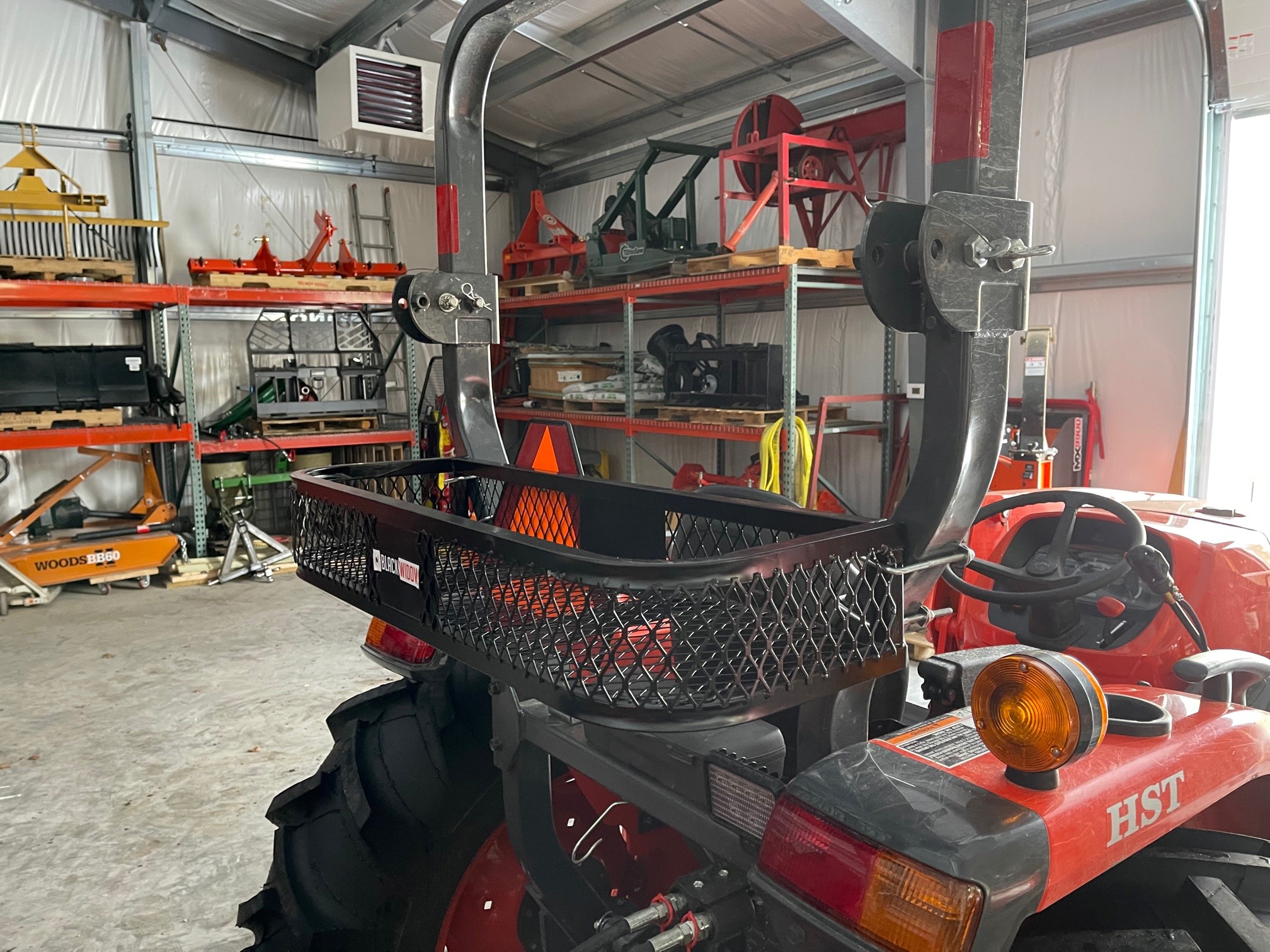

I racked out the rear bay of my barn for attachments / implements and bucket storage, in total I have about 60' of 10' high 48" or 42" deep shelves. No matter what I always think you need a little more space!

I like that rear carrier you have, the little plastic Kubota supplied "tool box" is still accessible too I see. Nice space utilization, it always bugs me to see an aircraft hangar or farm building, jam packed, while having 14 or 16' ceilings and nothing hanging from the ceiling or any shelving!

The rear basket carrier is an ATV accessoryI fitted one to my L3200, L3901 and MX5800, they are super useful for a chainsaw, gas and oil. My shelving helps keep the floor clear and allows me to store most of my equipment inside. It makes more room for other machines!

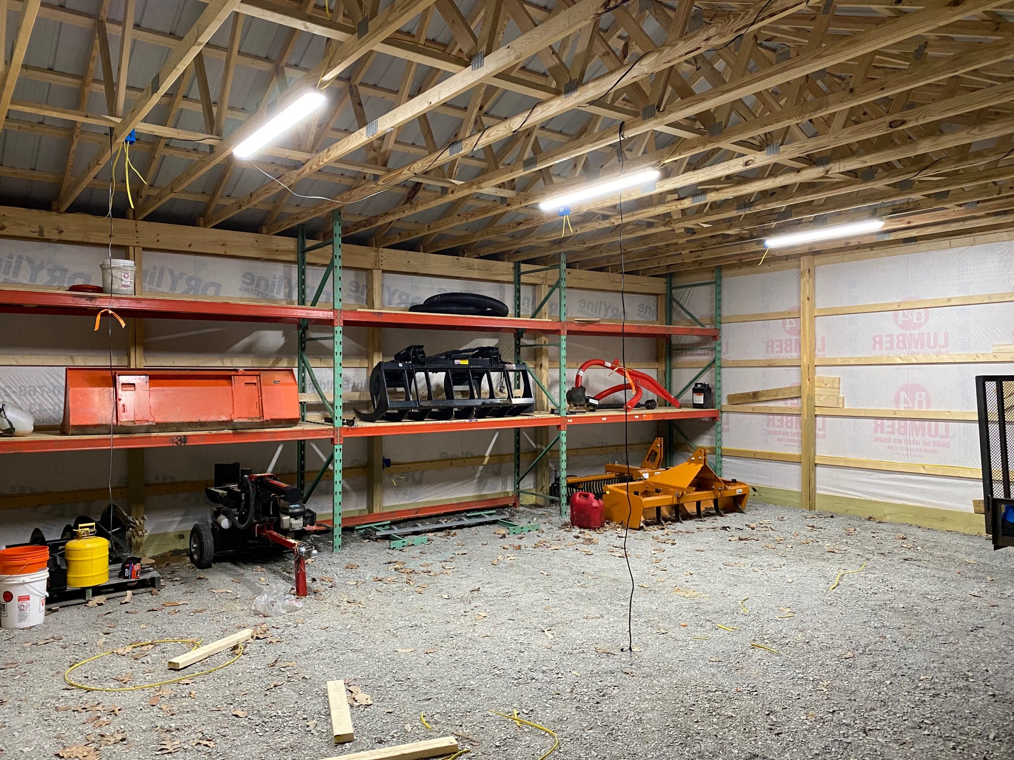

Just another variation on the FEL and lighter attachments on shelves and 3 point attachments on the ground. Sometimes I wish I had the concrete floor and may add it at some point down the road. One 10x25' enclosed bay with roll-up and three open bays same size.

The only problem with having implements on racks inside a barn or shop, particularly one with limited space, is that you need to keep the area in front of the racks clear for ease of access, although if that space is used to park the tractor it would be ok.

Yes, it's not a foolproof solution, but I find that it works much better than no racks at all. I am able to keep seven or eight implements out of the weather and can access any of them in 15 minutes or less.

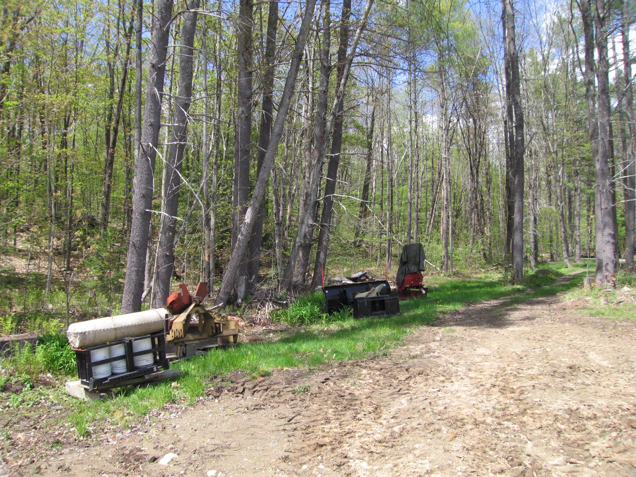

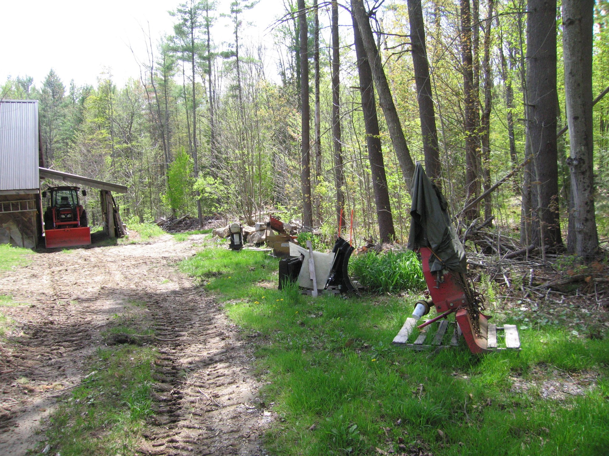

I 'double skid' everything if outside. Seems the lower one rots away over time....top one is good to lift though ! Also , use the SAME sized skids for everything........makes life simpler...
