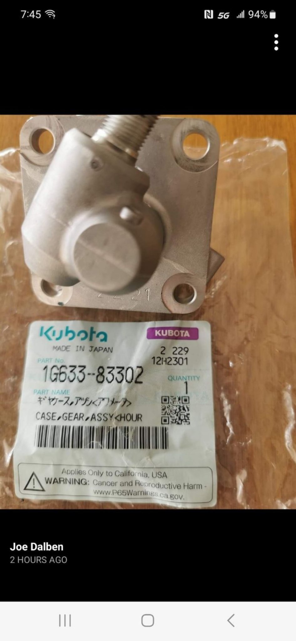

I think thats the problem with mine. do you know if they call it a "case ,gear, assy/ hour meter"? found a part number 1G633-83302.

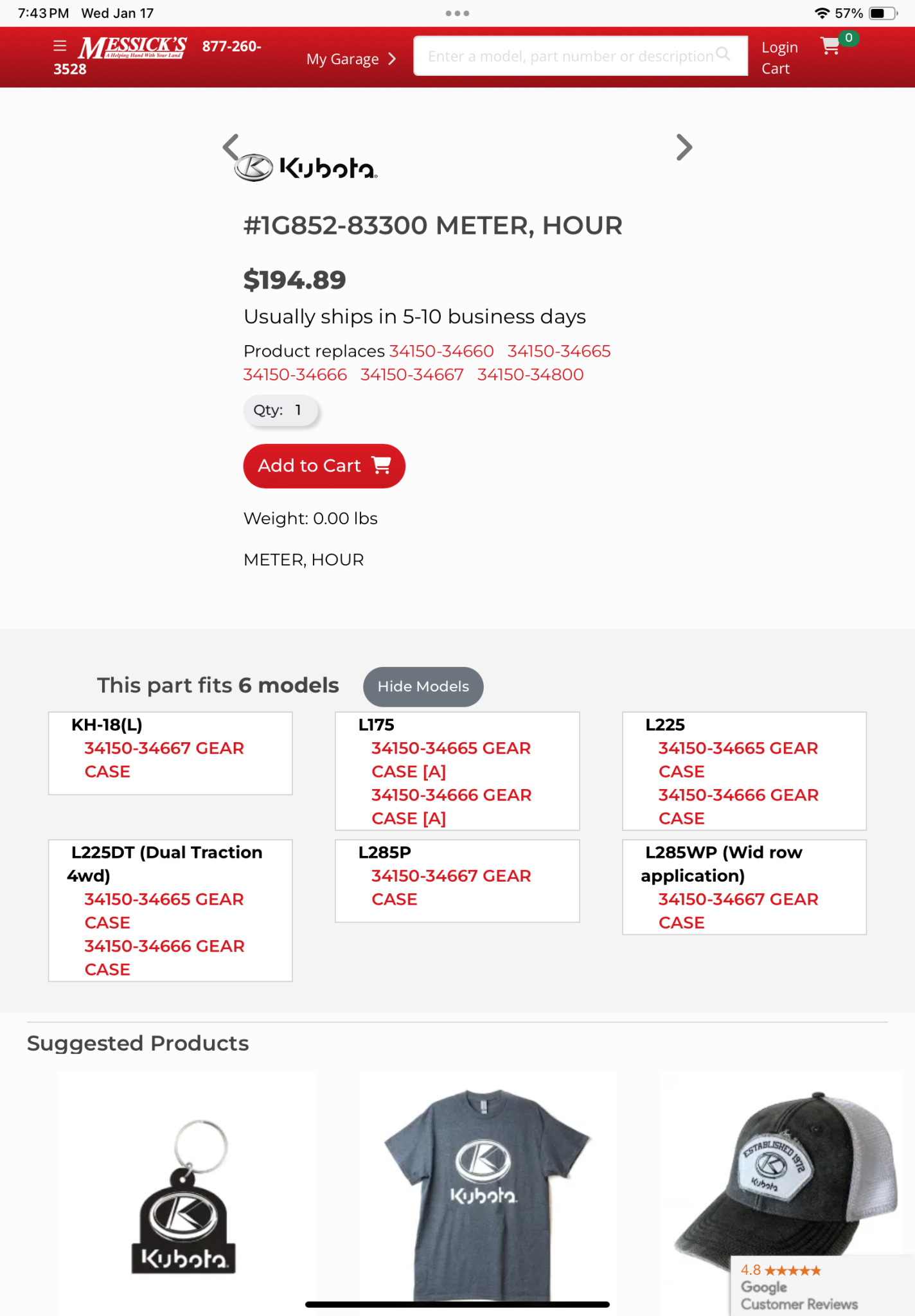

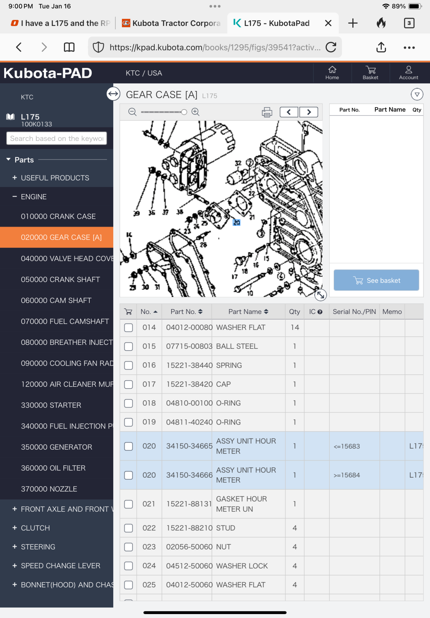

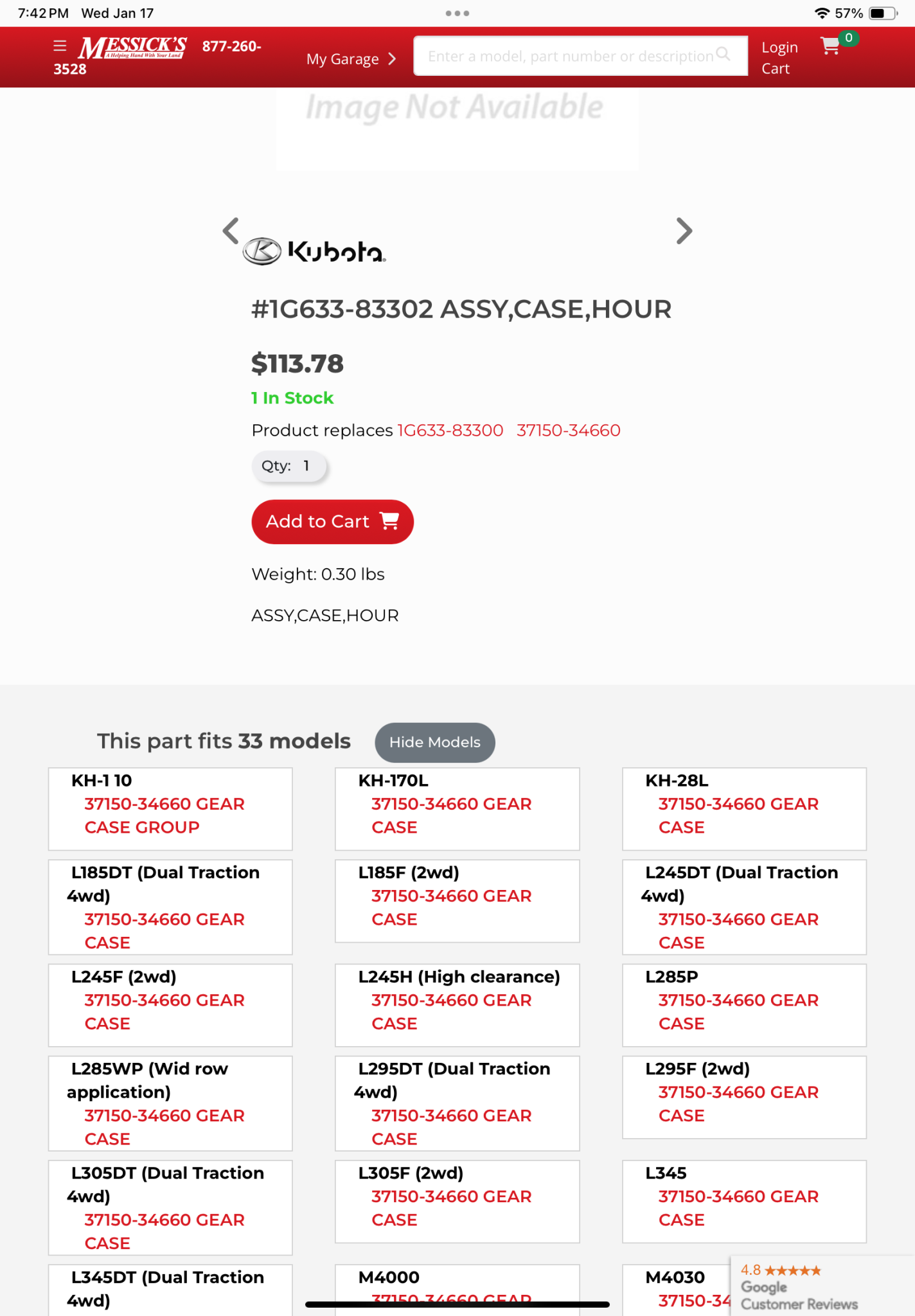

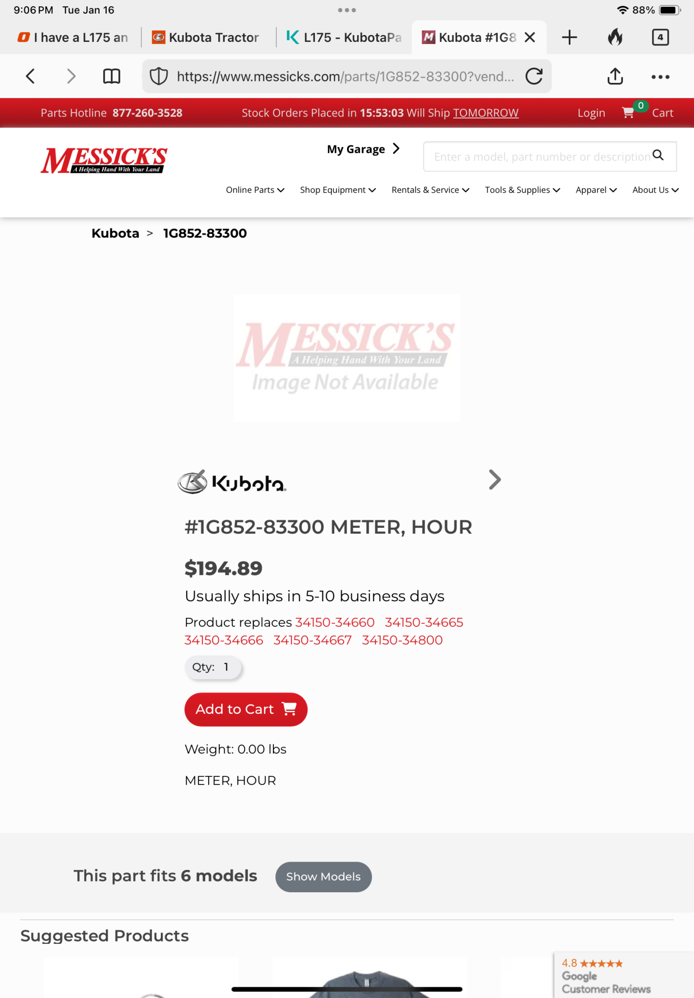

Here is what I found on Kubota USA Ilustrated Parts list but see new part number from Messicks below
I have no idea what the part number you stated is. I can’t find any pictures of that part
6,869
2,390
Yes that looks like the tach drive for some engine that is similar to what you need.
Kubota showed two part numbers based on the tractor’s serial number. Then I searched for one of them and Messicks converted it to a similar number as yours.
Yours seems to be for larger engines
The one I found mentions the L175
I think you should get Messicks or your local dealer look for the correct one so they will need to have the serial number or they may end up having two numbers to choose from without the serial number.

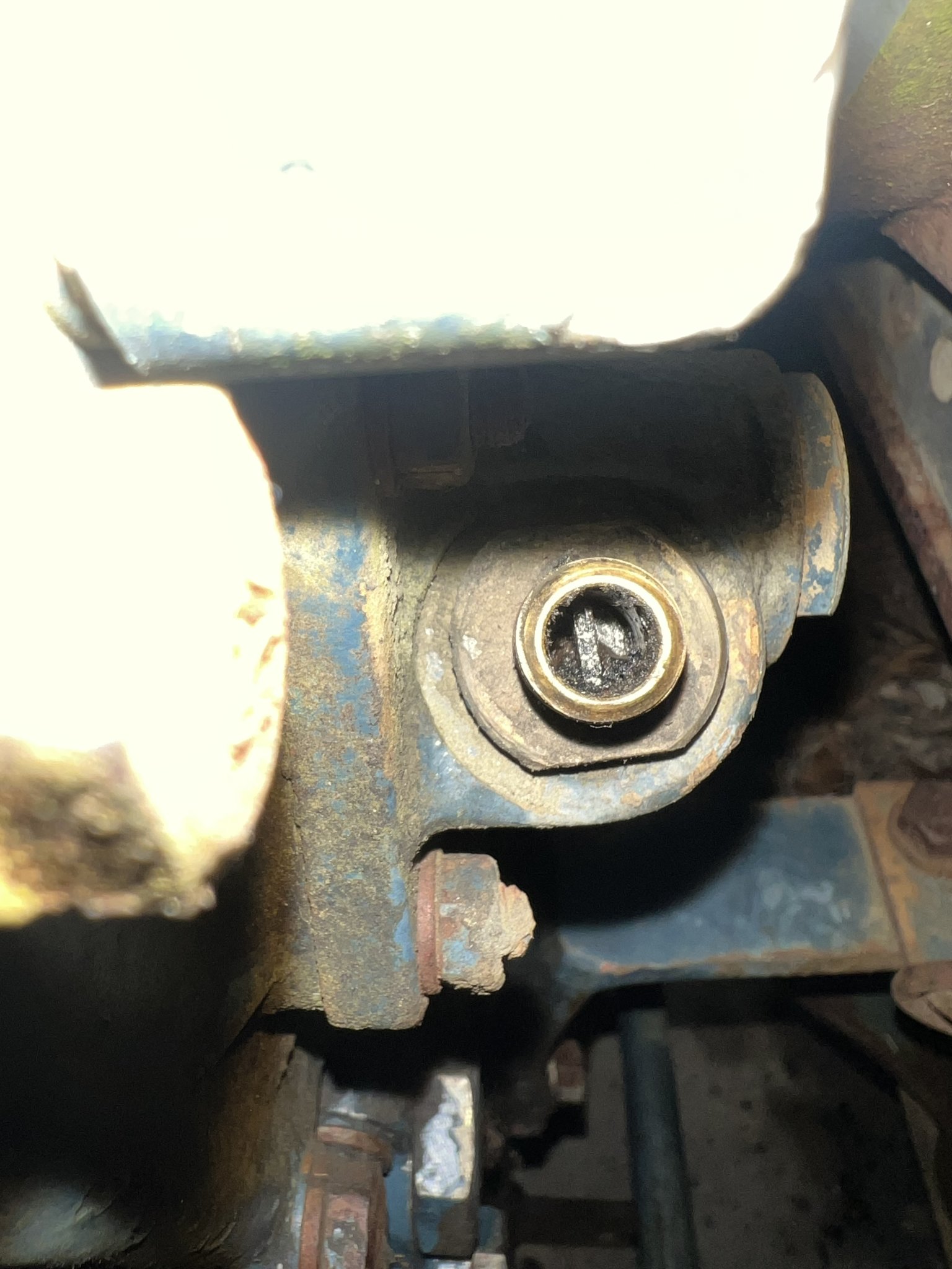

Did anyone order the part? Has anybody ever disassembled one to see if it can be repaired?
I’m not sure if mine works. I don’t see it visually spinning, but I’m not sure if that’s just the end of the cable that’s broken off in there. I didn’t wanna take it apart without checking with you guys. I’m not sure if bunch of oil comes out or what happens..
Photos worth 1000 words.. I usually always say pictures or it didn’t happen though.
Be sure to run your drill counterclockwise.. I can’t seem to post a video but it appears I get a reading about 1800 RPMs on the number two setting of my Dewalt drill
