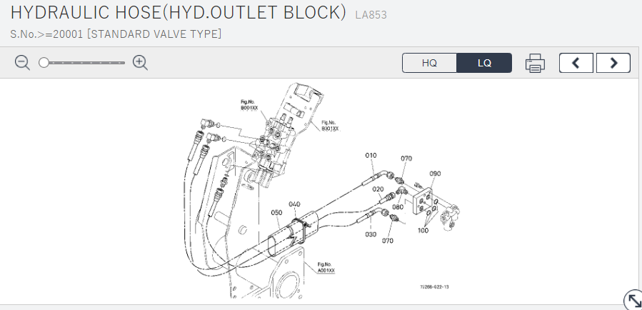

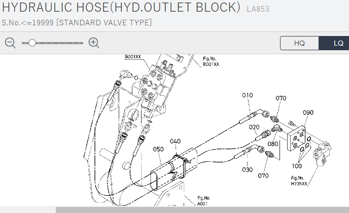

It a hydraulic line issue, and yes that will effect an GST.
GST's require an exact pressure to work properly.
So any variance in that will effect the transmission.
first thing to check is that all loader lines are in the proper location, there are two posible setups that vary by serial number.
Just follow the lines and make sure they are going to the proper location on the block.

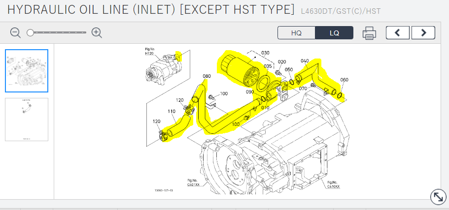

The next less likely issue could be the suction side of the system.
Look for wet spots.

If the PB and tank lines are swapped lines are swapped then the loader would work but anything after it won't, or as you stated. "I can raise the 3 point hitch while I'm tilting the bucket but it will only work while I'm tilting the bucket."
After rereading what you wrote on the first post I'm betting that's not the full issue.

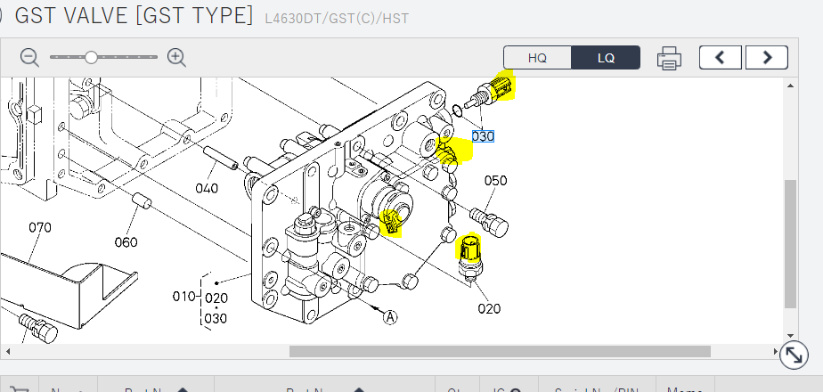

Sounds like the major issue is in the GST section, possibly he left a electrical plug disconnected on the right side of the transmission case.
Leaving the control disconnected would explain the erratic operation and non shift situation.
I think there are 4 connection on thee transmission case:

Give that man a cigar. You are a scholar and a gentleman sir. You were exactly right about the lines being switched. I looked and followed the diagram you sent and switched them around. Cranked it up and the 3 point hitch worked just like it should and so did the loader. The transmission still has issues though. As soon as you put it in gear the warning error 61 starts flashing. It basically won't shift on the fly. When you put it in gear then engage it in forward if it is in 2nd gear then you shift to 3rd or 4th or 5th it stays the same speed and doesn't shift it seems or it will just stop pulling all together like it's in neutral. To get it to change you have to stop shift into N release the clutch then press the clutch and shift into whatever gear you want i.e. 5th then your in 5th to stay you can't go up or down without repeating the same action or if you say try to start in 3rd and release the clutch it just sits there. It seems like it won't move until I push it all the way down to like 9th or 10th then it will take off, then I can stop it and it will let me shift it into a lower gear. I will check those connections tomorrow when I go back over to the farm. They probably are not connected or are connected wrong. I noticed he didn't put any of the wires back to where they go with the hangers. He just left them all hanging loose so I will have to fix all that as well. Thanks again for the help. I will check the wires tomorrow.

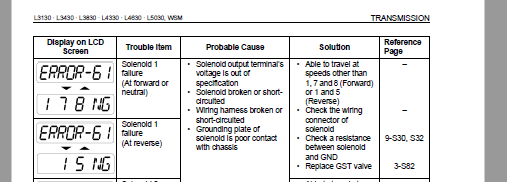

Here is what it says for error 61
My bet is on a connector not connected or damaged wiring.

OK well got the new alternator put on and it didn't fix the problems just my luck. Electrical is my weakest spot when it comes to working on things. It is throwing the first error 61 1 7 8 NG code which says solenoid 1 failure but I don't know what or which one is solenoid 1 and the solutions part doesn't make any sense to me. That seems like the problems I am having not the solutions. It says maybe replace the GST valve, that looks like the whole side of the transmission to me and looking it up is 3 thousand dollars from mesiks if I am looking at it right.
33,605
8,853
Read page 3-S47 in the WSM
It sounds like it might be your issue.

OK i finally got WSM and read all of that and went through the adjustments and it said ok to everything but still throwing the error 61 code. I checked the ground wire and looked for a short in the harness as best I could without pulling it all out and didn't see anything. The connector are all hooked up and look ok so I'm thinking solenoid. Does anyone have any experience with these? do they go bad often or is it rare? And can you just take that plate off and pop one out and put another one in or am I in over my head? Any input is appreciated thanks.
