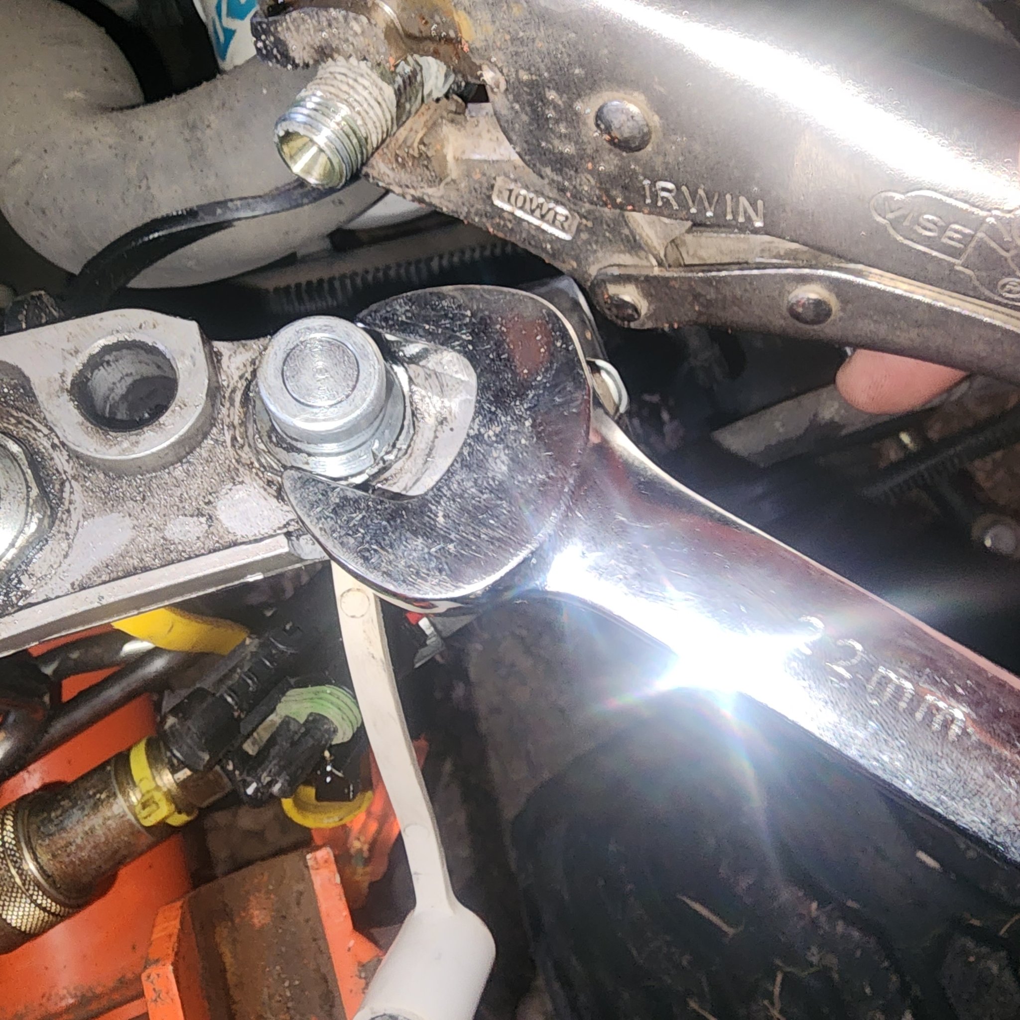

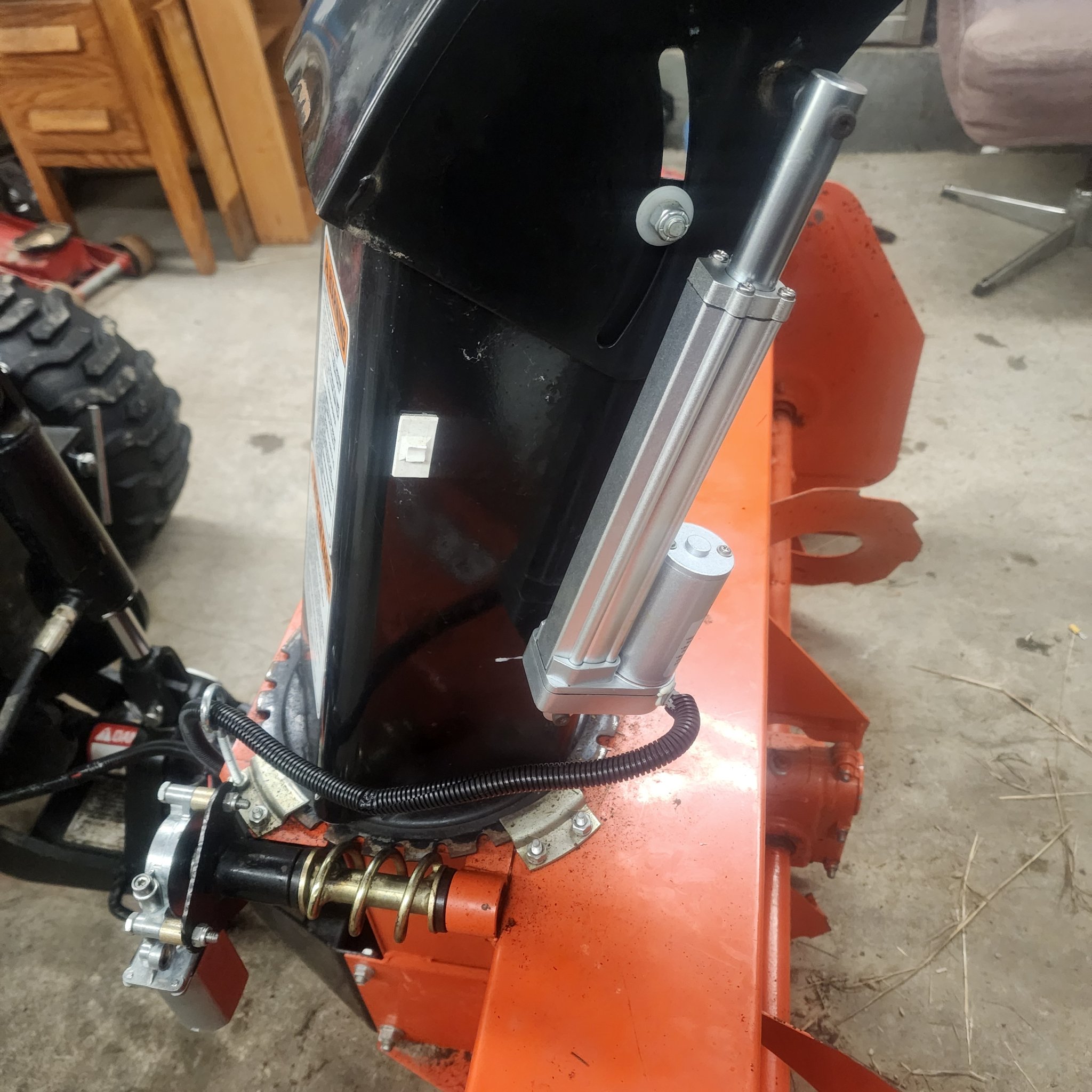

Could someone please give me a part # for these hydraulic fittings on this bank. I went to kubota dealer and they can't seem to find them. I need to change the fittings on hydraulic hoses for snowblower so that I can hook them up to that bank or manifold on the tractor. Thanks

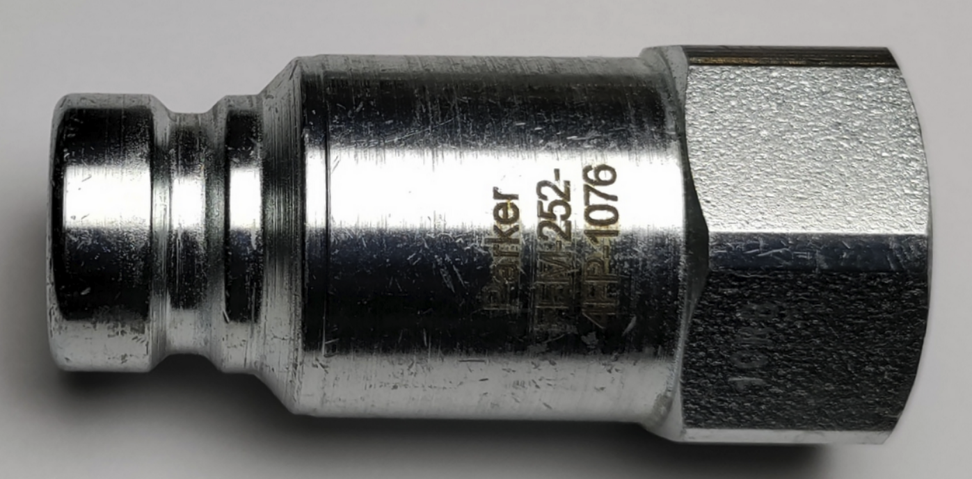

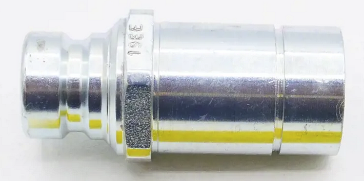

The part number for the male plug is 7J627-85290.
That just happens to look an awful a lot alike the end of a 7J627-66220 (aka Parker FEM-252-4FP).
The female coupler is 7J626-66320 (aka Parker FEM-251-4FP).
I just happen to be selling both the male and female Parker FEM flat face couplers/plugs on eBay as they're popular with the Chinese mini-excavator folks for their attachments if you're unable to locate these locally.

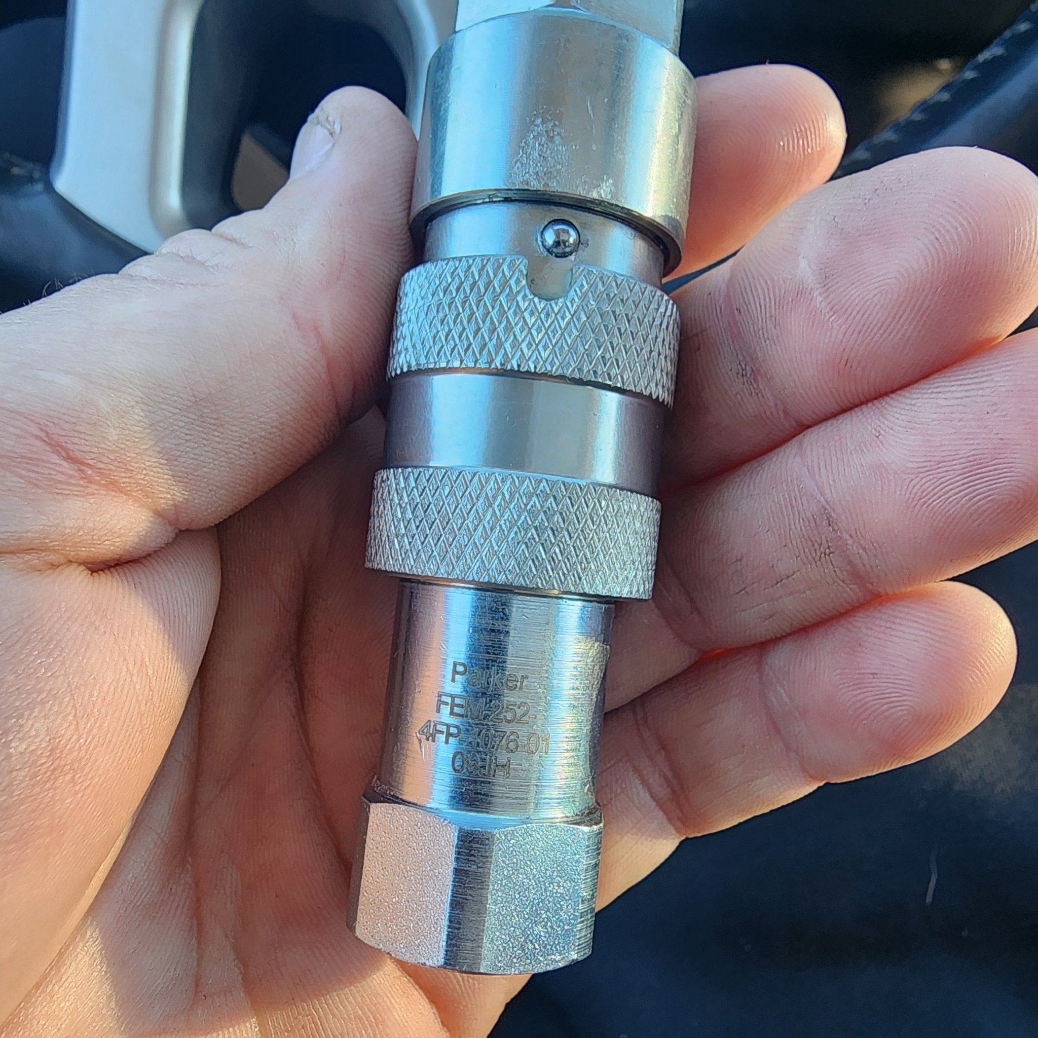

Looks are good, but...
Have you coupled the female parker to the male Kubota coupling?

Are you trying to use standard individual female couplers to connect hoses to the male tips on the outlet block?
