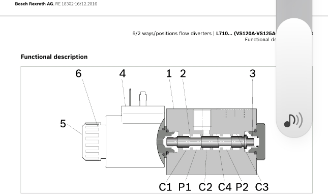

I thought the solenoid was the electrical actuator of the valve? I thought you would still hear "clicking" of the solenoid even if the valve was gummed up or jammed by debris or whatever???
Heres a section view. The spool goes into the center opening in the coil where it is magnetically shifted. Taken together they constitute a solenoid.
Remove the coil and you can remove the spool. I think your problem is purely electrical. Bad coil or bad connection

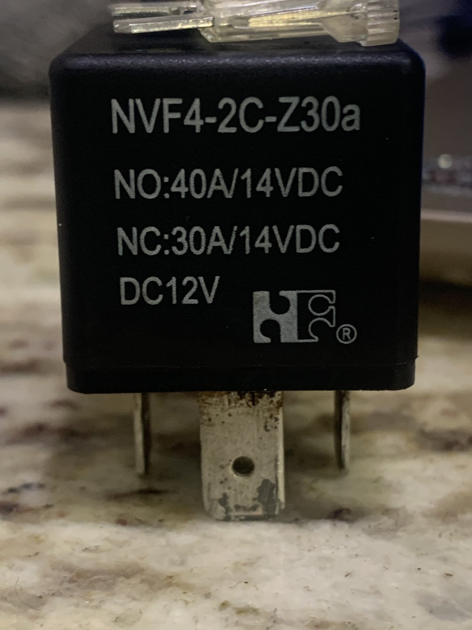

What is the question?

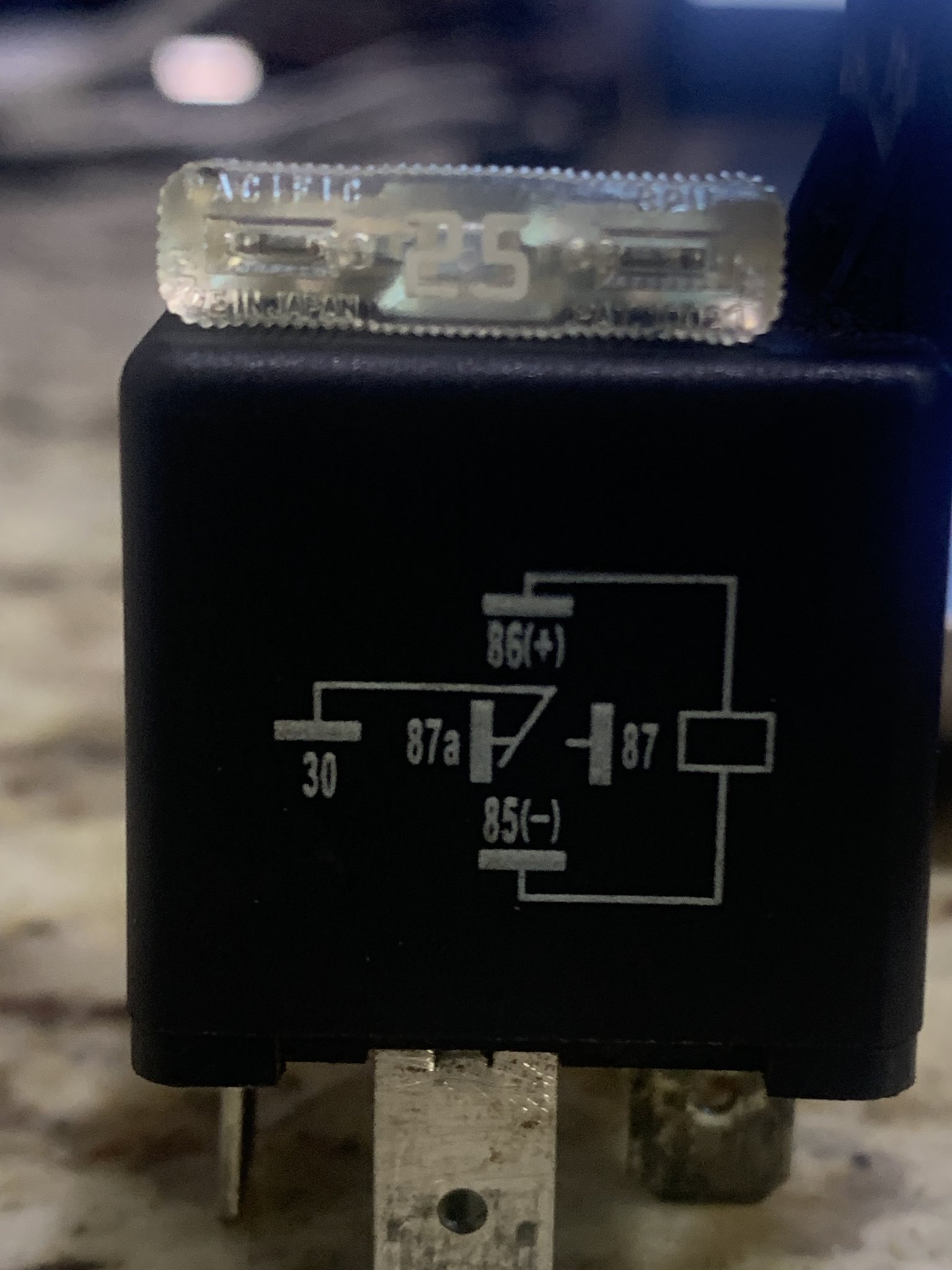

no question......just posting my Relay. Well now that I got you here :LOL: what's the difference between the 87a and 87 terminal? I assume, based off of the relay info on front that it provides 40 amps switched and 30 amps not maybe??? ikd...just guessing.

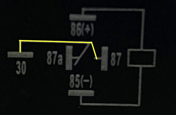

87A is the normally closed contact.
87 is the normally open contact.
Power for the device (light, motor, etc...) is supplied to terminal 30 and either goes to 87A or 87 out to the device.
When the relay is not energized, power is routed to 87A (normally closed, aka N.C.)
When the relay is energized, power is routed to 87 (normally open, aka N.O.)
86 is the positive side of the relay coil.
85 is the negative side of the relay coil.

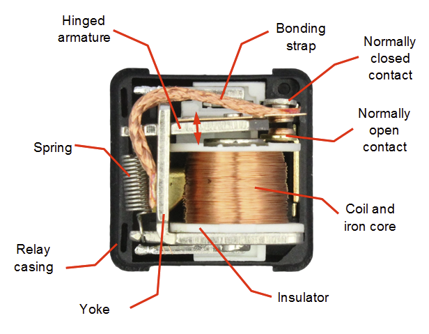

The relay coil is what deflects the internal armature when energized.
Relays are consumable and do fail. The better quality ones and appropriately sized ones last longer than the cheaper ones.
