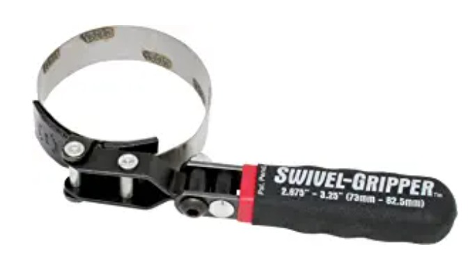

I had the same problem a while back - I started with a piece of sandpaper inside the strap for grip - then I found a device that uses grit INSIDE the strap - bought it and it works very well.
One still might need a cheater bar too!
https://www.amazon.com/Lisle-57020-...fix=oil+filter+strap+with+grip,aps,59&sr=8-25
https://www.amazon.com/Lisle-57020-Filter-Swivel-Wrench/dp/B003969PKS/ref=sr_1_25?crid=N6T098QVVGIX&keywords=oil+filter+strap+with+grip&qid=1664999073&sprefix=oil+filter+strap+with+grip,aps,59&sr=8-25
I used one like this and almost destroyed it with a cheater bar :>(

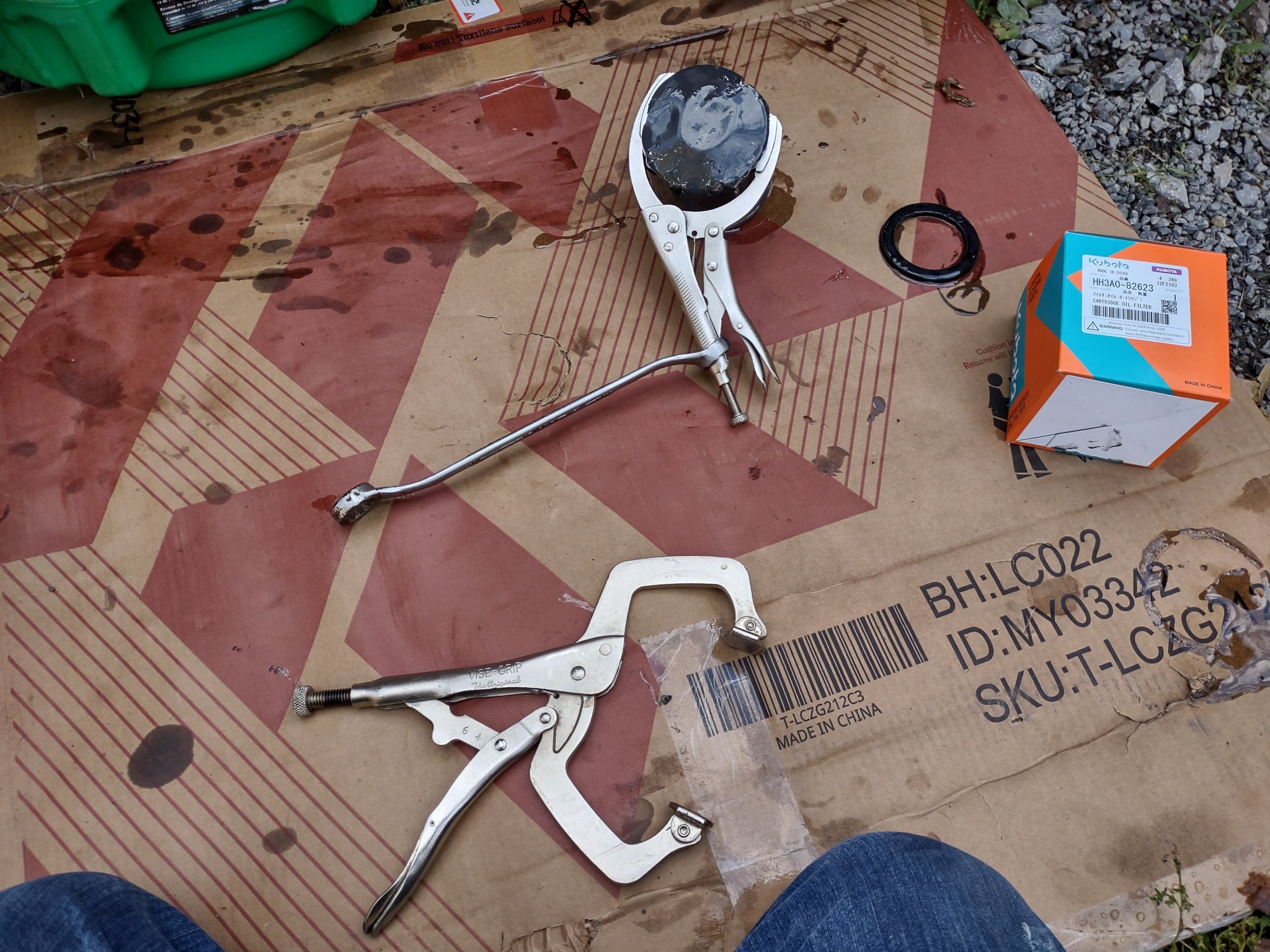

That Hydraulic filter is just plain nasty. I have read and watched everything on this stuck filter and thought I was ready for my battle with the 50 hour break in maintenance... I was not. After breaking a three prong Amazon filter wrench, a strap wrench I found the magic combo for me. I mangled the filter before success, losing about 8 quarts in the process of an overnight leak from the mangled filter. You should only lose a few quarts if you change both filters quickly.
I don't believe the painting over the filter at the factory theory now that I have completed this trip to maintenance hell. It's just that Hydraulic filter is a super stressed, pressure filter. My magic combo for success was a vise grip style filter wrench with box wrench cheater. I first broke it loose (about 3/8" movement) with the large visegrip clamp seen in the photo. Good luck.

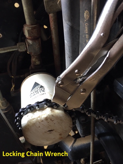

Like Motion said. Chain wrench.
