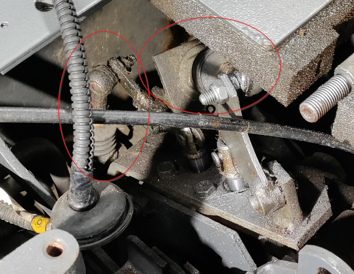

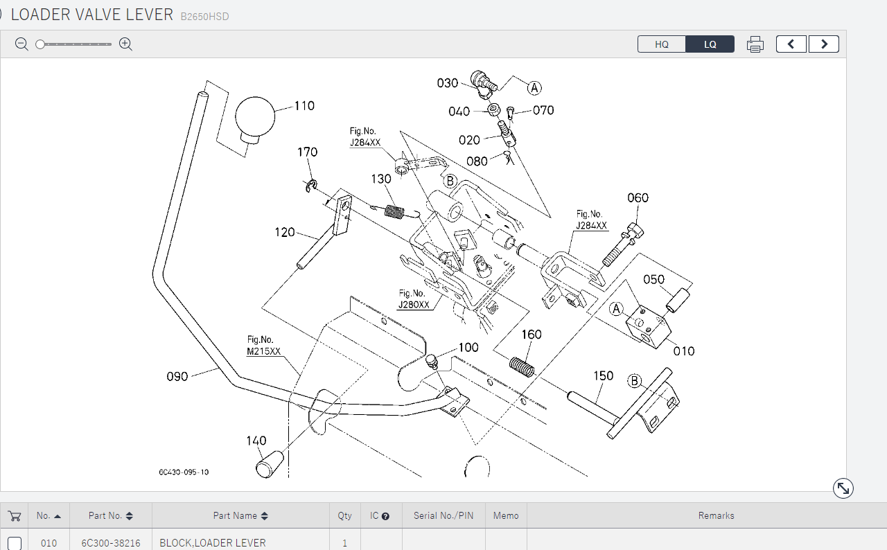

This is what your looking at:

Thanks for your help! Yes I saw that. May be a bit over my head. Local Kubota dealer is 3-4 weeks out and we are expecting 2-3 feet snow next week.
29,111
5,404
Most commonly what happens is the linkage loses a pin.
Get a look at it and take some pictures.

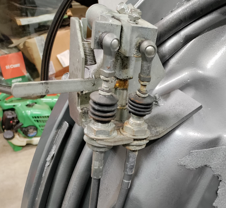

B2650. My joystick is broke and won’t raise or lower the front end blower. Can and how do I lower the blower without the joystick?
thanks!
Cab or non-cab? They use completely different loader control setups. The cab version uses cables. If that's the case, perhaps the nut fell off the ball stud.
4,769
1,044
