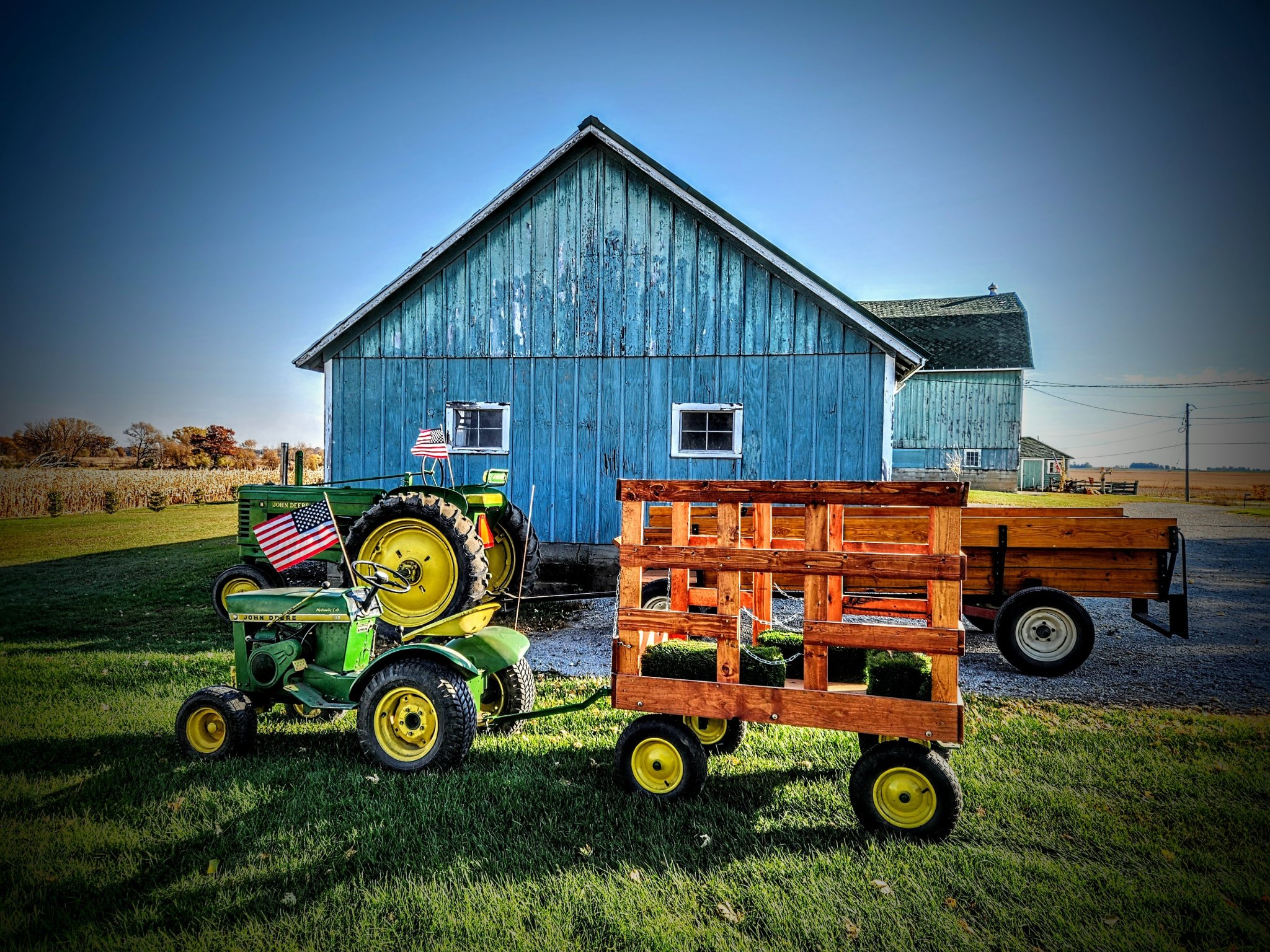

Foxrun, thanks. Great photos you share as always…if I ever need to do a centerfold layout across the hood of one of my orange monsters, if anyone can find the best lighting for a glamour shot for when I go back to modeling / dancing for cash 😉 you get the job…seriously, really great photos with the light, color and contrast that you share.
Have you ever tried your orange monster pulling one from drawbar? How did it do?

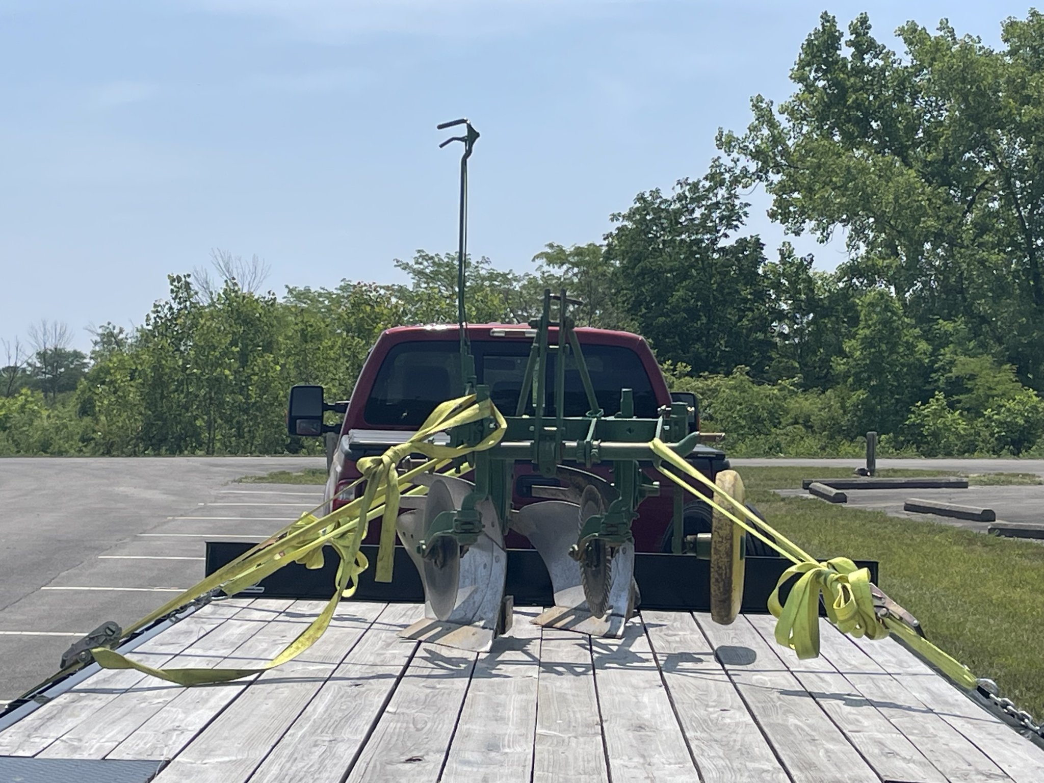

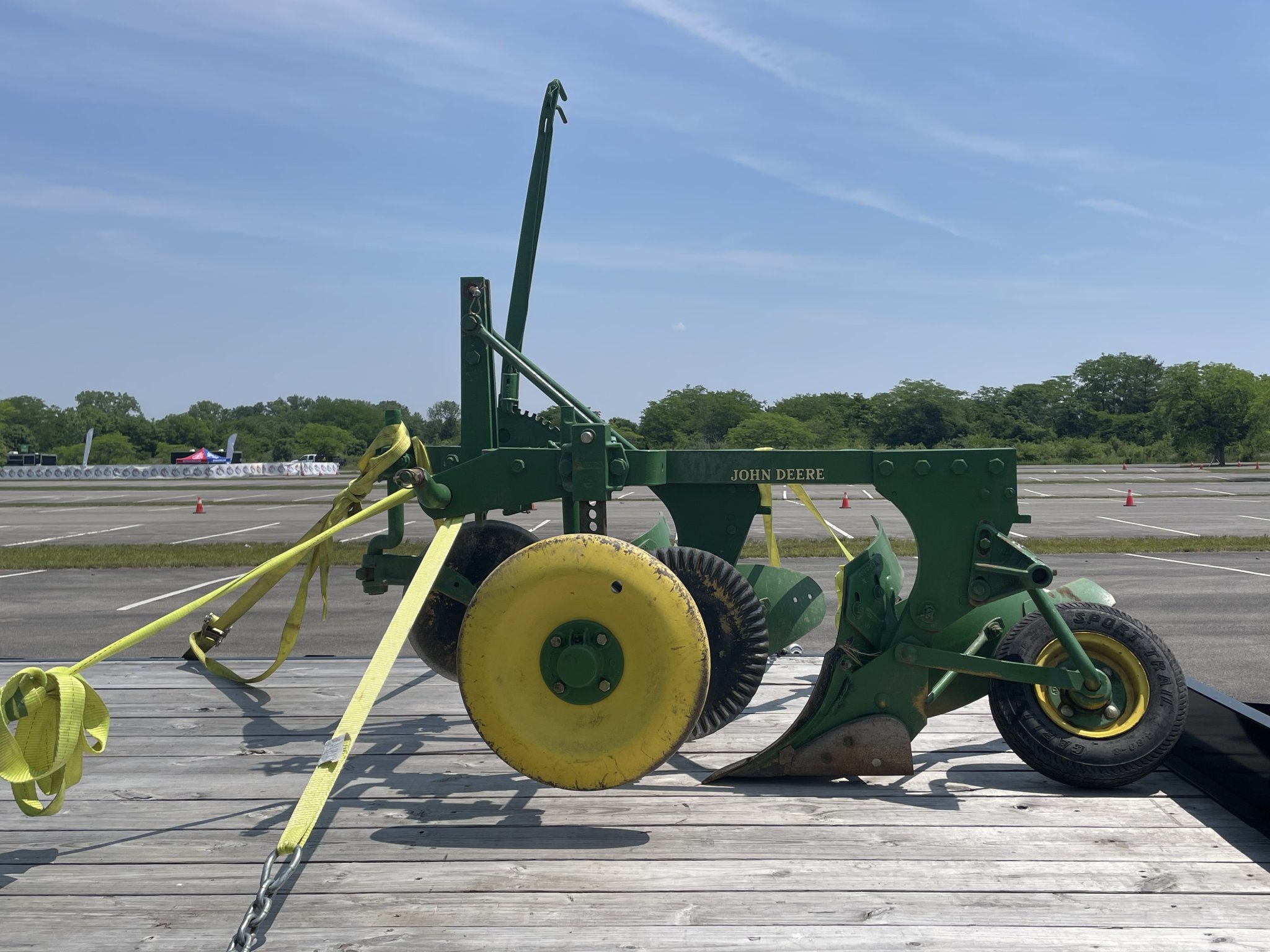

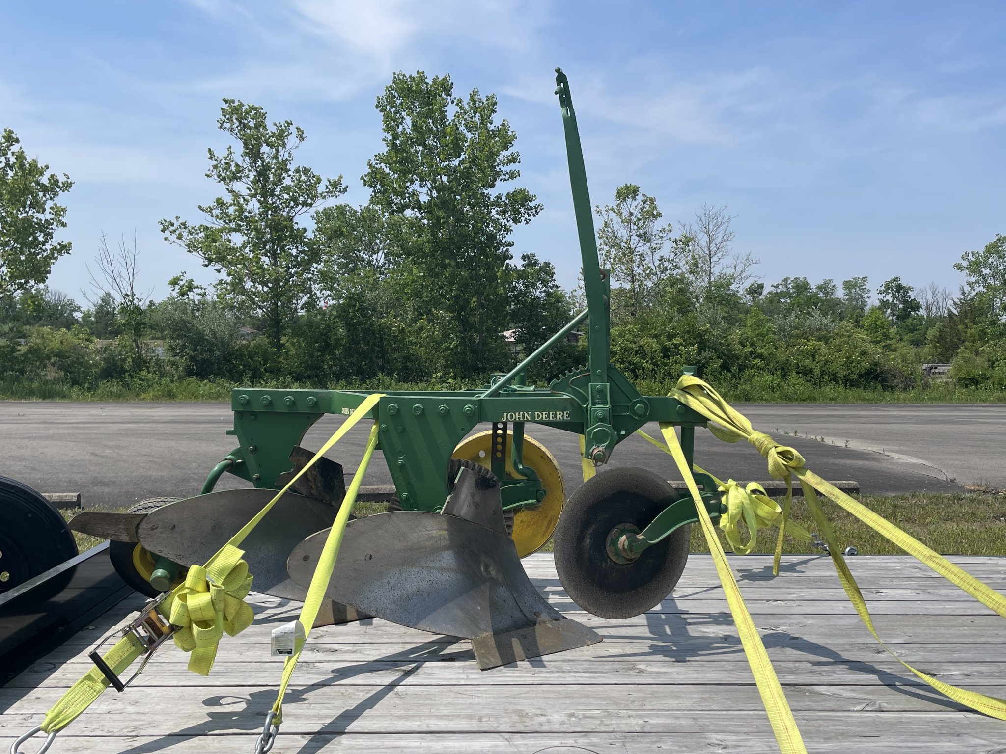

Picked up a hitch hiker this morning…I feel a little dirty and ashamed on the color though.😉.
That's awesome! Is it a 2x14 or 2x16? Also, what year do you think it was made? Really looking forward to seeing how you get along with it behind the MX.
GrumpyFarmer
3,164
4,334
Thanks. It’s a 2x14. I am not really sure how to tell the age…any ideas? Please advise.
It seemed to me like it’s in pretty good shape and seems to be in working order…however, the depth guage wheel(see the side view pic)…I’ve not seen a rim like that but I am not sure it’s fine as is or should have a tire on it? It almost looks to me like there is a valve stem hole in the rim, but I don’t see how a bead would seat to it? But it appears to have a hole for a valve stem? If anyone knows please advise.
it also appears to be a cat 2. I’ll be shocked if my QH20 fits it(I did not measure the spread yet).

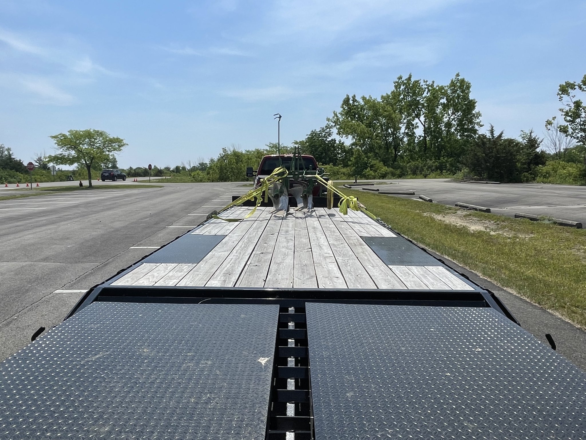

Why didn't you just toss the plow into the truck bed ? Seems like overkill to haul the HUGE trailer !
I am not sure you are serious or not…I am not sure why would anyone put that in the back of a Truck if they have a capable trailer and are capable to drive / back it….are you serious? I’ve pulled and backed trailers for years…it’s really not an issue for me. I would not consider That trailer very big at all. It’s a lot easier and less likely to damage the trucks folding tonneau cover if the plow is on the trailer…It’s easier to secure it to a trailer…it’s going to sit on that trailer till I take it up to the place up north so it reduces handling. And most importantly it’s what I decided to do with my truck and trailer. 🥶
But think of the MPG…. Greta is gonna be pissed!

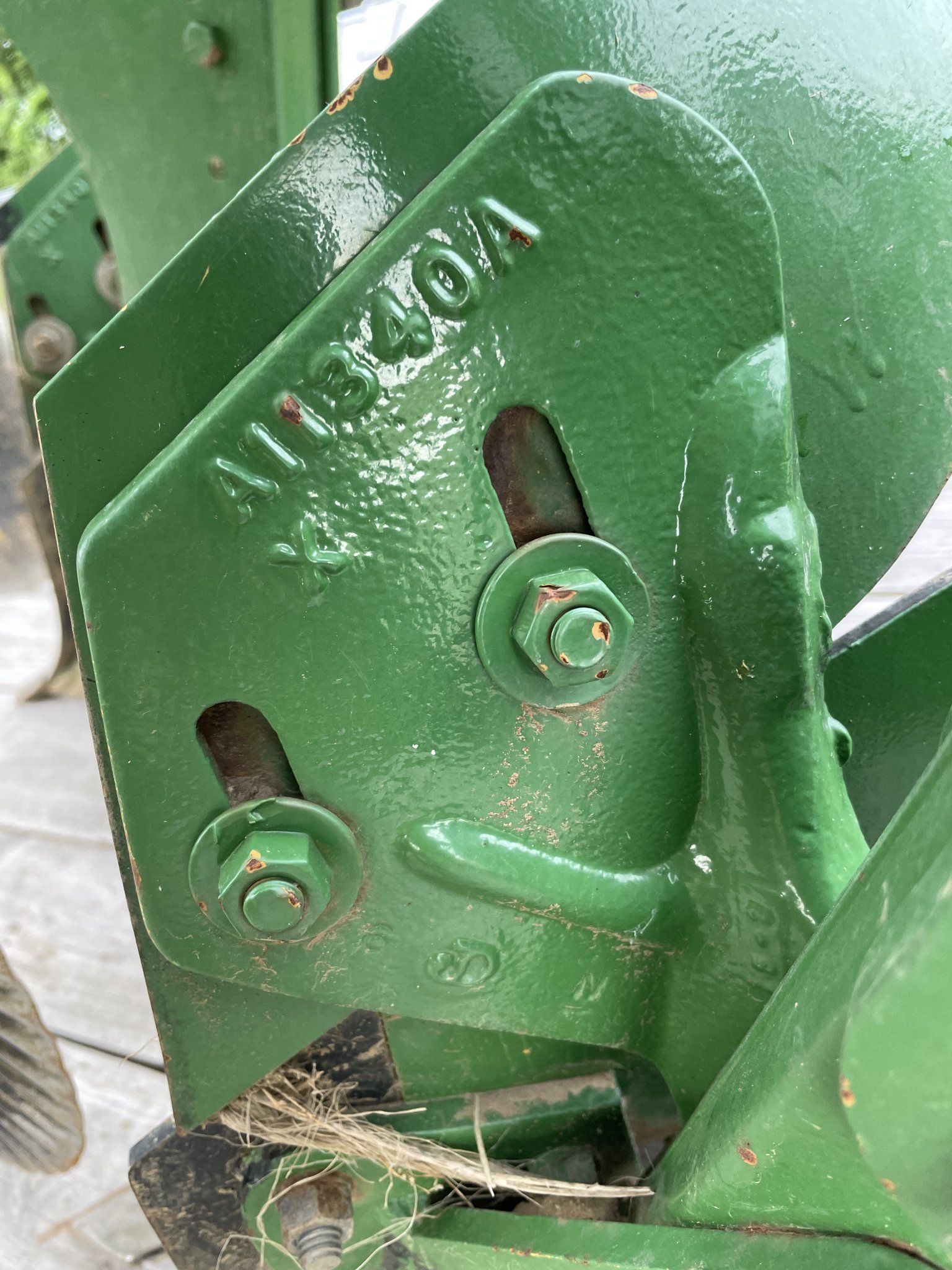

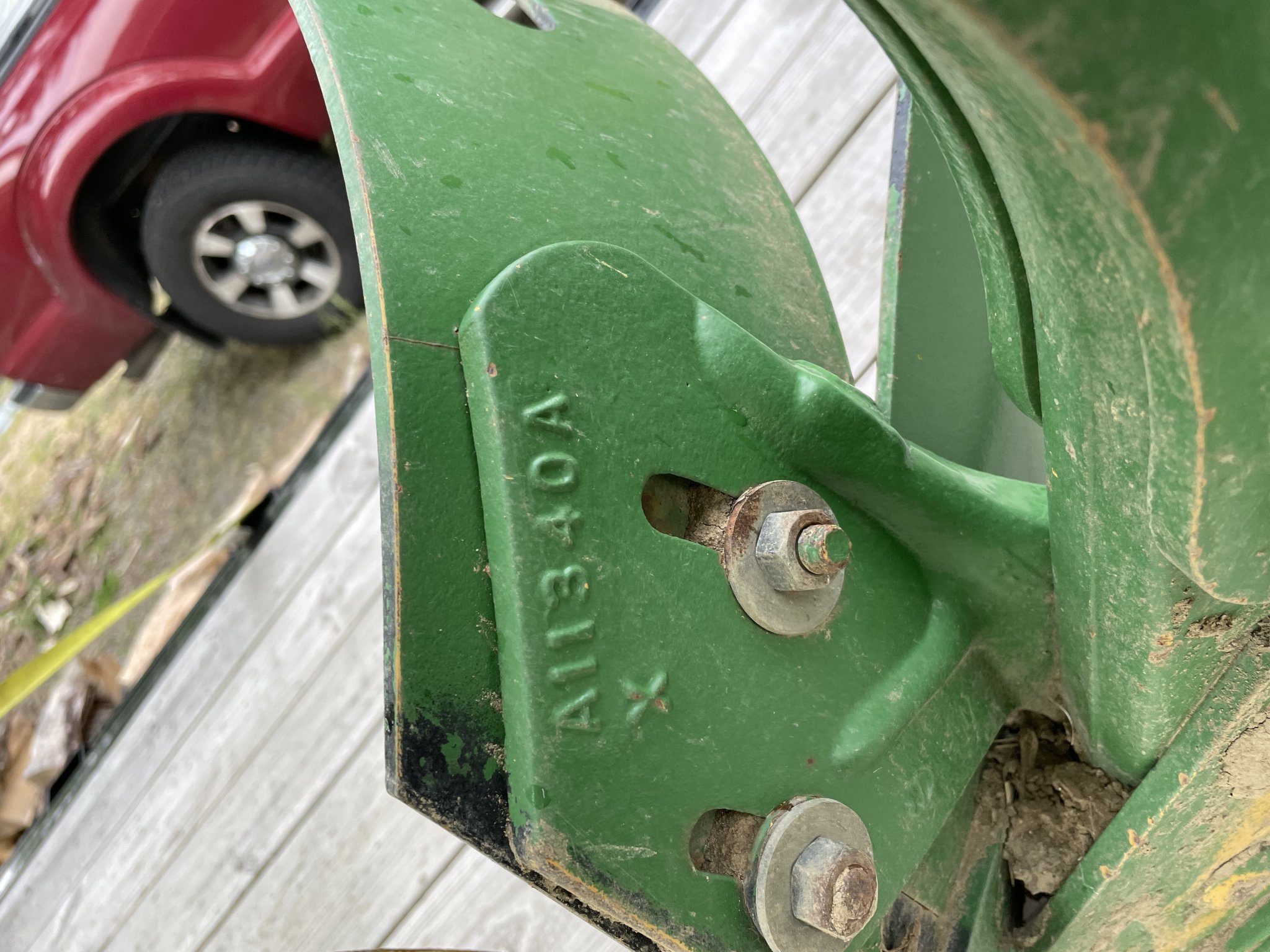

Nice score! I'm a bit jealous. Even though my ih planter goes with the plow nice and is patriotic colors. Look around on the beams and look for stamped numbers. And type them in on Google. That's how I found info on my plow.
GrumpyFarmer
3,164
4,334
Thanks. From what I have read I sort of think it is an 812(but I don’t know that to be true)…I haven’t actually found any JD publication / print that specifies it. The numbers I can find on it are in the pics below. Please advise.

Thanks. I’ve looked through there and lots of info…I am still not certain what I have…I can’t find it stated in JD publication (yet), but from what I can sort of decipher is the 4XX series were Cat 1 and the 8XX cat 2…but I don’t know that to be true….and maybe that was the series? Then the actual model maybe just maybe the last digit indicates the number of bottoms…ie. 812 is 810 series and 2 bottoms. Like wise the 813 is 3 bottoms, 814 is 4 bottoms…seems like the same applies for the 400 series. Beyond that seems like there were several options / variations but I have not deciphered those codes….so bottom line is I am not sure. If anyone knows what I am piecing together please advise with some facts.
I order a parts manual for the series that I think it belongs to and hope that will help narrow it down.
