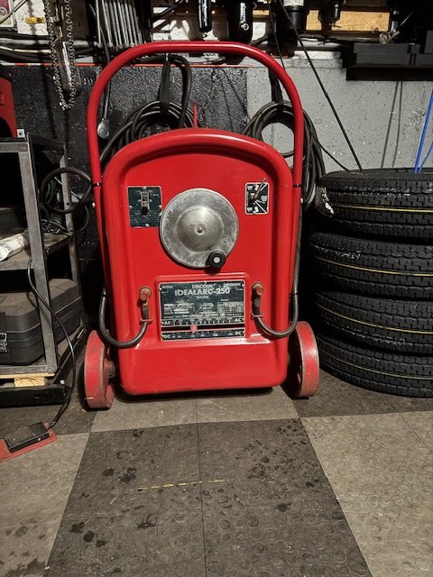

My 1961 Lincoln IdealArc 250 AC/DC will blow your mind. It's like melting butter.
night & day ... no comparison to the AC225

. View attachment 143935
Well said. Those Idealarc 250 welders are great solid welders. Laid down a lot of beads with one of those. We had one on the farm. Later on added a Lincoln welder generator to take in the fields to weld and have electricity. Also used it as a generator many times.
