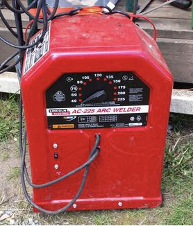

So, when I bought my house, I didn’t get the shop I wanted.
I am now thinking a generator would might make more sense for those occasional welding tasks, than paying an electrician to pull wire out to the shop.
The welder is a run of the mill Lincoln 220.
I would look for a used Bobcat/trailblazer or if you like Red, A lincoln Ranger...
all good machines and portable. build a sled and throw it in the truck or put it on a wagon and drag it wherever you want.

another thought...
By the time you buy a 12-15k generator for that little buzzbox you could have bought an engine drive welder.
AC-225 is a good starter machine but at the end of the day, it's a cheap buzz box.
sell it for $150.00 and put the cash towards something else.
my $0.02

My 'cheap' AC225 was $250 back in 1987, less than the cost for a guy to weld up a flat deck for my F100. Since then have built 20+ trailer, countless repairs to farm stuff, countless rider mower decks repaired. Big or small, it does it all. The ONLY cost in 30+ years has been to replace the AMPS switch ( $50) , about 10 years ago.
So it has been 'cheap'... ,er, economical, a GREAT buy....
