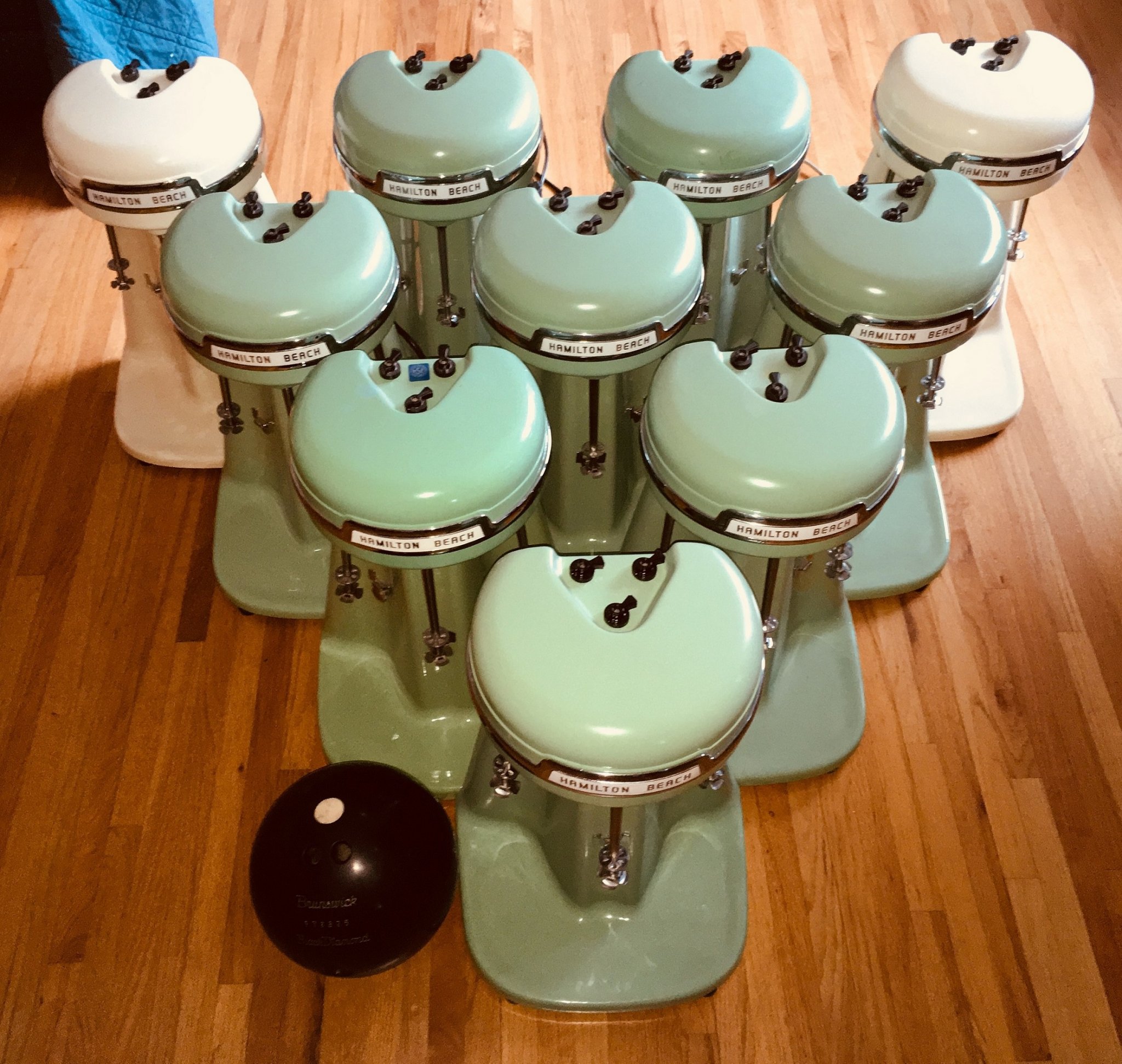

I have a sweet tooth and a fondness for the old malt shoppe malt mixers. Been completely tearing them down and restoring them for a number of years ever since one of our boys wanted one and talked me into restoring one for his birthday. The internet is a great tool in finding supposedly non existent parts or an alternate replacement. It's now turned into a winter time hobby (sickness?). Some are given to nephews and nieces, and a few have been sold. Unlike today's appliances, these were built to be serviced and could last for who knows how long.
As good as a regular malt is on a hot day....... I discovered adding a little Kahlua or other adult flavoring of your choice really makes a tasty fine "Adult Milkshake"! We've restricted the use of the malt machine to only when we have company to help keep some room between myself and the front of the kubota steering wheel. (Even though it does have a tilt wheel!)
Been thinking of posting to your "What's Cooking" thread but this one seemed just as appropriate. Maybe I should put together a "How To" project in the "Off Topic" forum.
View attachment 63152 View attachment 63153
Anybody is welcome to stop on by for a tasty treat!!
David
Those are wayyyy cool!

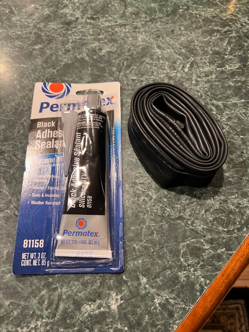

Might use Permatex 81158 silicone adhesive sealant. It's good adhesive quality and flexible.
Looked up the properties and looks like a great choice. Thanks for the tip!
I’m sure I can make a big mess with it…..😉. I always failed Cut & Paste in school…..
Realized no bike inner tubes left, so we’ll sacrifice a brand new $5 one. Pretty light weight, so that’s good. Want a pliable patch especially exposed like it will be.
Will take some time to clean and dry. Have the patch kit ready.

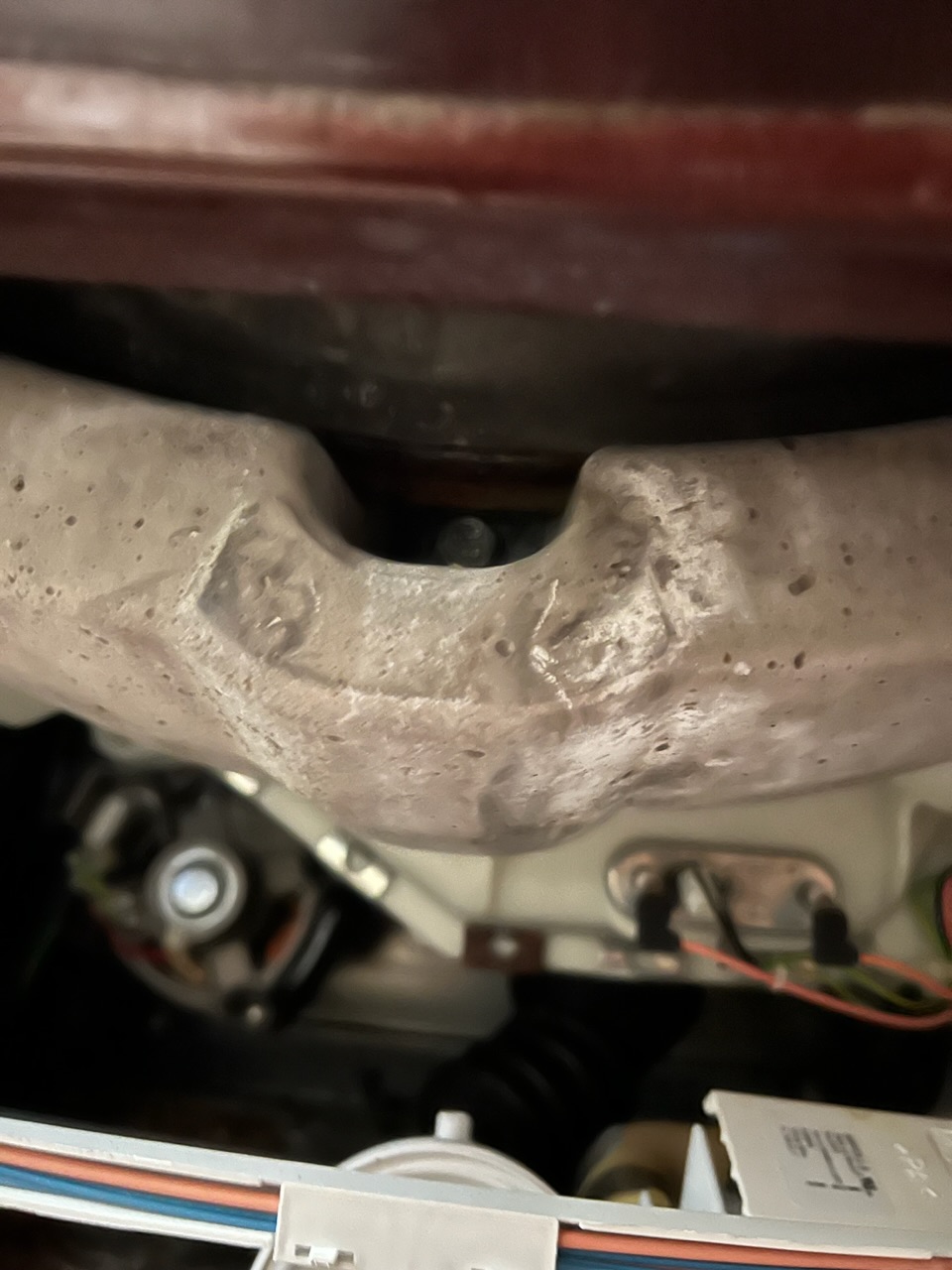

Our last washing machine died a premature death due to the spider (3 arms that hold the drum) corroding away. Aluminium + detergent = aluminium oxide. Was not available as a separate part from Whirlpool, just the entire drum assembly, 3/4 the cost of a new machine.
I bought a Maytag "Commercial Grade" as a replacement. Spider available separately, 10 year warranty on the motor, etc. Before putting it in service, I disassembled it, sanded, primed and coated the spider.
10 years and 2 months later the motor control board started to fail. No longer available from Maytag (now owned by Whirlpool, hmmm, is there a pattern here?). I tracked down the board's manufacturer, but they won't sell me one either -- contractually prohibited by Whirlpool.
I'll spare you the diagnostic details, but I traced the problem to a failing 24 pin MOSFET 3phase controller chip on the board. Whirlpool couldn't prevent the chip manufacturer from selling me one so I replaced it and all is good.
Oh, and the spider? Still going strong. But now no longer available as a separate part -- only the entire drum assembly. Thanks, Whirlpool.

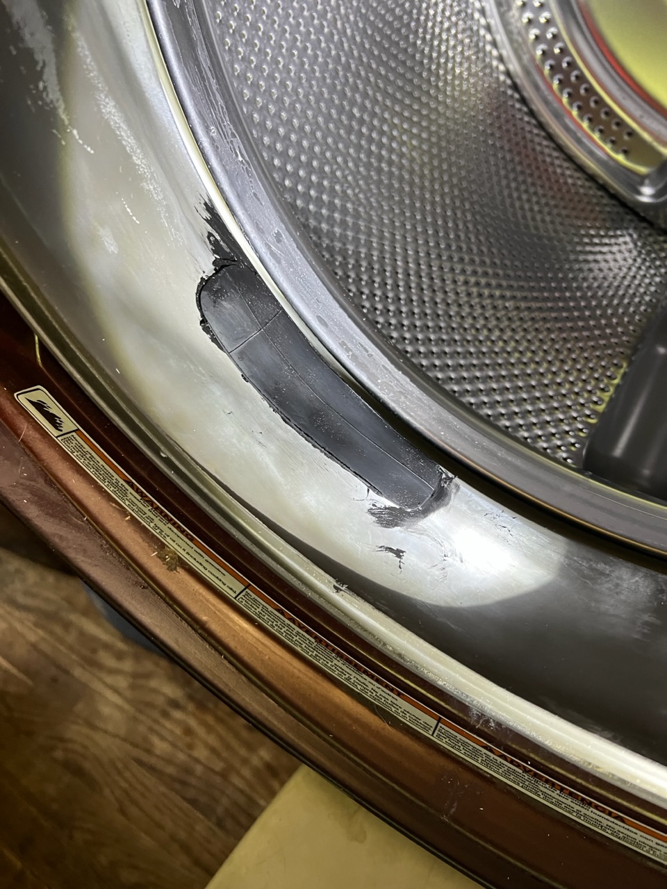

Got a patch on. Seems like good contact. The Permatex 81158 D2Cat recommended appears a great choice. Piece of patch looks to adhered very well to the bellow seal all the way to the edges of the patch.
I made much less mess than anticipated! 😝 The Mrs. wasn't home either.....
If I still had a inner tube kicking around, would have only been $10 for the adhesive. Tube cost me $5.
I'll take$15 over $200 to try a redneck temporary fix..
If it works, great! If not I'm out a few bucks and a little time. ;)

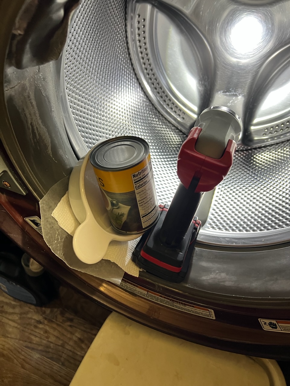

After about 30 minutes and surface wasn’t tacky, added some weight very scientifically for curing. There’s some waxed paper under the bowl. Seems to help.

Put a load in the washer.
It’s not leaking so far. The drips were right at the front and bottom of the tub.
Like to thank D2Cat for the Permatex 81168 recommendation. That was key.
The patch seems solidly bonded to the bellow. Water resistant/proof and wide temperature range.

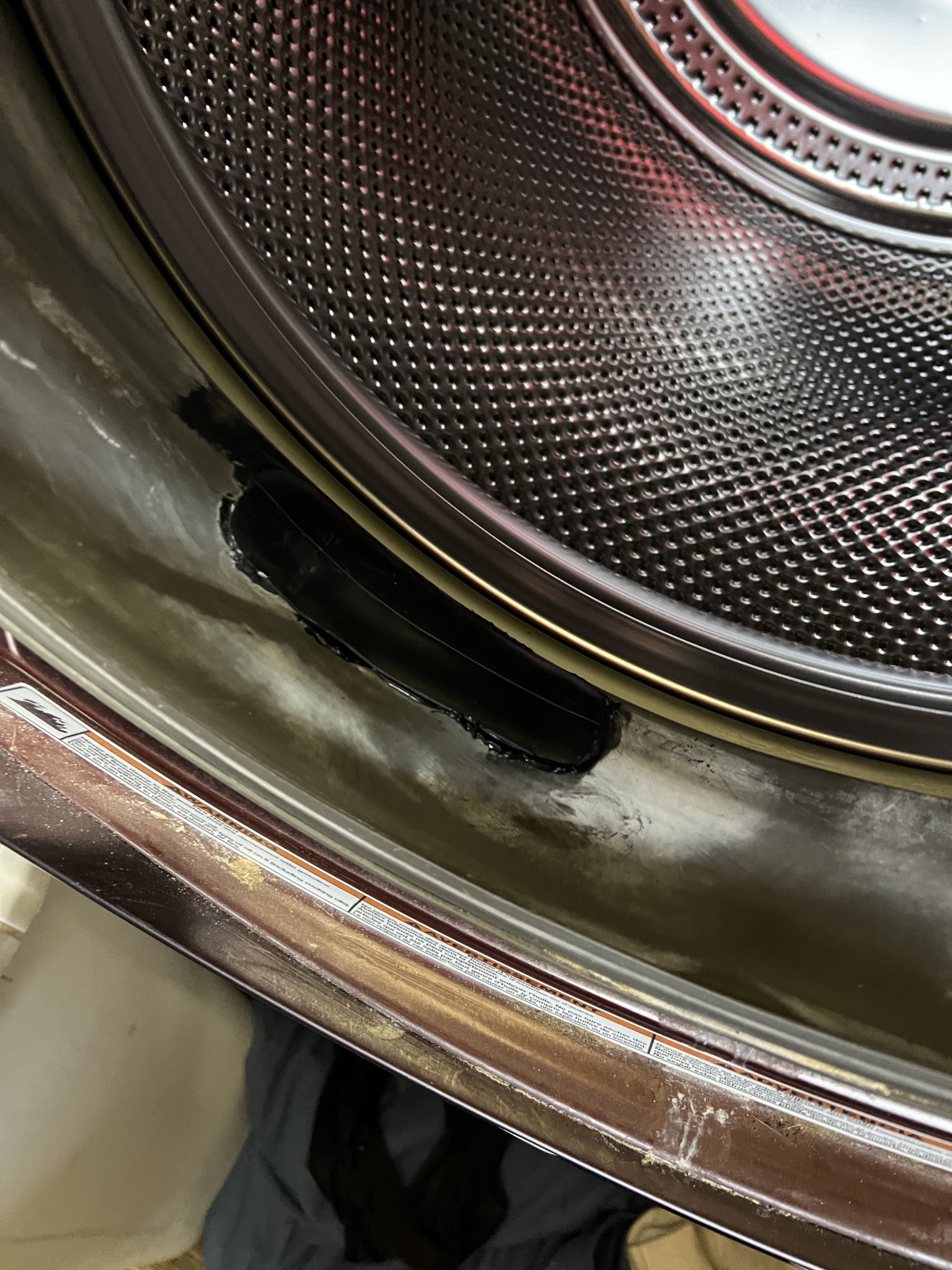

Wouldn’t you know my patch on the washer peeled up today……darn it (not my words🤬🤬!!).
Smooged more adhesive and hoping it sticks…..has held very well. Looks like I might have made the sealant too thin.
Get us through another 4-6 weeks…..please….🥺🥺
