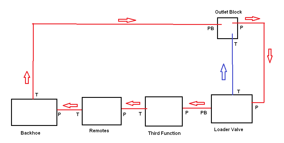

Hooking up third function, rear remotes, and a backhoe line.

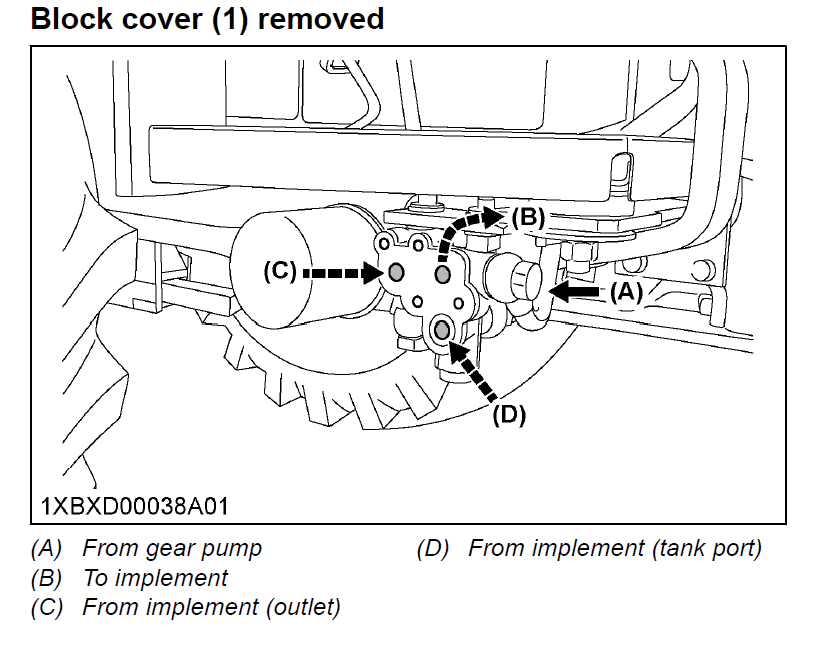

So the P is (B), T is (D), and PB is (C)?

Help! I just tried hooking up the backhoe since I routed it the way you showed and as soon as I hook it up and start the tractor its like the pump is working and the backhoe has zero function, it even takes away some loader movement.
You crossed something in the plumbing. Or perhaps one of yoir remotes is not in neutral. Sounds like you have the neutral circuit blocked.

Routing is correct according to your diagram, I've looked it over many times now, how would I know which remote isn't neutral?
That was just one possibilty. Disconnect the back hoe and loop the tractor side hoses together. You may not have the backhoe couplers fully connected. Happens pretty frequently.

When I reconnect the couplers on the tractor it works fine, as soon as I hook up the hoe it acts up
You have found the problem and its not your new plumbing.
What that tells you is there is no neutral flow through the backhoe valve. Make sure ALL of the backhoe valves are in neutral.

One though I do have is why did it work with the previous routing
This failure has nothing to do with the routing.
With the hoe disconnected everything else works.
With the hoe connected nothing works including ths hoe.
The circuit through the hoe is the problem and thats either a spool out of position or a coupler thats not fully connected.

Ayak, your question provoked thought, while I don't have the bh77 but rather a bradco 609, I still went ahead and swapped connectors on the hoe and BAM! It all works now. Dan, thanks for hanging in there with me! Routing is right, connectors were swapped on the hoe, that's probably why it worked with my first Routing. Thank you both!

Here is the outlet block on your tractor.
Here is the proper plumbing with ports and flow paths labeled.
[EDIT] I just read the Kubota service bulletin that someone posted a link to. My understanding is that the o-rings in this specific application (i.e. the tank port of the BH) aren't designed to be back pressured and will cause leaks when connected using OP's design.

Question: What does the PB port on the outlet block do? I'm asking because it seems like it would be for powering some downstream implement. In which case, doesn't the backhoe's tank port still see a pressure every time that implement is used? I'm trying to get a better understand of what the design rule is.
