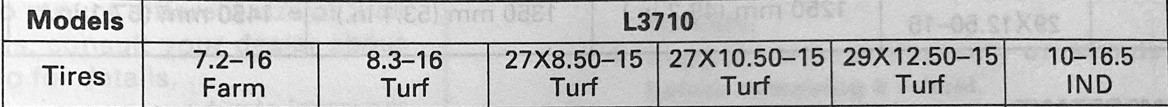

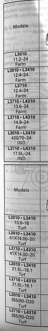

What size and type tiers to you have on the front and rear? See attached for what Kubota would have available from the factory.
