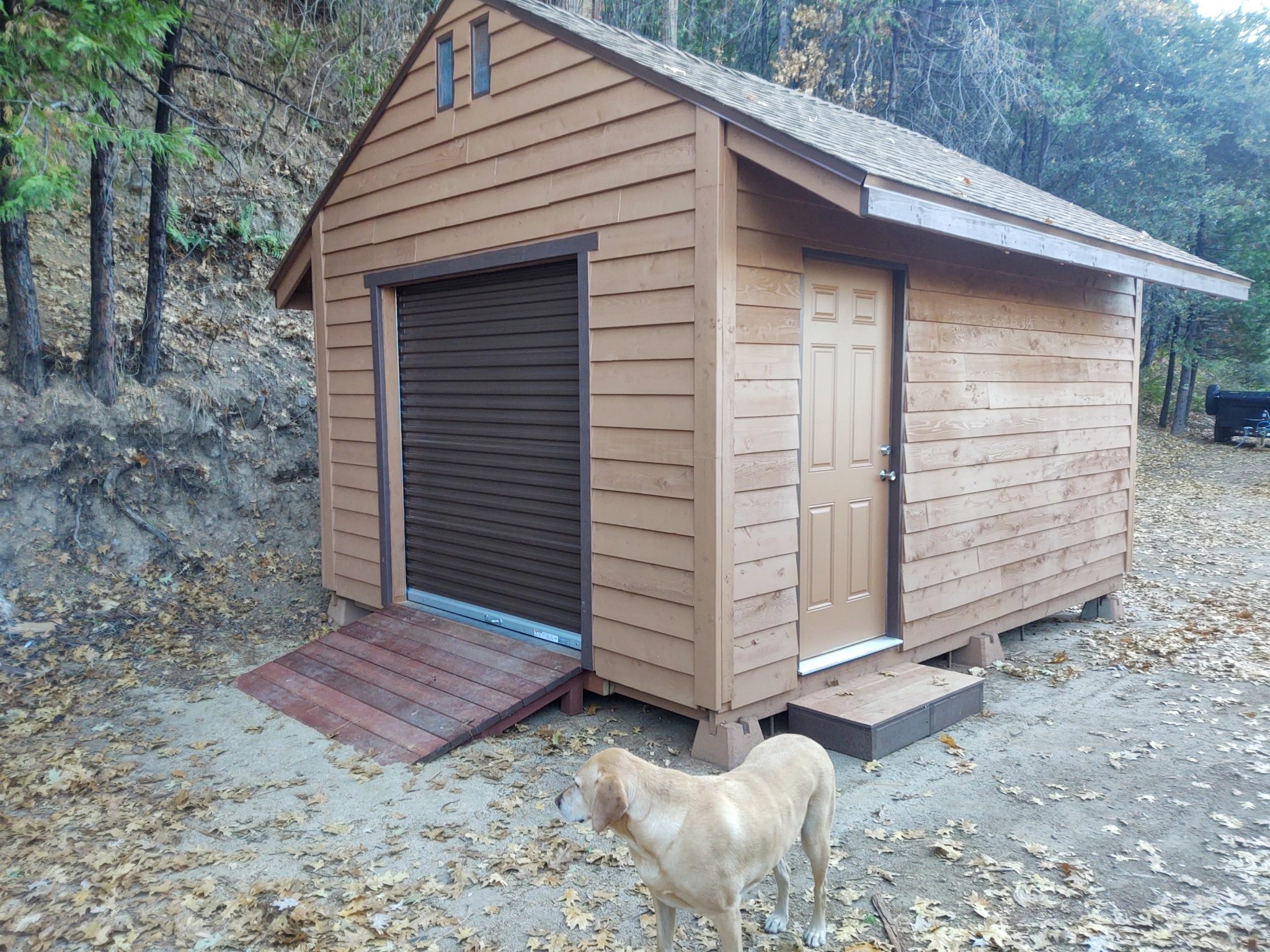

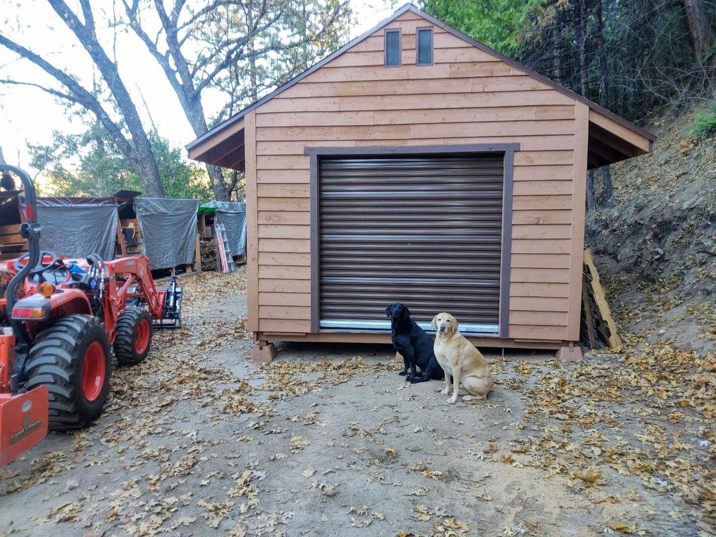

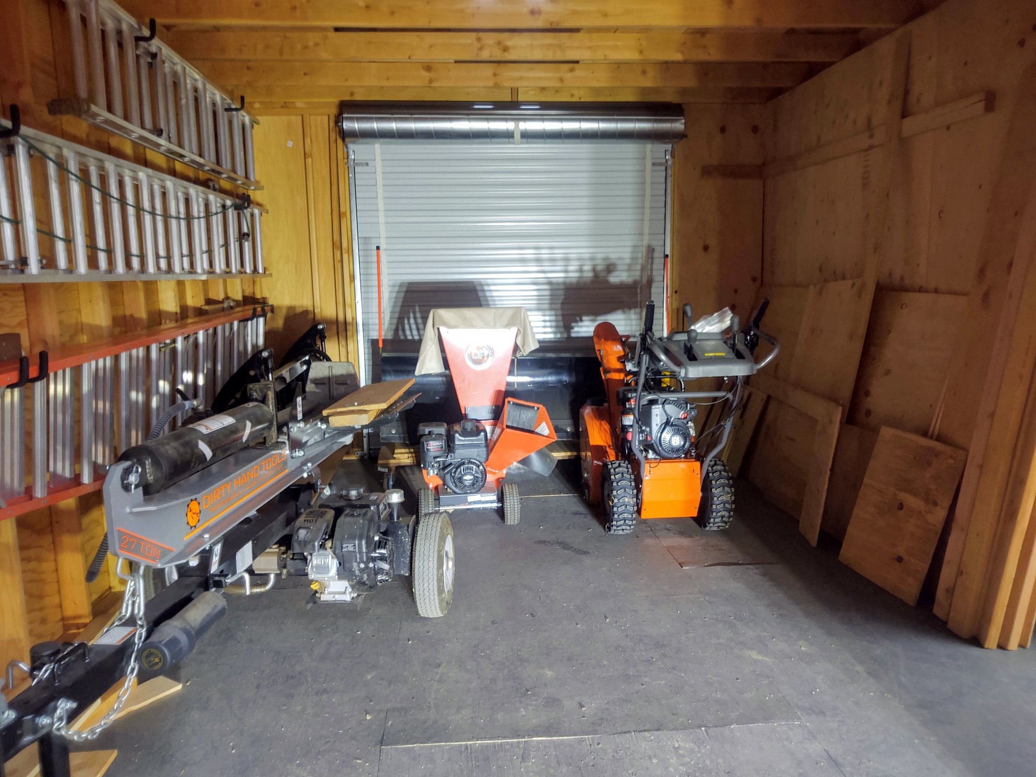

I built a 12X16 shed last year, it was to free up room in my shop. I keep my implements, snow blade, grapple. Ladders, log splitter, chipper, powerwasher, snowblower etc. Has roll up doors on both ends IMG_20201211_155705571~2.jpg 8631~2.jpeg IMG_20201210_154417207~2.jpg

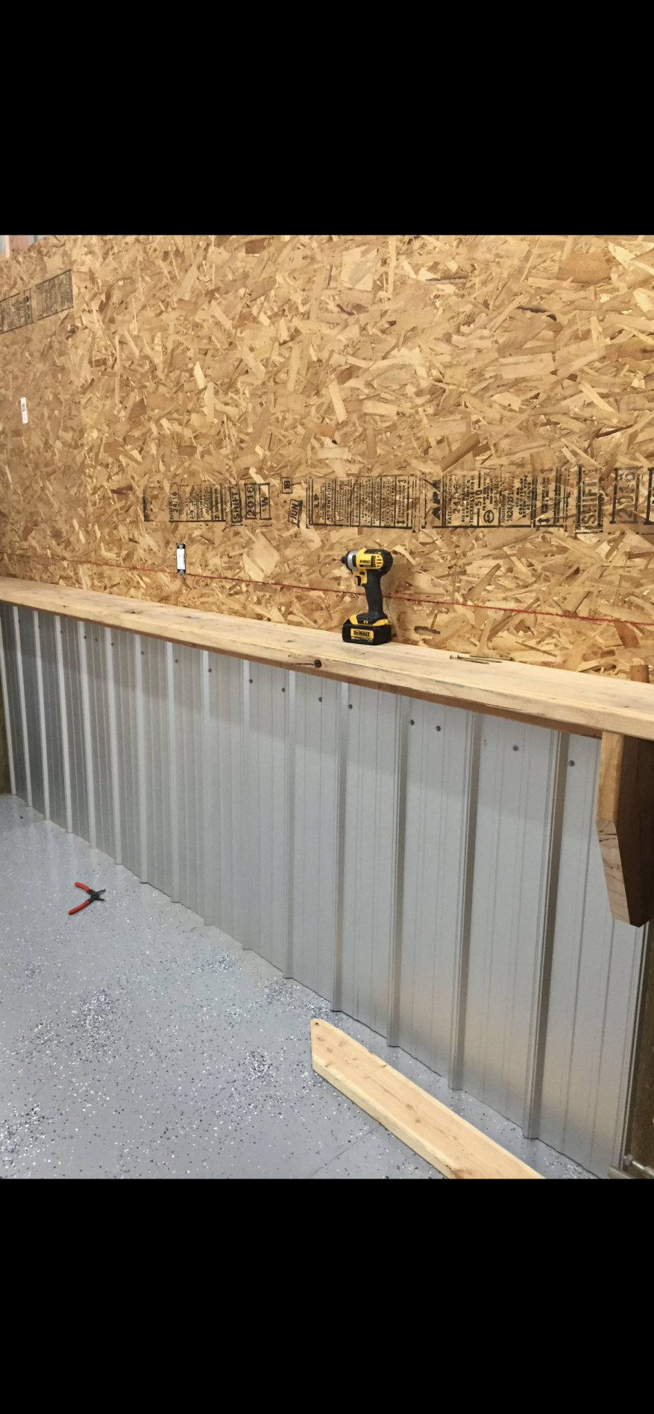

Whatever you build, if you do not make shelves to the floor, only from bar top height up, it will keep the floor totally open, and uncluttered. I put metal 42” up from the floor, then installed a 2x12 all around the inside, and a few thin shelves up from the 42” mark. Nothing gets underfoot.
Yes! That is a great idea. Even better than I was thinking. I really like the 2x12 idea. Would be more than enough to store what I need to.
