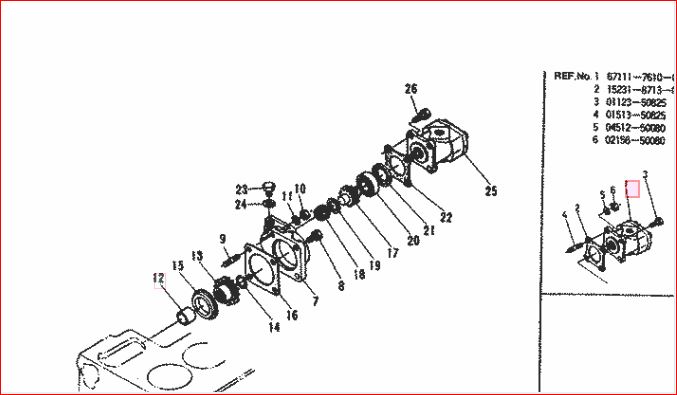

This is the stock pump back on the tractor because it is supposed to rain tomorrow and she is outside. basiclly the in and out ports are opposite. the out is bigger that the in so it make a difference. otherwise it bolts right up.

First where did you get that part #?
If it was from the dealer, then make them take it back as they didn't sell you the right part# or at least didn't tell you there was 2 pump models for the B8200.
Sadly I think I know your problem, there is 2 different pumps, one is a direct drive and one is a geared drive.
Direct drive is 67111-76103
Geared drive is 67810-76100
But just to make sure:
When you line up the bases the same direction the B7100's pump has the large at the top and the small at the bottom right, and when you take and place the base of the new B8200 pump the same direction the small ends up on top and the large at the bottom.
If that's true then yes you have a pump that is driven by a gear case, and yes the gear case reverses direction.
Now all you need to do is get the gear case and parts, I know not the answer you wanted to hear!
this is the route I would go as it will give you the biggest gain, but it's more money.
Another option would be to take the guts out of the other pump and refresh your pump, while not Ideal it would be a salvage and you would get better performance.
The picture on the right is the direct drive pump.

this may be great news!!! i specificly asked for the pump that bolted to the back of the inj pump!!! can you send the diagram for the correct pump? the above diagram is of the actual pump i got, they even sold me that gasket (part 16) for the front of the plate.
they said if i come in today and show them they MIGHT switch it out. so i hope this works.

Hey wolf, any chance for the other diagram? I want to go in the morn and try to get them to exchange this!

I'm an idiot!! You put in your post the small pic has the diagram of the pump I need!
Is it me or does the the little diagram say the pump I need is part # 6711-7610?
There also seems to be a dash next to it. do you have the rest of the diagram or know what the diagram number is? i want to have all my bases covered when i go back in there tomorrow.

ok so they are letting me exchange the pump!!!! not sure what the restocking fee will be yet as they are ordering the new to make sure it will work before we finalize everything.
the pump in the diagram part# 6711-7610-0 is superseded with part# 6711-7610-3, which is the pump wolfman said i needed. just wanted to clear up any confusion for anyone else attempting this.

Am I correct that gear number 13 in this image that wolfman posted:
is driven by gear J in this diagram?
If so, then the gear drive pump is left hand, and the direct drive pump is right hand. Which means that Whitehouse has it backwards.
