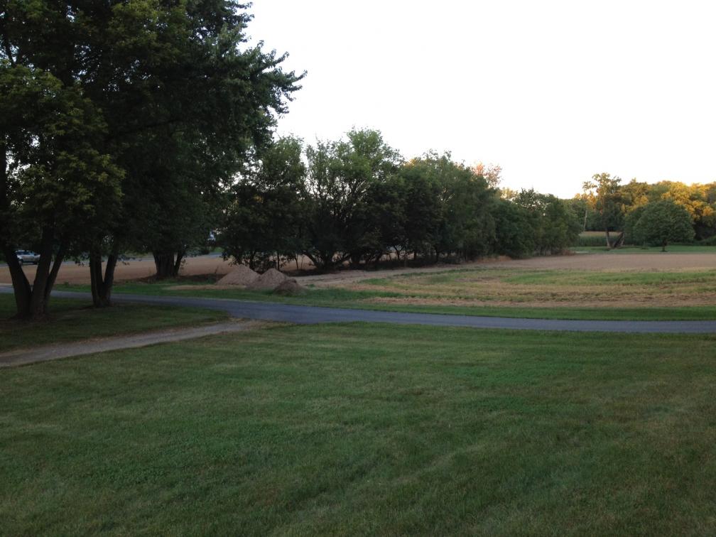

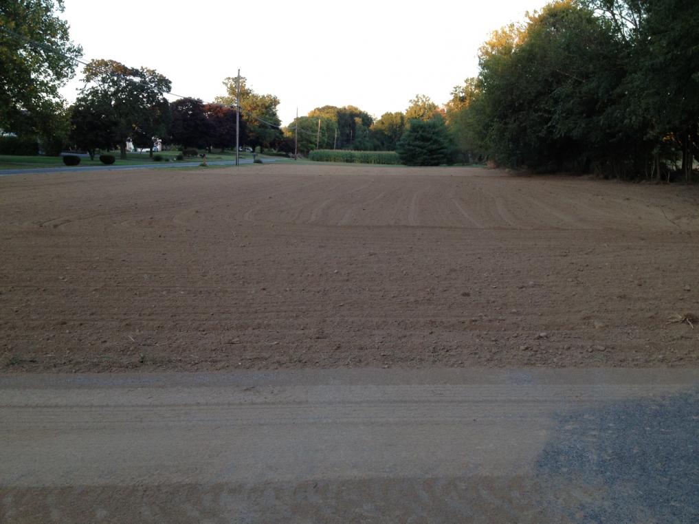

We seeded a bit over an acre to enlarge our yard 5 years ago. First I killed the weeds and then raked the dead stuff, old cornstalk remnants, etc. Then ran the box blade all over it, followed by the landscape rake. I had another drag that is made of a pair of I beams that was used in some spots. The biggest help were the box blade and the landscape rake. When the ground was shaped about right, I set the wheels on the rake so it wasn't dragging hard and the rake was angled. This made gathering and removing the stones easier.
First picture is the south side of the creek. Work on that side was just started in this photo, and the piles are excess topsoil from the north side that I FEL'd to this side of the creek to fill in some low spots.
The other two are fo the north side. This is before the final rake/seed operation. Middle picture is a wider view of the north side, and the last picture is a closer look a the north side.

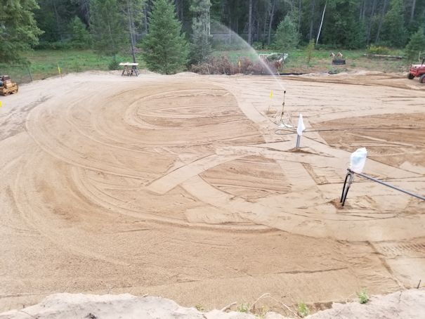

This is the foundation pad for our new house, it was leveled within inches across 100' with a simple land place, they work wonders.

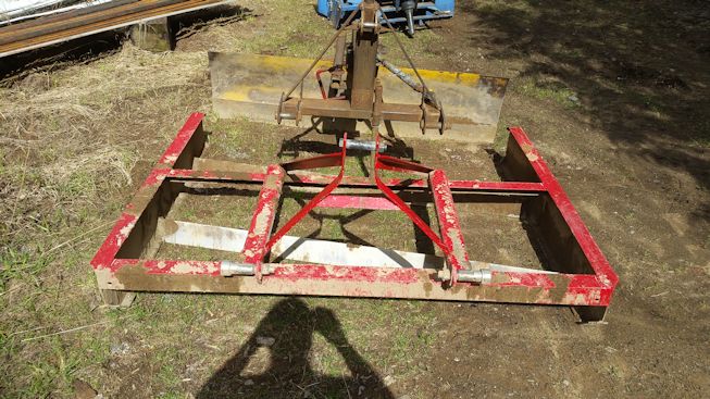

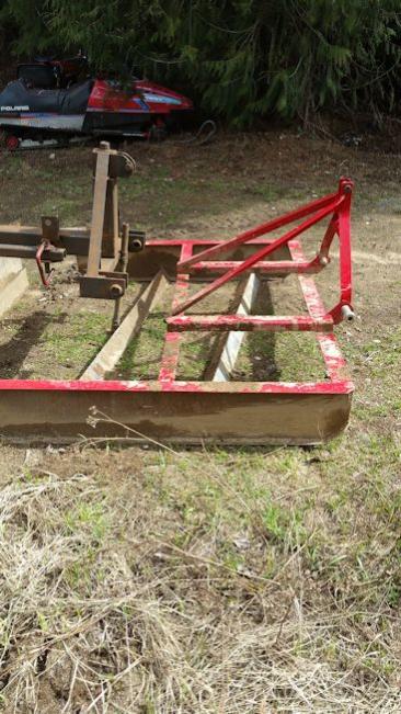

I made this out of some scrap that was hanging around, I beams are from an old small single wide trailer, and the cutting blades are AR 500, in 3 years of use they show no signs of wear.
