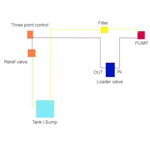

Let me see if I can help clarify what is going on with your tractor.
Yellow lines are Suction
Purple lines are High Pressure
Greens lines are Low pressure returns

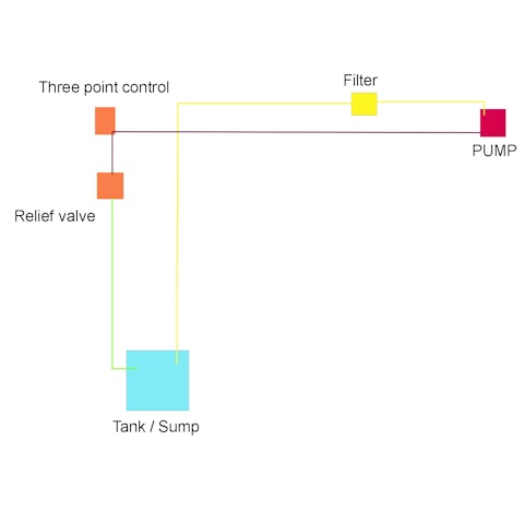

This is a simple hydraulic system with the three point control.
This is if you added a simple loader or any simple spool valve.
This a newer spool valve with power beyond control.

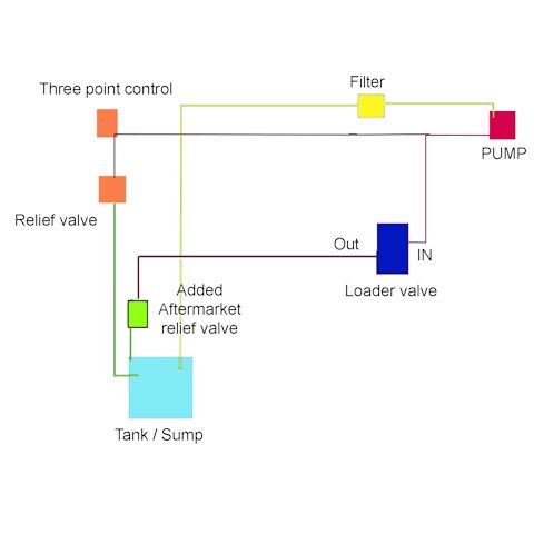

This is the way your tractor is set up right now.
It's not 100% wrong, but it has the inability to be easily maintained or controlled due to having 2 relief valves trying to maintain control of the High pressure circuit.
Your aftermarket relief valve.
Well no wonder things don't work right! If it's trying to force the returning fluid through a relief valve on the way to the tank then that's the restriction in the return line! Returning fluid has to force the relief valve open. It would explain why things work right when he disconnected the return line.
A relief valve should be piped so as to bypass the FEL control if the set pressure is exceeded (ie: pressure side to relief inlet, relief outlet to tank side).
33,916
9,136
No, on kubota's they are an open loop system, all fluid flows thru the pressure relief valves not around them, you need the relief valve as that is how the system builds pressure, otherwise you just have flow with no pressure.
The system you are thinking of is a closed loop system, like an old John Deere system.
The problem with the way his is setup is that they have 2 relief valves in the system and the one with the lower setting wins the battle, so most likely the added aftermarket valve is lower thus sending the flow thru the loader control valve and thru that added relief valve and to the sump thus robbing the flow thru the 3 point control.

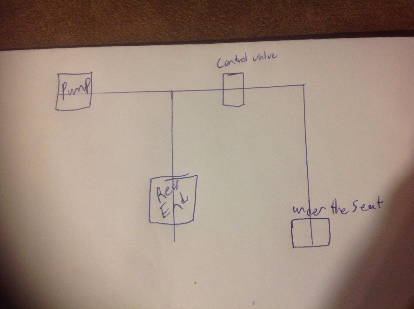

Help me understand this guys, the line coming off of the spool valve is going to a fitting under the seat next to the 3ph speed control valve, as pictured above somewhere. Is this the pressure supply for the 3ph, and it has an internal pressure release valve?
If this is the case isn't that line that goes to the rear end unessesary, and probably the issue?
Can I cap that line and see what happens?
Yes, it does have electric controls on the fender for a cylinder to adjust the "height" of one arm of the 3ph, in other words it can possibly drop one arm lower than the other. At least that's what it looks like.
Also, the fel does not function properly, it picks the boom up at a good speed, and also dumps the bucket at a good speed, but lowers the boom and curls the bucket very slowly, and also does not have a lot of power, it barely picks the tractor up when I drop the bucket against concrete, also I tried picking up some material with it and it wouldn't pick it up or lift the rear end of the tractor off of the ground.
Below is a drawing of what is on my tractor, minus that little pressure valve on the rear end line
33,916
9,136
Ok, now with that drawling makes no since at all!
Are you 100% sure that the control valve for the loader is hooked up like that? :confused:
Take a paint pen and start at the output of the pump and follow the line back, when you hit the tee paint to the valve then go back to the tee and paint it till it gets to the end!
If the Tee does go to the side of the rear end with the AM PRV on it then I'm at a loss to explain why they would have done that!
My Impression: The tee in the line looks like its on the line that goes under the seat to the round fitting with 2 bolts under the seat, which is the input line for the hydraulics to feed the three point control and factory pressure relief valve.
The line on the side of the rear end with the aftermarket pressure relief valve should be the return line the dumps into the rear end.
