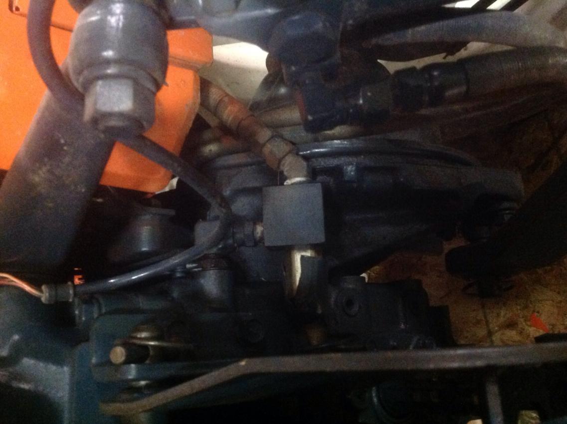

Ok, so this is where the hose on the bottom left of the control valve is going, and where it connects to the tractor its loose, its moving up and down.

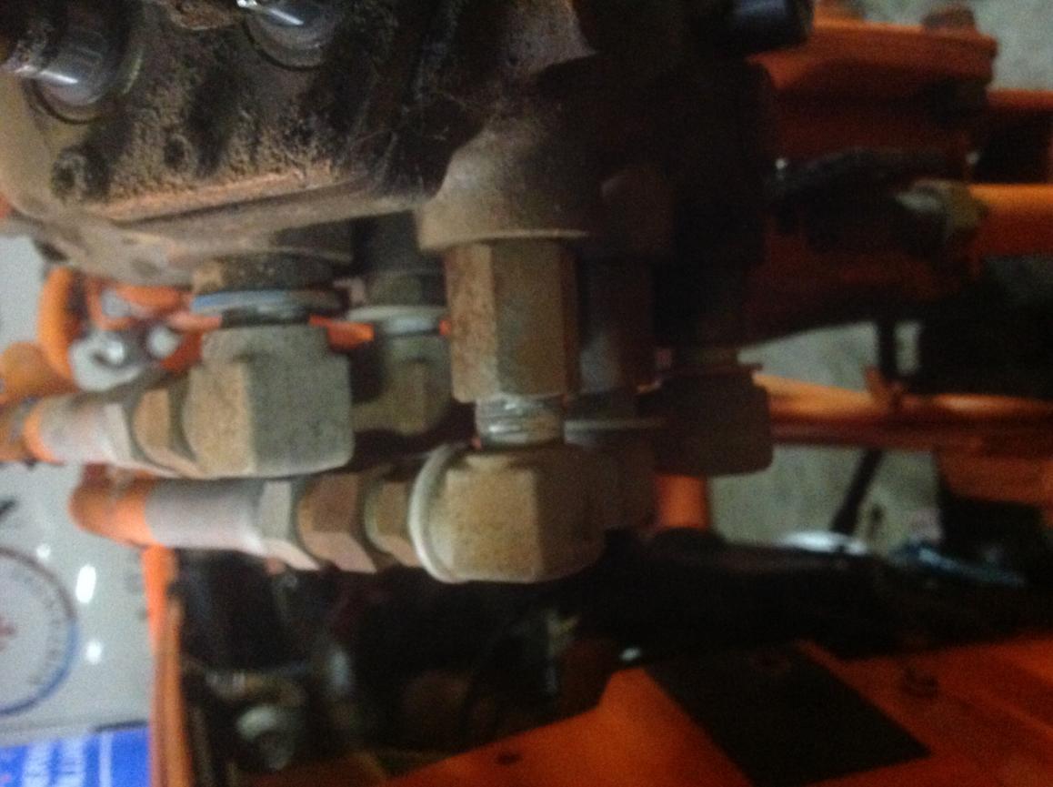

And this is where the hose on the front of the valve goes, into that fitting with the 2 bolts in it under the seat. The tractor is a hinomoto n209, which is the l2550 kubota. So opening the knob under the seat would make the 3 point move faster no?

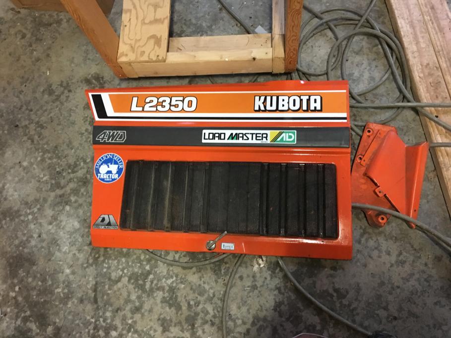

Also: if it is a Hino, I read that Massey-ferguson is where you go for advise/ parts. Do you know anything about that? Thanks again.
33,927
9,144
Re: Grey market FEL on Himomoto
I'm betting it's actually a L2550 or L2350, pictures will confirm that.
It's not uncommon for rebuilders to put the wrong labels on them.
Also if you don't have side panels for the motor and it does turn out to be a L2350 I know where you can get them. ;)

Nope not a Himomoto, it's a L1 26 sunshine, all Kubota.
I have a feeling that some exporter put the Hinomoto label / tag / plate on it to get it shipped here as importing grey market Kubota's is illegal. ;)
