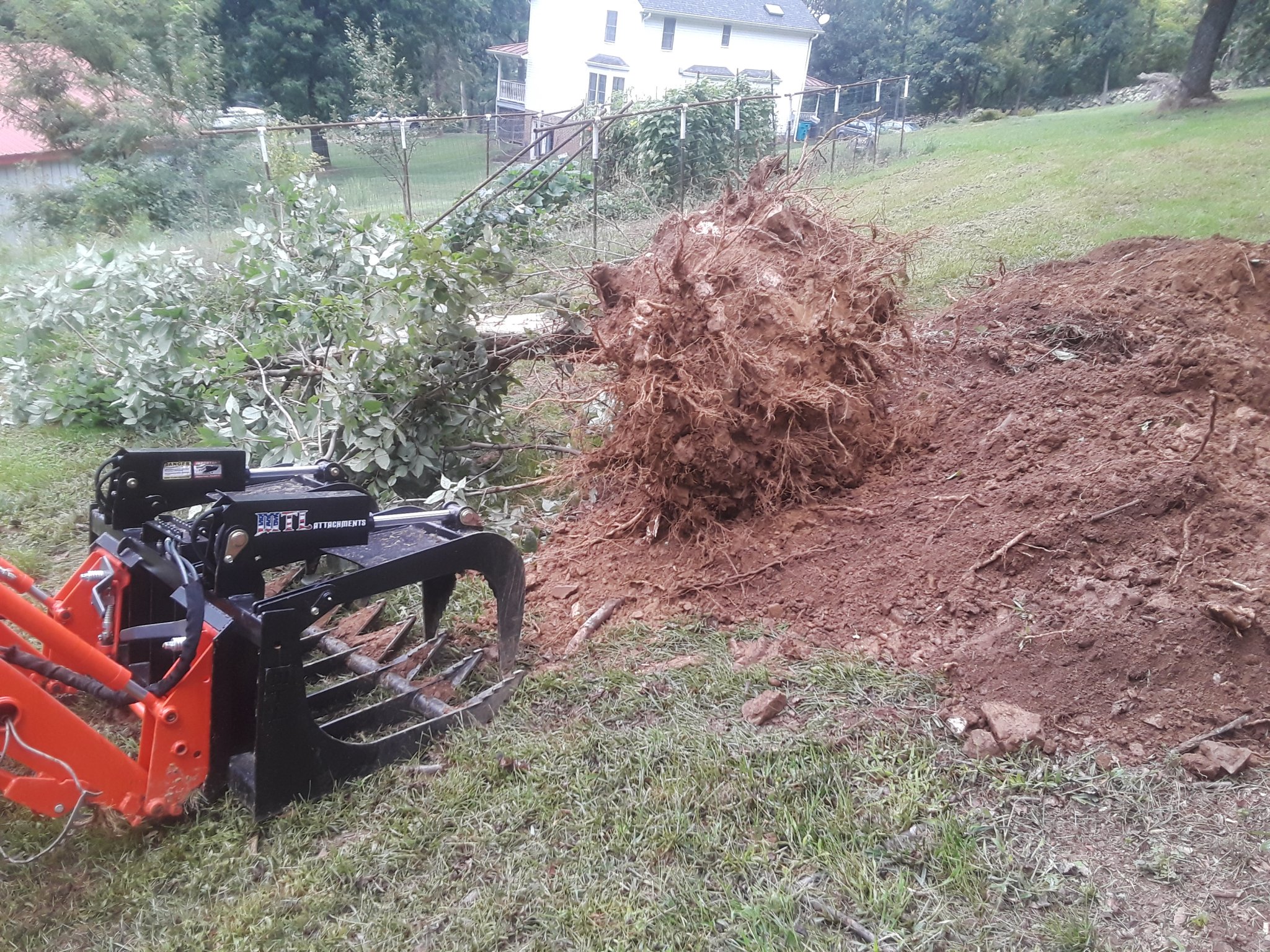

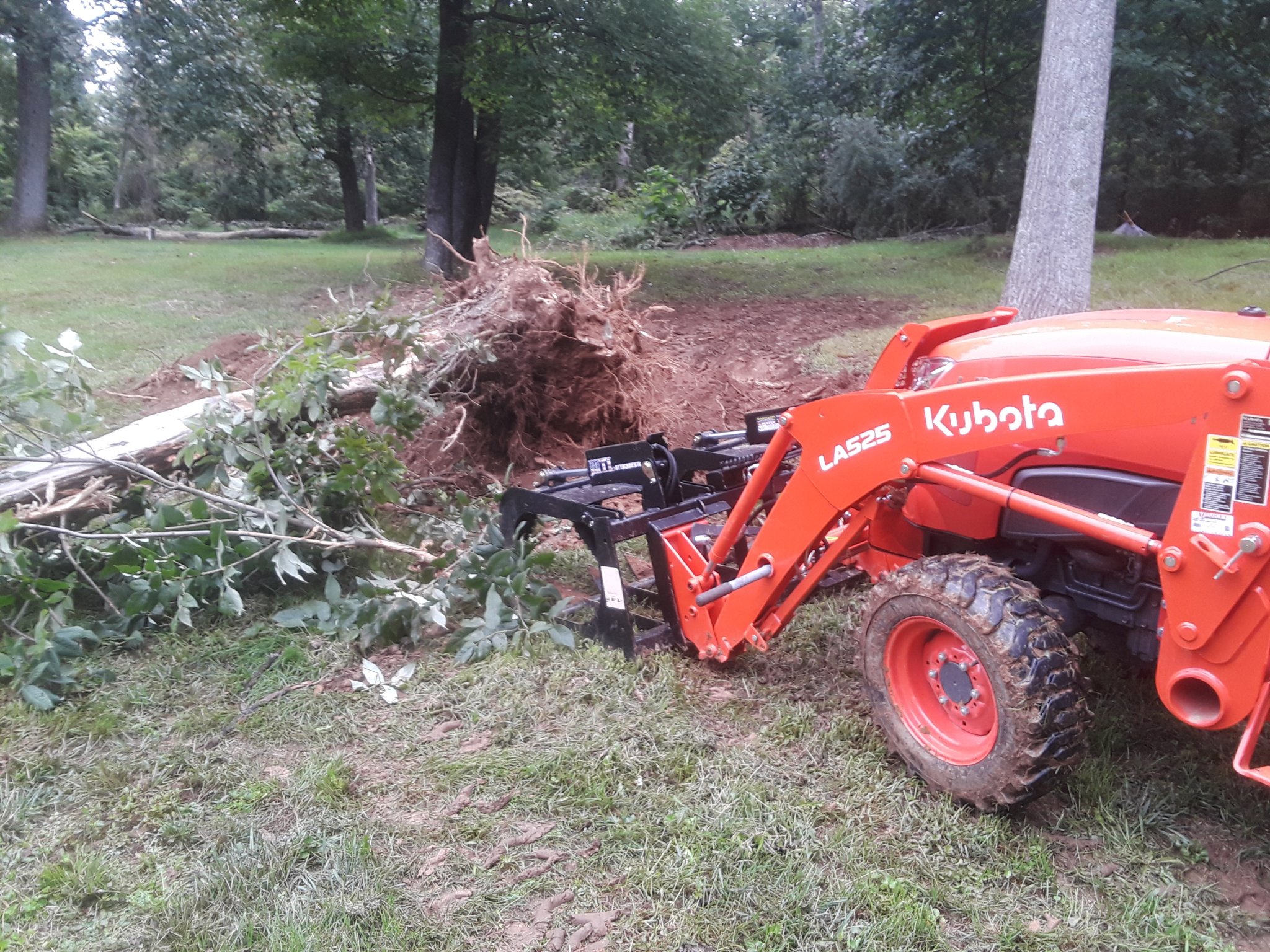

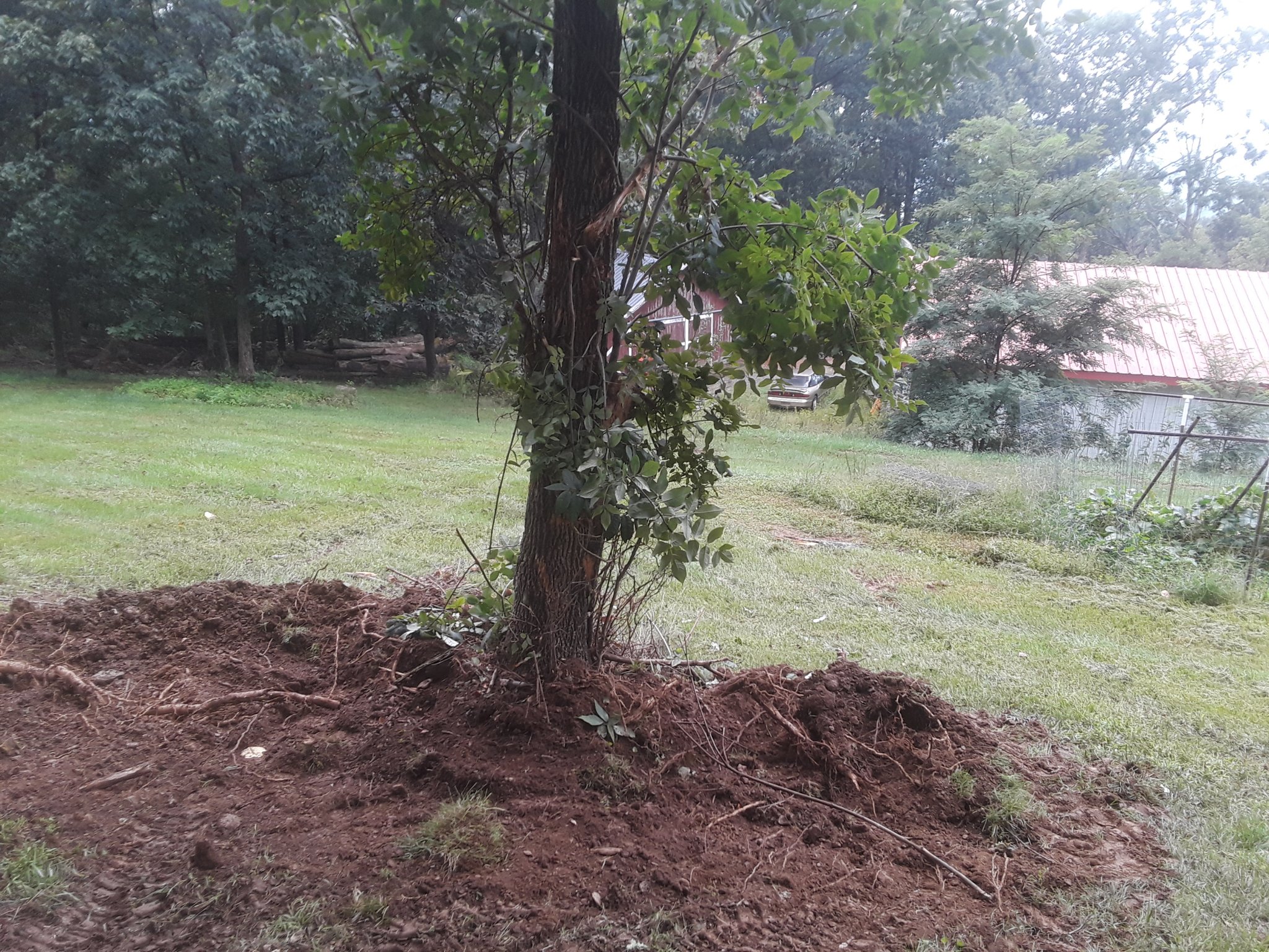

As for the HP rating, where's a video showing the MTL grapple doing anything? Here's a video showing the EA 55" grapple that's only rated for 40hp and lower tractors but here's Ted abusing it on a 60+ hp tractor. Yep, make sure you compare apples to apples and do some digging and see what's actually made in America and not shipped in from China, either partially built or fully assembled.
Sorry not a YouTuber with video equipment so just stills. Also not a little pecan tree and a 35HP rather than 60HP tractor so it took longer and more "abuse" had to be delivered to tractor, loader, grapple, and of course the tree. As you would expect from a quality HD MITUSA grapple it isa little scratched up but otherwise unscathed despite LOTS of heavy pounding. prying, and root ripping. However we had a light rain shower this morning and things were a little greasy. I got trapped nose down in the hole left by the root ball when it finally gave way and couldn't back up. Grapple was raised so I had to "power through" to the down hill side pushing the root ball with the grille guard. Going to need a little panel pounding to straighten Lown's laser cut pride and joy but it did it's job and it also gets my recommendation.
Any further doubts? :rolleyes:
PS> Thanks for the motivation. That wind damaged tree has been a PITA and needed to go but given the degree of difficulty I would not have undertaken it without your encouragement. Timing is perfect for back filling and seeding that spot. One less thing to maneuver around when mowing next year.

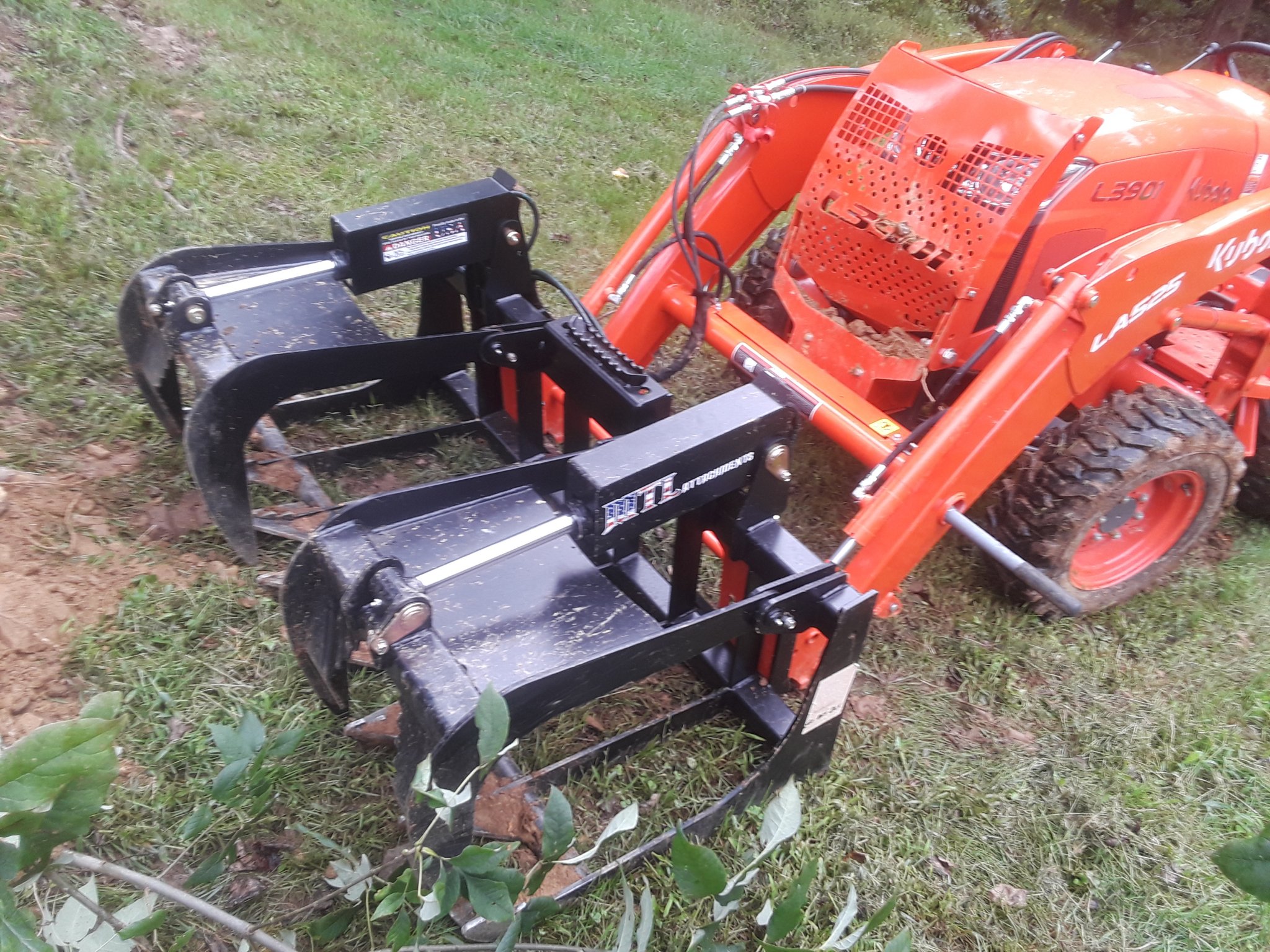

I own a total of 3 grapples for different types and sizes of machines, 2 of them are much bigger and heavier than I would ever think to put on my L series. When I was looking for my L series I wanted something compact and not too heavy.
I was not planning to dig or wrestle tree stumps with this grapple , I just wanted to use my smaller tractor for getting into tight woodland areas to carry out timber and stumps.
I wanted a twin lid as I believe they are superior for clamping uneven loads, I finally settled on a MTL CV-60 grapple (compact vertical design). It works great and was inexpensive. Real weight is under 350 lbs.
Good luck in your search and making a final decision.

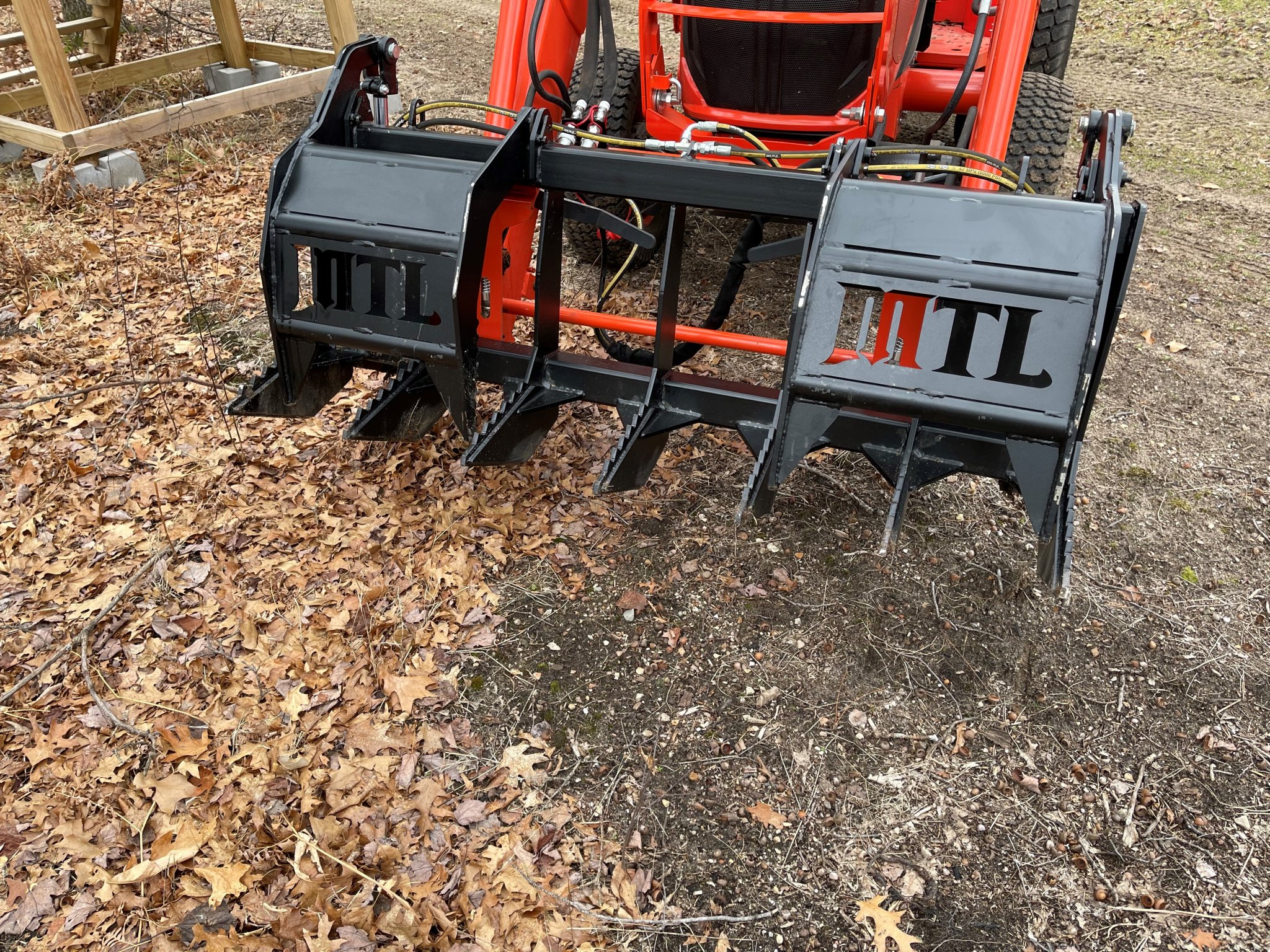

Yesterday was my first time giving my 60" MTL a full workout.
All I can say is " How did I go this long without having a grapple? ". I removed a bank of overgrown / misplaced trees. It was a mess. I went in with a chain saw, let the limbs / trees drop where they may and had grapple power to do all the heavy lifting I use to do by hand or by dragging larger limbs with my tractor.
Plus, I now have a nice, tight burn pile as I can sculpt it with precision placements. I'm going to get a lot of use out of this thing on my farm.
As far as size goes... A 48" would probably do just fine but the extra weight / cost of going up to a 60" was negligible so I see no reason not to go wider.

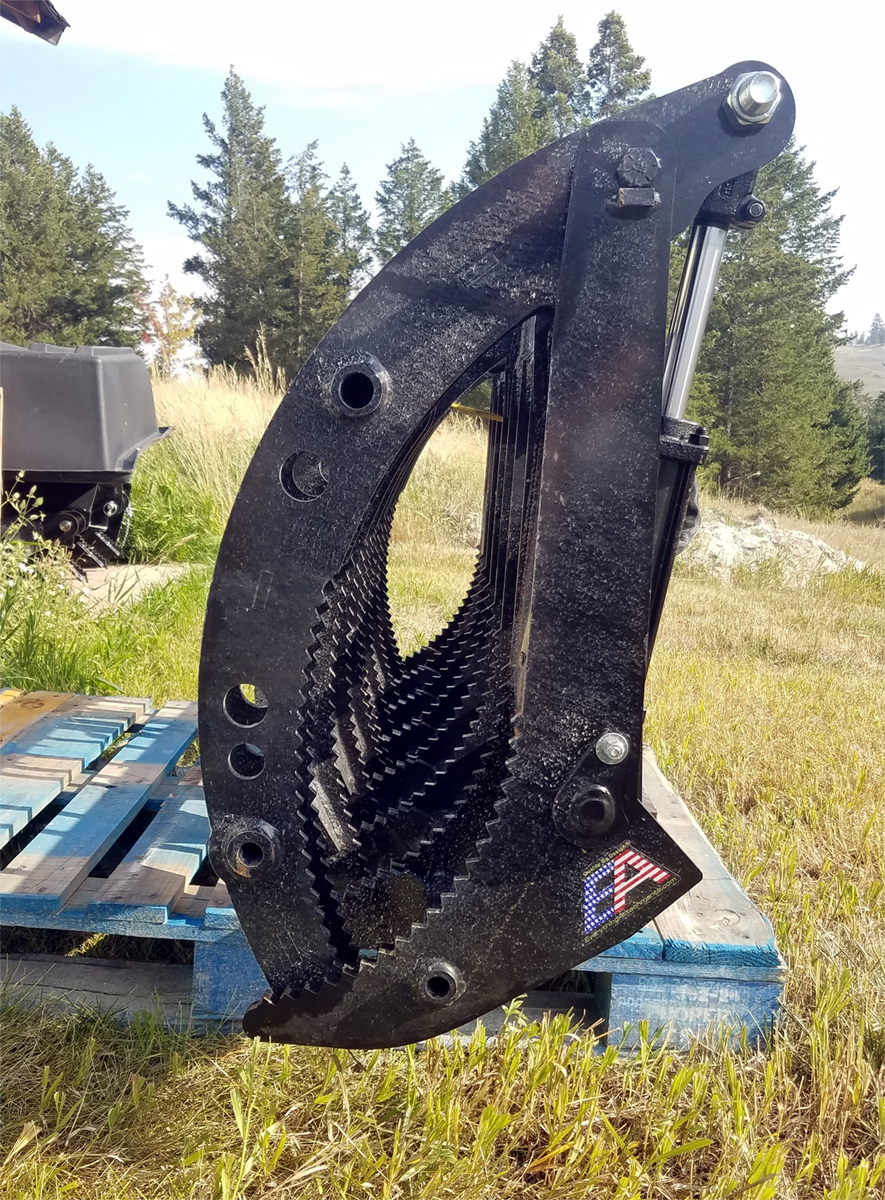

I looked but I don’t like the design. I’m not sure a box design like that would help picking up small brush, seems like it would all just fall out because there’s no pressure keeping everything together in the middle
Yeah, I don't like that design either. Here's the EA Wicked 60 with the rams almost fully extended. There isn't much that will escape the death grip! The jaws open to 40" so it can grab a bunch of stuff. This design reduces the overall length of the tractor compared to having the bucket on the front.
