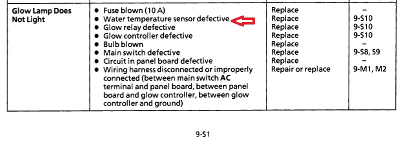

Dave, give him pages 9-M6 to 9-M9

My thanks to Bruce and Dave. The problem appears to be wiring.
Found the poor connection.
