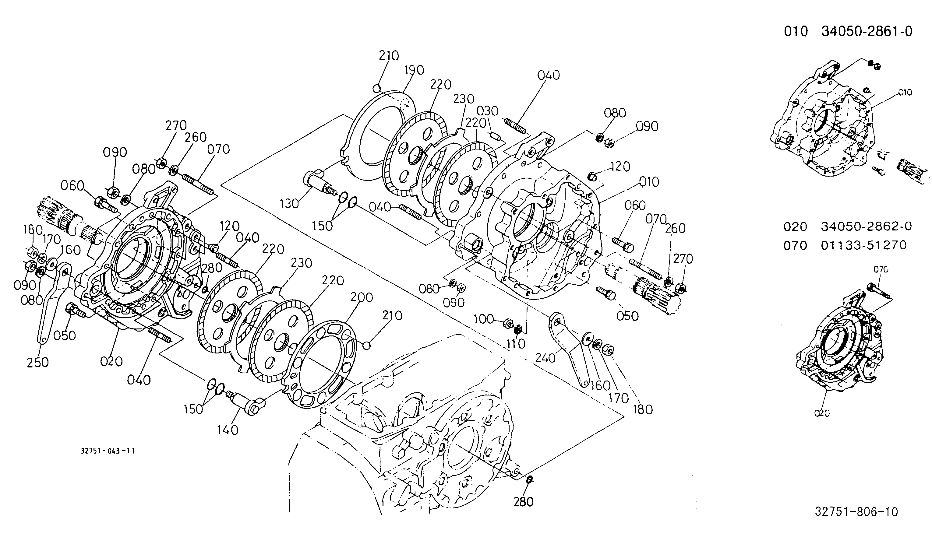

Can anyone decode the part number for the O-rings"?
https://store.germanbliss.com/Home/...m-h24000-hydraulic-pipe-hst-parts@04816-00120
I would like to have the properly sized o-rings on hand when I get it off, cause I'm thinking at least one is "toast".
Edit: I have a "generic" set of replacement O-rings in the shop, but these could be some sort of "special" ones that my kit might not have.
The chance you have the correct o-ring in thst kit is pretty low. I doubt its a "special" but there are a lot of standard possibilties both metric and imperial.
No dealer nearby? Kubota doesnt like to share things like standard o-ring size numbers in their parts manuals or numbering system....

Maybe you've seen this already, but Messicks has this photo below. Looks like PN has changes too.
Another suggestion I've used in the past is to call a parts counter and ask them to measure the thing if they had whatever part it was in stock.
