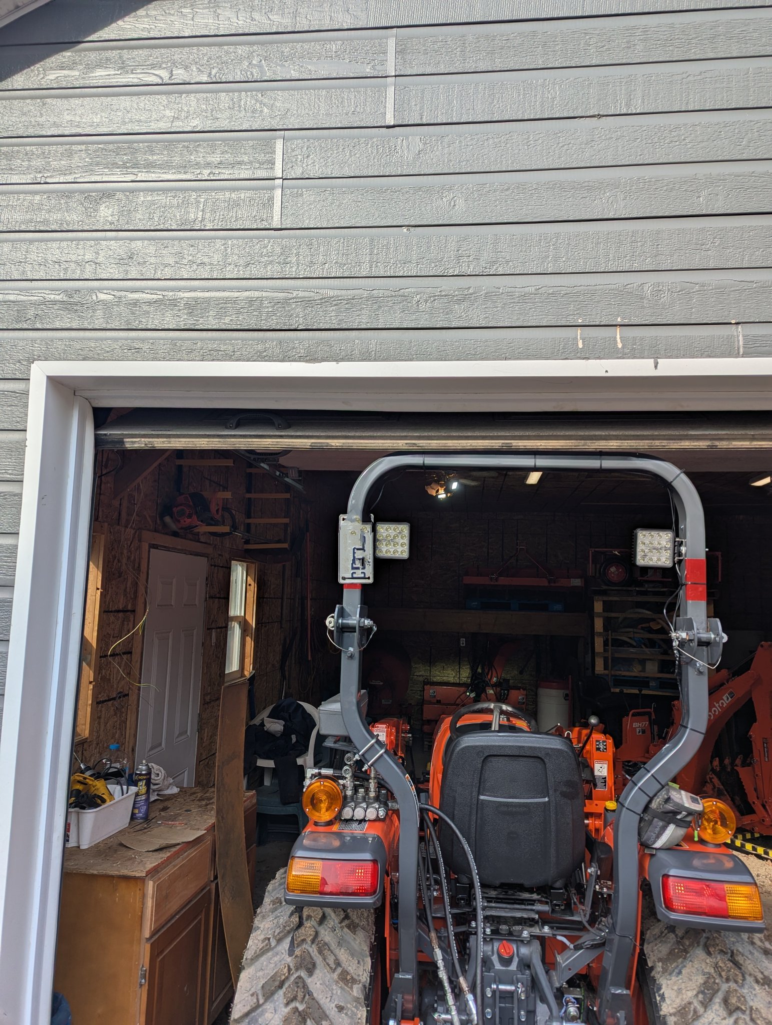

My garage door opening is high enough for my new tractor but the door would need to open up higher.
I can push it higher, so I thought I could have someone stiffen up the spring so it pulls back more on it. But the contractor said he'd need to change the rails. Does that make sense? What is the right solution?

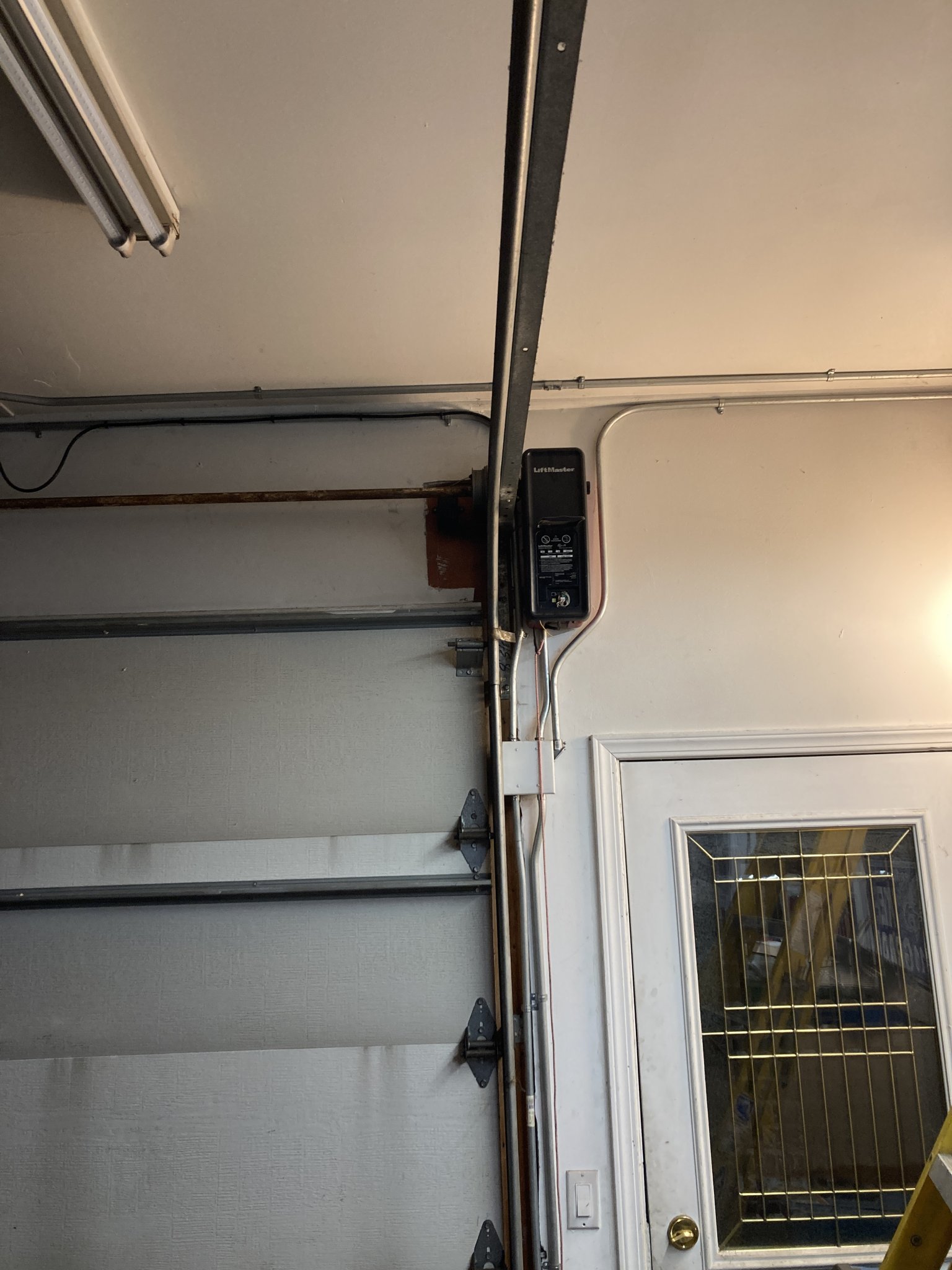

After smashing my door, and knocking it off the track for the 3rd time, I "adjusted" my door opener so that it opened another inch.
I'm not sure if thats "technically" the right thing to do, but it sure beats smashing the door. (y)
EDIT: Although I have a "side mounted' opener like this. Not a "railed" one.

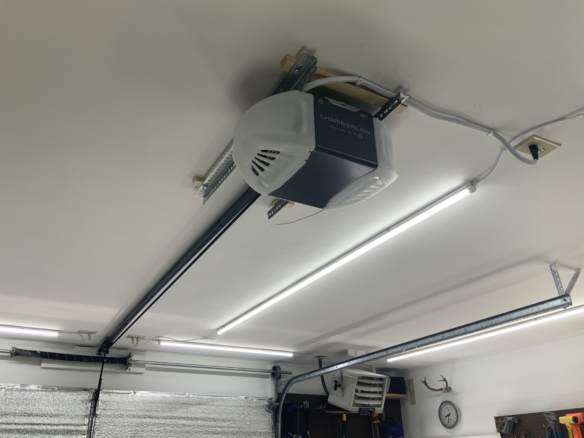

I have adjusted both styles (wall mount and belt drive) of door openers to make the bottom of the door even with the opening. As long as there is enough rail to accommodate the door.
One note about the ceiling hung opener- the bracket that attaches the trolley to the door hangs lower than the door. So if you go with an opener, get the wall mount.

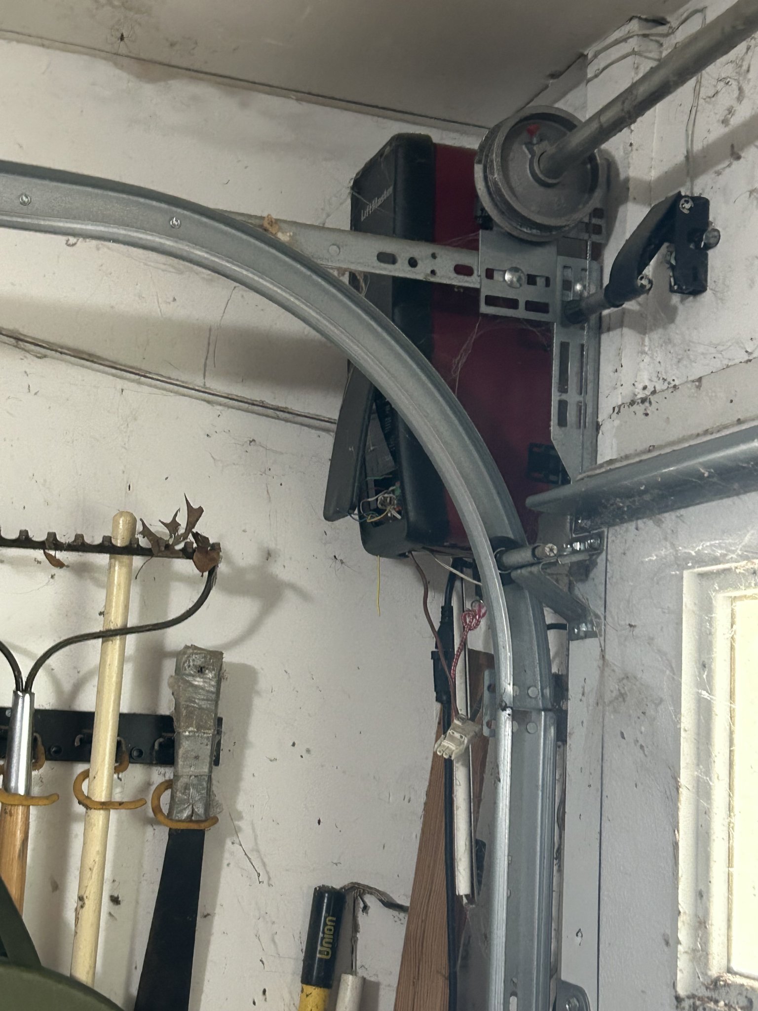

They will probably replace all the rails with slightly taller vertical sections and then the curved sections will be higher and the horizontal sections will be mounted higher also. (but maybe that was what was done for a whole new door that was closer to the ceiling in my case).
Here is a picture of what mine looks like
