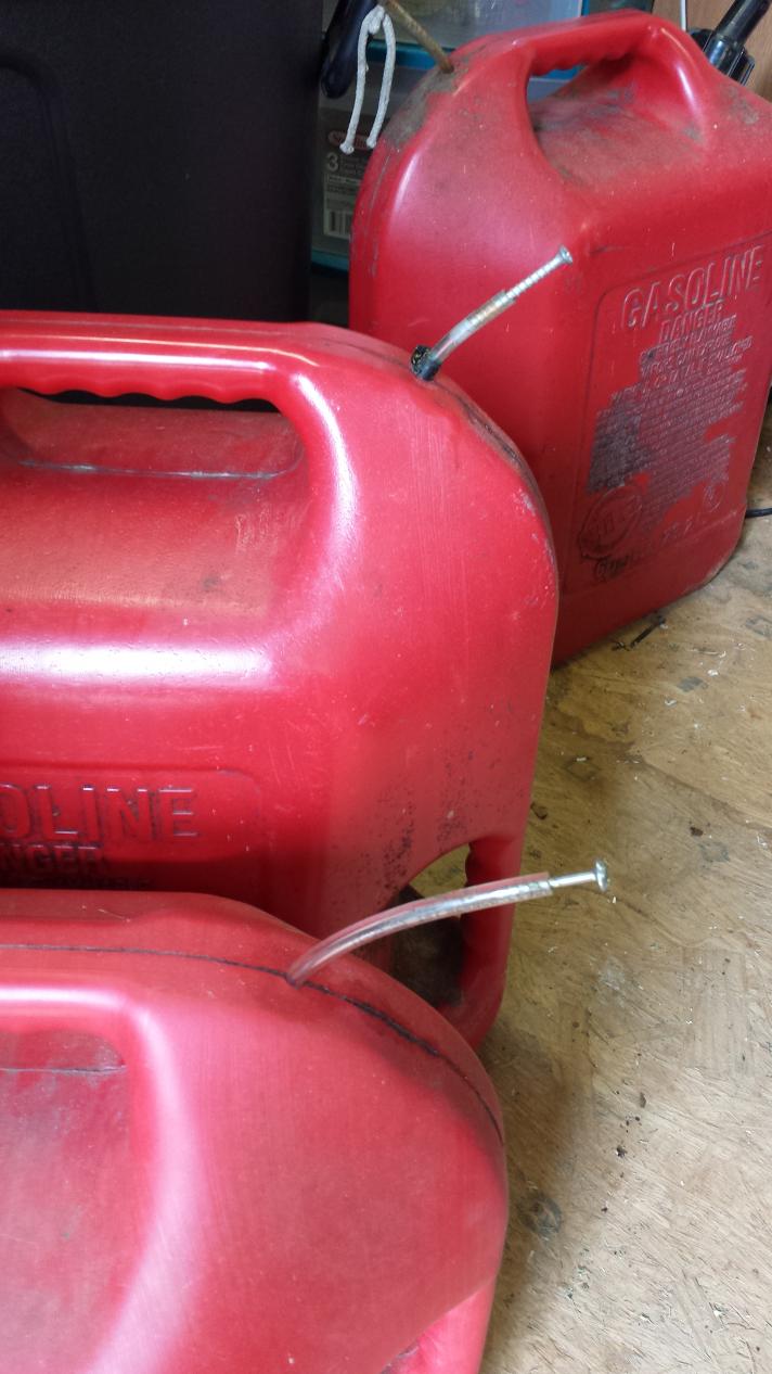

Daren,
for the cost of it, and you cannot find them anymore, that RED container is the lick - I like that can and the bigger version of it, first thing to do is drill a small 1/4 hole in the top - place a piece of 1/4" plastic tubing in the hole allow it to stick in about 3" and out the same. The hose is a tight fit. Place a nail/screw or whatever in the hose. It vents at a rate that is usable , yet does NOT burp and throw gas out either. I have use 3 containers like this for the last ten years.....
the handle on the back is the best part!

I think that this approach is probably the best that I've seen. I've tried many different approaches with dealing with venting these newer containers and most times still get some spillage from the vent because of its low profile and getting the angle right to fill whatever I'm filling. With this method, the extension of the valve stem offers the extra height in venting that a greater tip of the container can be accomplished.
Check out this link: https://www.youtube.com/watch?v=0lcnwdIYEfI
That's my 2½¢ worth of brain activity.
