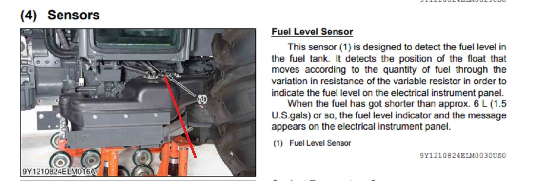

I enlarged this WSM image to help you see where the sensor is located.
First check that a wire has not been pulled off.

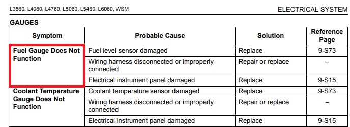

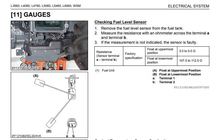

Edit: adding more info
