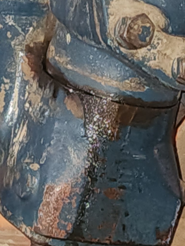

Ok, my back is allowing me to get out there, so cleaned up the mess on the floor and got the tractor up on jack stands. Even tho it appears a lot of fluid had leaked out, now there are still drips running out of this crack....so I assume there is a seal higher up that might be bad. I'm having a hard time reading the schematics to determine what I might need. Barring broken/damaged hard parts, I'd like to have the seals, shims and o rings in hand when I tear it down the rest of the way. 20230217_114201.jpg
N3BP
Sep 20, 2016
510
239
Lebanon, PA
Nope, one seal.... part# 37650-43470 . You have one of the most common leaks know to Kubotas. Dirt and grim get in between the case and cover and help wear it down.

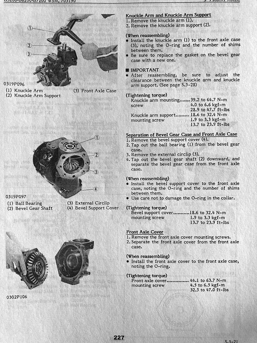

I'm attaching the page from my B7200 WSM. It should be very similar to yours. Pop the steering knuckle off, tap bearing out, remove circlips...etc. If I recall, I had to separate the assembly from the front axle before that seal could be replaced. I know before I replaced one on my L2900, I watched a few youtube tutorial videos. They are always helpful....

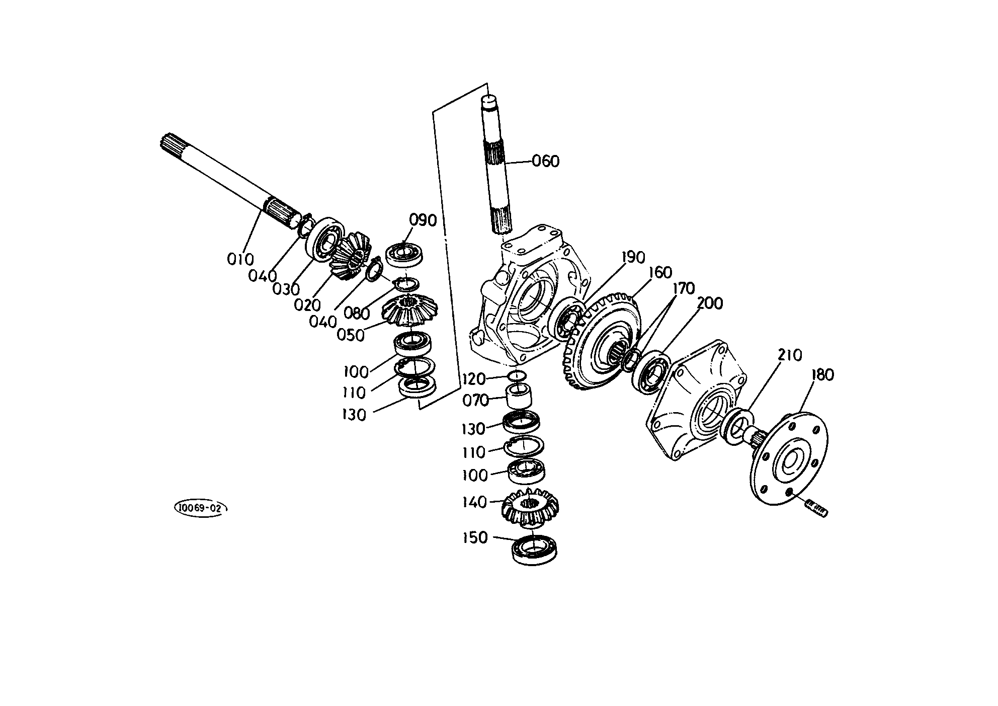

I'm thinking.... remove the front hub/gear stuff...160-180 ,then shaft 060 and gears falls out the bottom ?
I'm not seeing how to get the hub 180 out to be able to remove the cover between 210 and 200.

The hub and bearing come WITH the cover !
170,200, 210,180 as a 'unit'. 170 is the snap ring that keeps it all together.
the 'bull gear' isn't 'attached', it just slides into the splines, may or may not come with the 'unit'.
