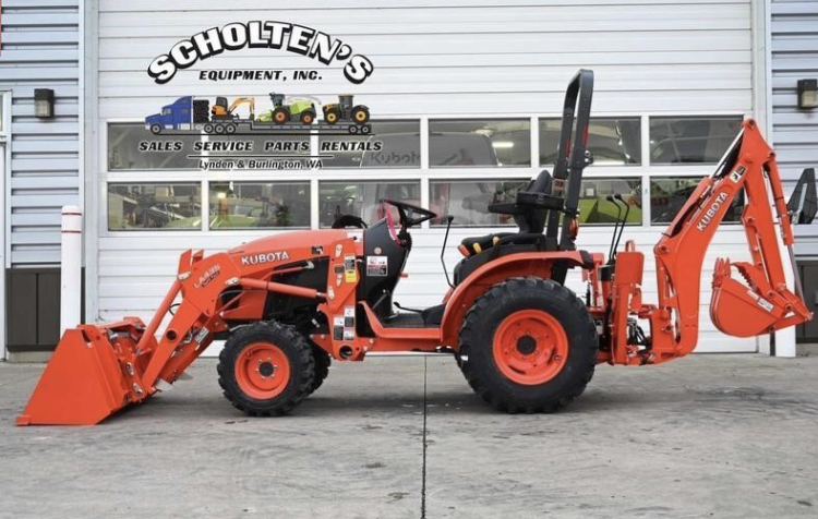

I did a quick search for B2601 for sale. The closest one that came up is in OH, but just from the photos, it definitely looks like something i need to see in person. Like Pail said, it may be the perfect fit for what I need. I saw this new one with a FEL and a BH for $29000. No idea if that’s a good deal or not, but it’s in my budget. MN is pretty far from NJ though. Lol
10,344
7,388
I kicked the tires on a new B2601 last winter. FEL and backhoe. No other options.
Salesman said they were in the $27K "ballpark" at the time. I see this one has a thumb. I didn't get a quote or anything. Just kickin' tires. I think the on-line "Build" for that machine was just shy of $28K, but it was December.
So I think that $29k is in the neighborhood, but a long way away.....

Thanks RCW. I should correct my earlier post as the photo I clipped came form a dealer out in WA! THat's a looooooong way away for sure! lol That said, I have purchased cars and had them shipped across the country, but I'm assuming that probably won't be necessary when I'm ready to pull the trigger. I would just like to go to a dealer and sit on the different models.

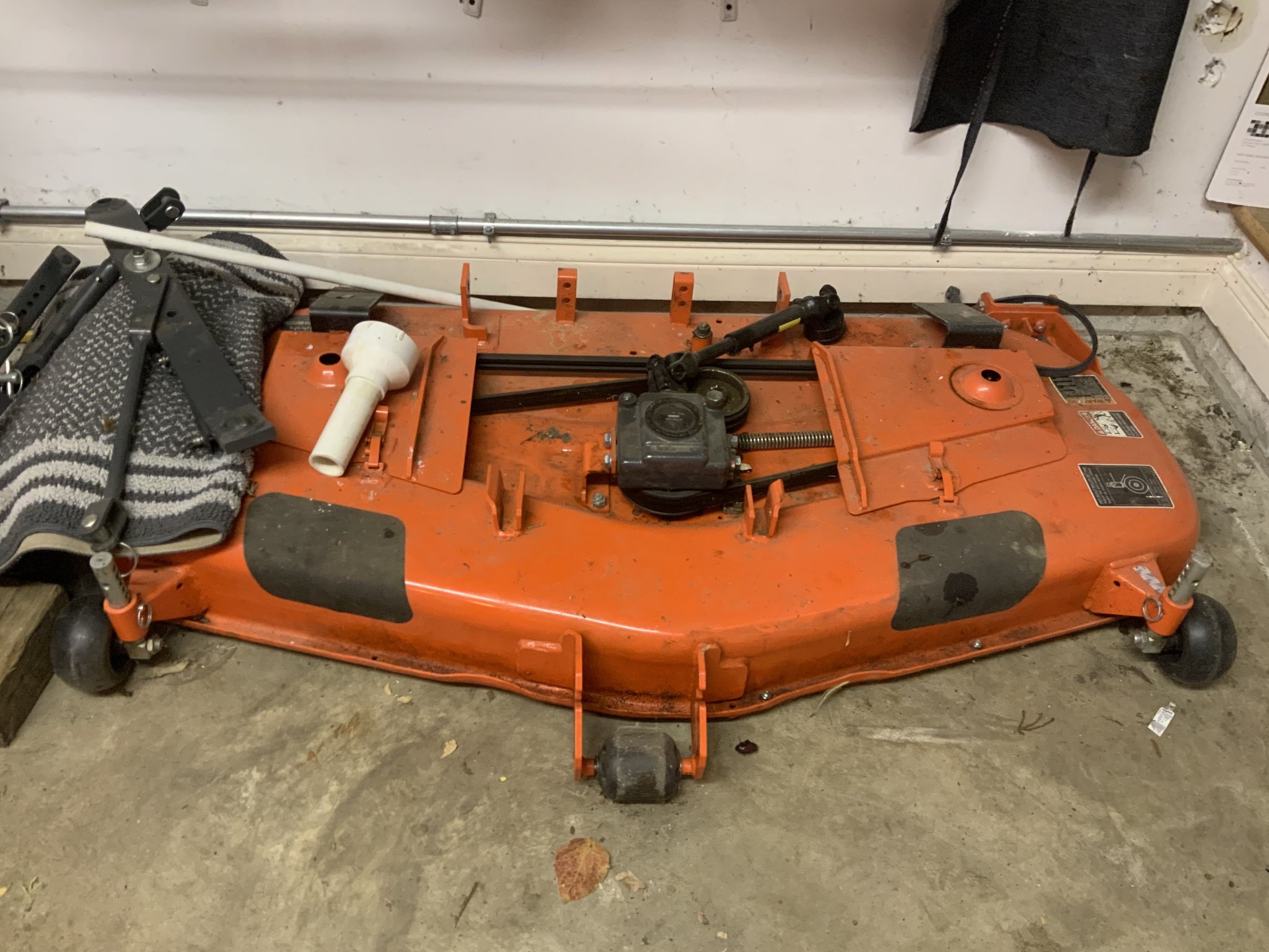

B2601 is a great little tractor. Consider a finish mower as opposed to a belly mower. Just picked up a LandPride FDR1660 finish mowerfor my B2601 and it does a GREAT JOB! I'd skip the Kubota Quick Hitch for whatever you buy and get a Pat's Quick Hitch. I have both and MUCH PREFER the Pat's.
