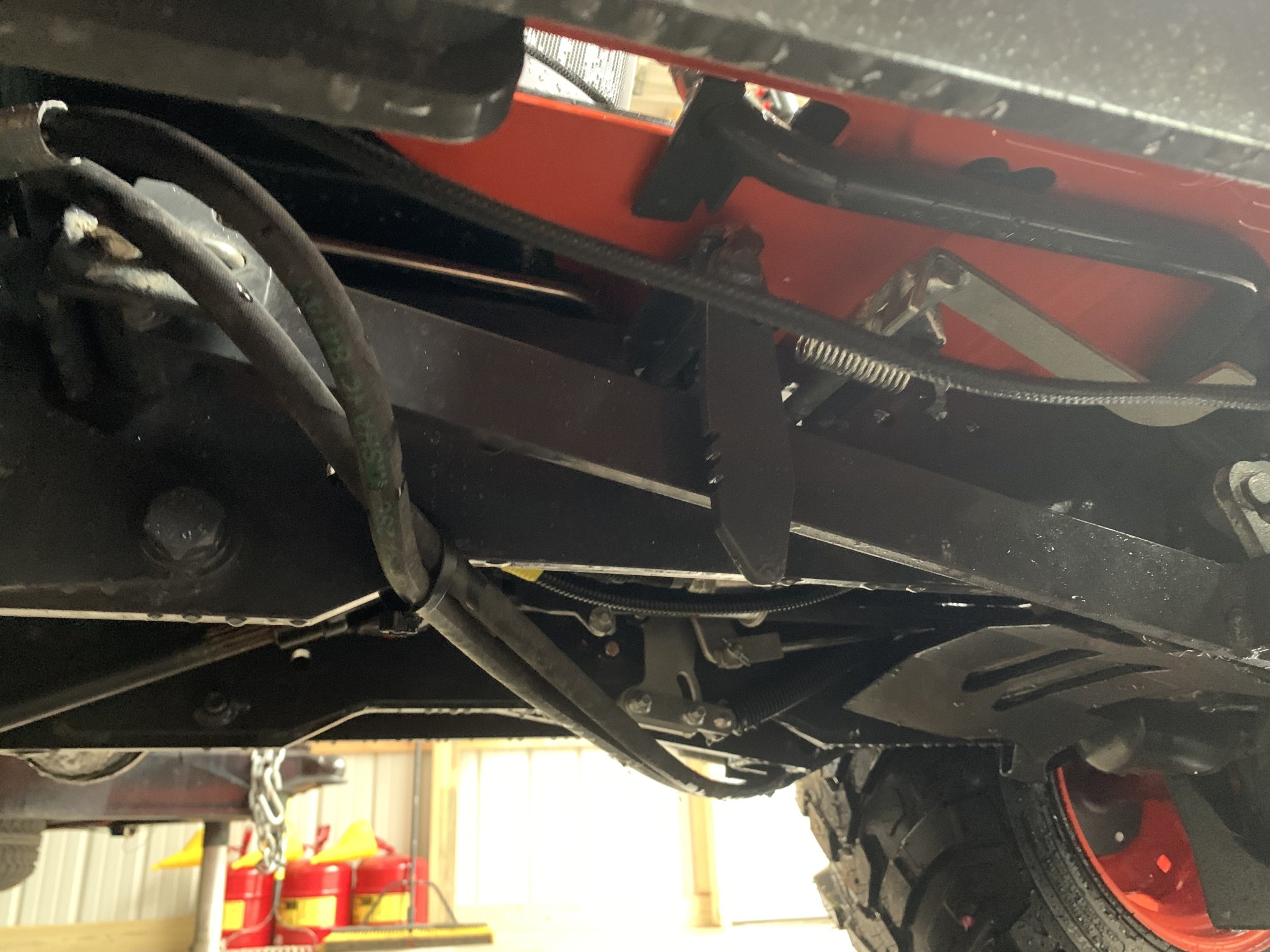

Finally got up to the land. Installed the bxpanded skid plate. Checked fluids and pressures.
Zip tied that abomination of a hose into an "S" shape onto the hard lines. Definitely replacing this line over the 4th.

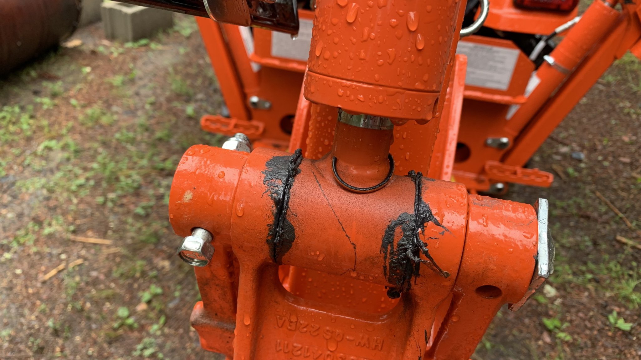

Second, what is this broken o-ring at the end of the piston? Do I need to worry about this?
On various hydraulic piston diagrams its not shown. Looks like painted from the factory, not sure how painting an O ring makes sense, maybe its job is to prevent paint from entering the wiper seal during manufacture?

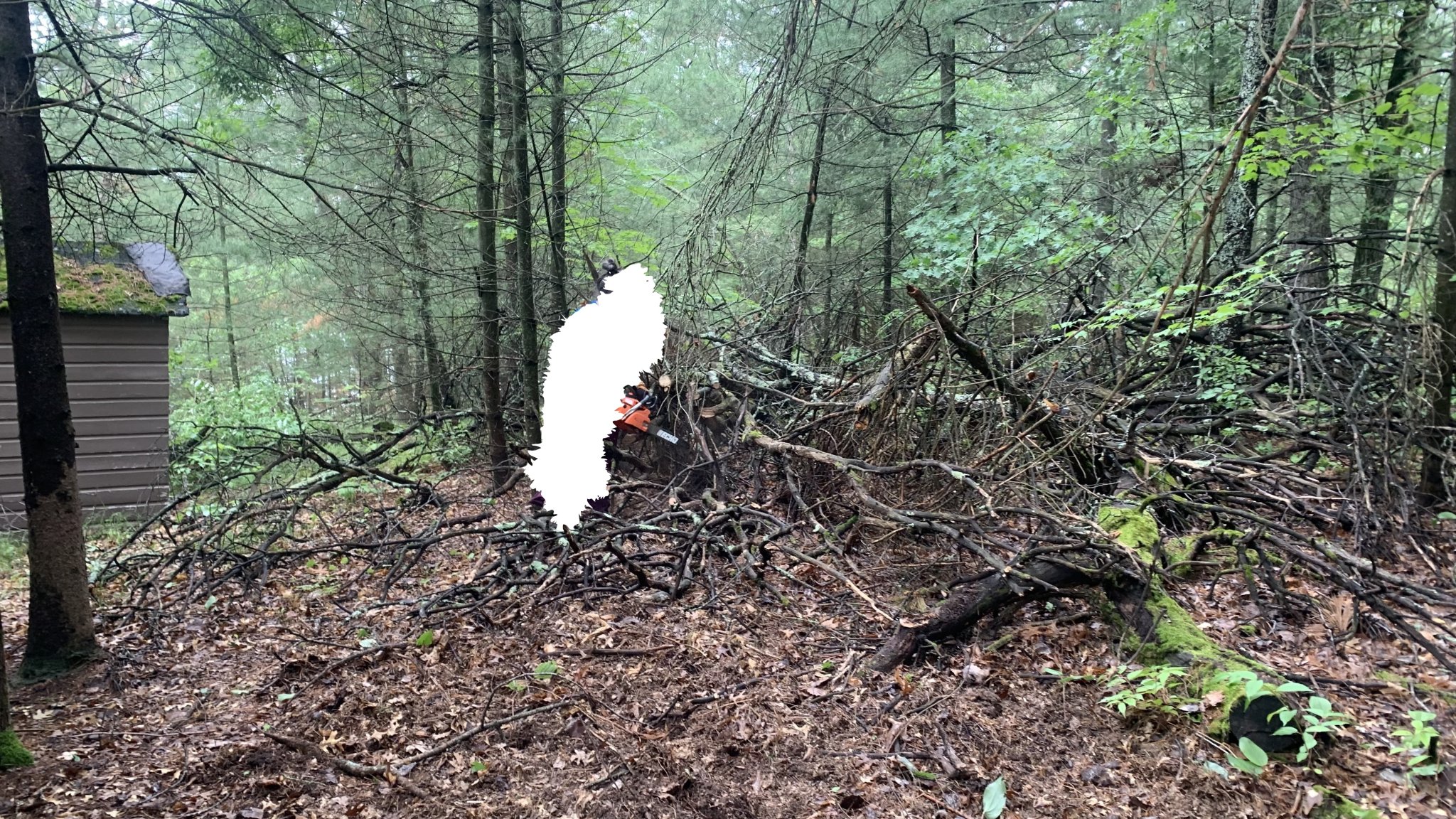

Didn't really get any good pics, too excited to use it. Only got one of a helper cut up a downed tree, grapple was amazing and cleaning this up. Of course I found a big coil of steel wire in the pile immediately, thankfully didn't get it wrapped up on anything.
Diving into brush piles like this, I probably need a front grill guard. They all seem expensive, like twice the price of the bxspanded skid plate for less material. The messicks one seems the cheapest...

oring is JUST a factory painting protector...I still have some on my BX23S
Congrats.
Don't worry about those O-rings. They are used for painting during assembly. They serve absolutely no purpose to you.

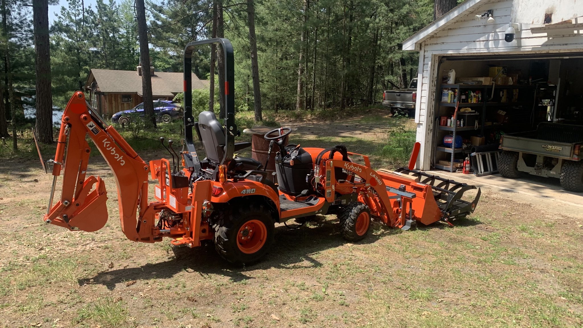

Here is a picture after my tractor was delivered. First problem crap install, second problem I specifically requested the Kubota 3rd function kit not Land Pride. Dealer took the tractor back, and installed the Kubota 3rd function, I was happy as a clam.
Few of my favorite upgrades, Bxpanded under armor, filled rear tires, 2” rear wheel spacers, Bxpanded backhoe dolly, and Bxpanded tool box.
Oof. Is this how the hoses are run with the Kubota kit? What a piss poor setup if it is. Those hoses are ripe for a stick /branch/other object getting caught in them and ripping them down and off. What is it with dealers lately that are doing half ass checks on equipment before delivering it to the new owner?? This is getting ridiculous...
No.That’s how a lazy person with no pride in their work routed them and a dealer with no QC or pride in their work or reputation let it out the door.
It’s also why I installed my own 3rd function kit. It looks stock and everything is routed exactly as it should be. I knew the dealers staff would not have done it correctly regardless of what I paid. Being a professional just mean you get paid to do it, not that you are good at it.

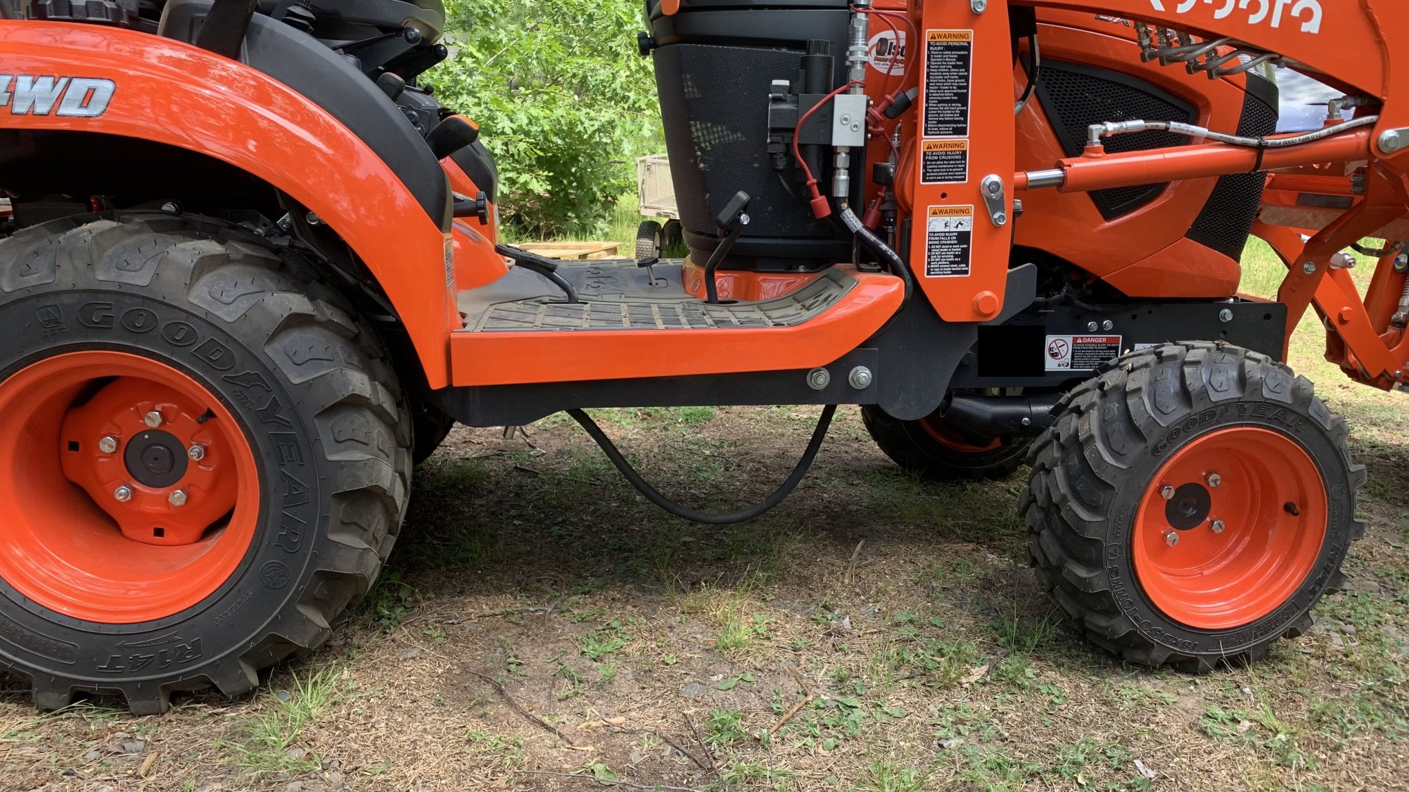

  3. I've got a dangling hydraulic hose the dealer "forgot to zip tie up". Dealer said the Land Pride 3rd function has two hoses in the kit, one just barely long enough and one way too long, and the correct action is to zip tie it up. I suppose that works, but there is a LOT of extra hose. Does this make sense to other people? I guess it does to me, bummer they didn't do a complete job. Pic attached, seeking wisdom.

Below is pic of dangling hose. Not sure how the dealership missed this... Of course I found it immediately after their delivery guy left, not in their parking lot during the walk around.
The Kubota 3rd function is a diverter, so all of the magic happens up on the loader; no hoses from the rear of the tractor. The only thing coming from the rear is a wire that is tucked in beside the loader disconnect.
